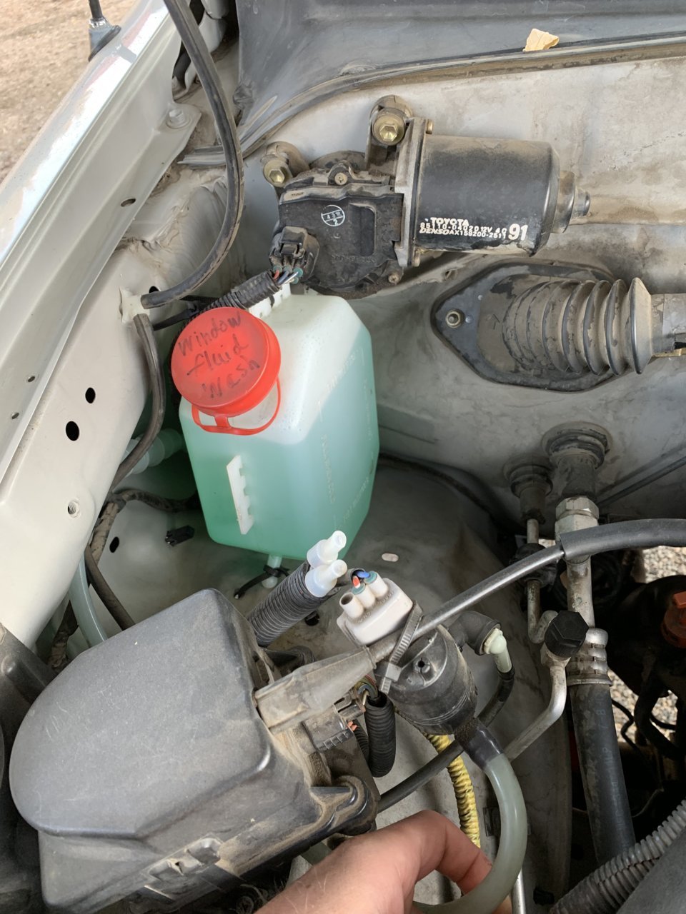

    I repurposed a $12 coolant overflow tank and put it in a different location back by the firewall because I wanted the room for more goodies up front, namely a 2nd auto trans fluid filter. Also got rid of the low fluid sensor and shortened the tubing. Easy fix done a bit differently. You can see where I put the tiny pump. The clear caps are on the low fluid sensor wires to keep the idiot light from turning on, since that sensor is now in my closet.
