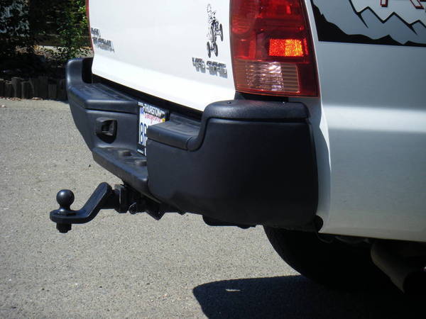

    Well you could always paint it. I painted mine. It was chrome, now black. I used Rustoleum Textured black and I have had it on there about 7 months and it holds up quite well.

    did you sand everything? then spray? i painted my current wheels but i dont know how hard it is to sand chrome. paint doesnt stick well to chrome.

    Ya I sanded mine by hand with 150 grit sand paper then with 220 grit. Then cleaned it with alcohol. Then just painted it outside the temp was about 85 degrees. I did about 4 coats with the spray can then let it dry over nite then installed. Still holding up well.

    try CL..i found a guy that gave me $50 and an OEM black bumper for my chrome one...IMPO it will stand up much better than a sanded/painted chrome one...

    have it powdercoated

    that looks good bro. i can powdercoat but i dont have a big enough blaster or a big enough oven. how much did it cost to send out? also did you buy new plastic or re-use your old plastics?
