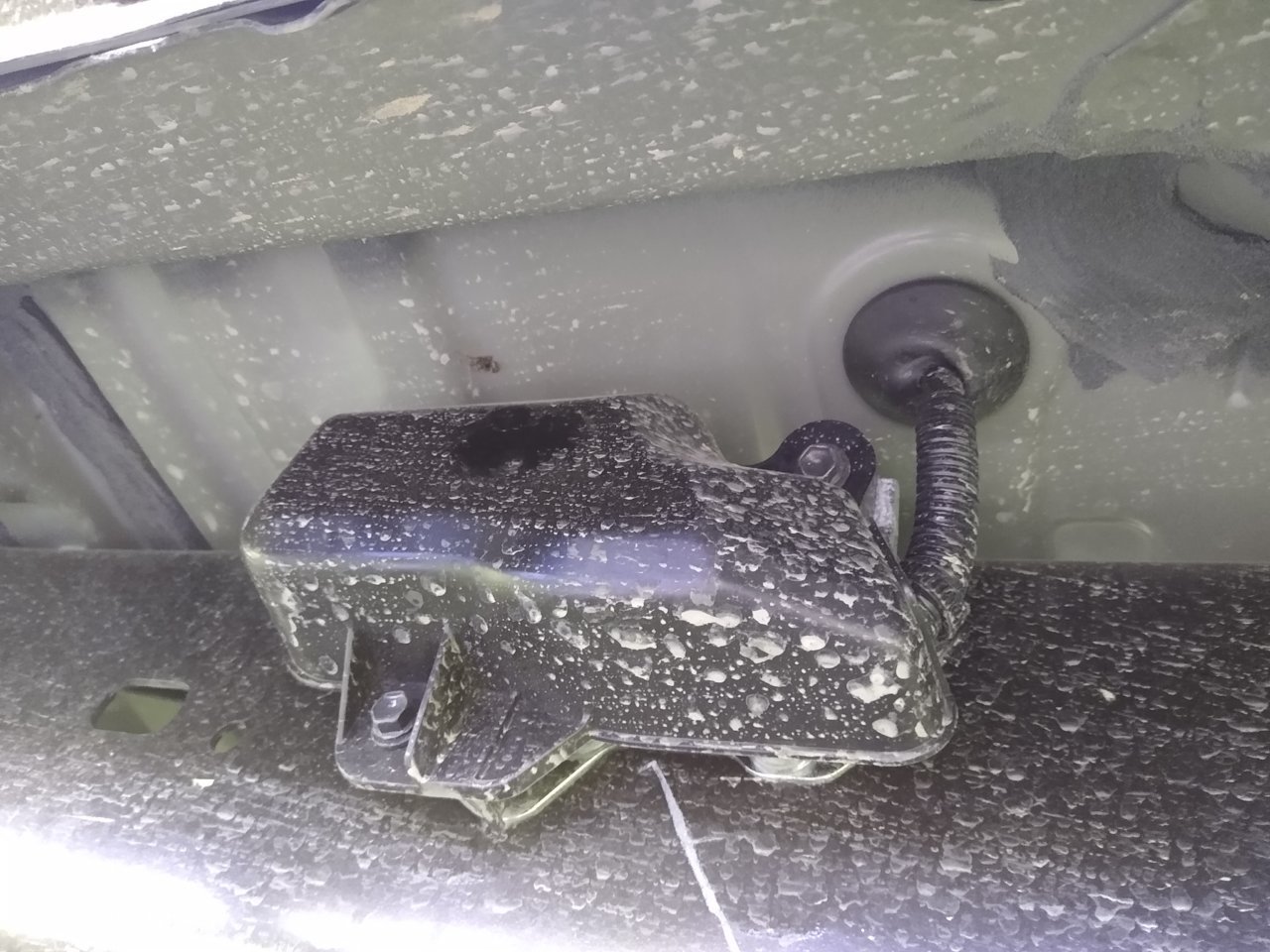

    It’s a cover for a thingamajig.. i took it off once to run cable through that grommet but i dont remember what was there.

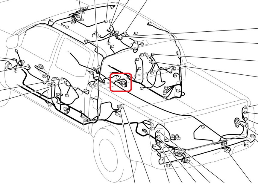

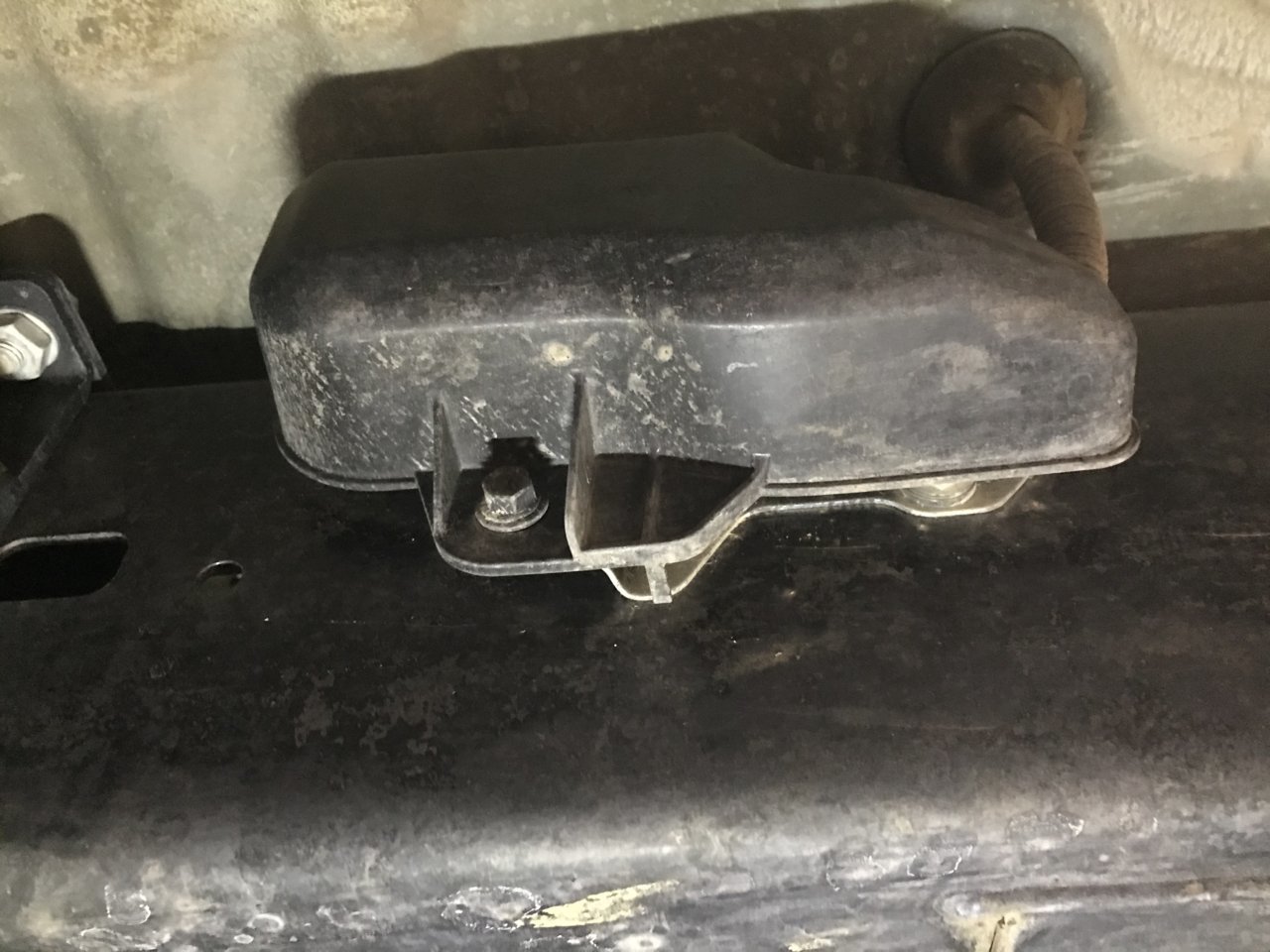

    It covers the waterproof connectors to the rear A/C outlet and the 12v DC supply cable to the inverter.

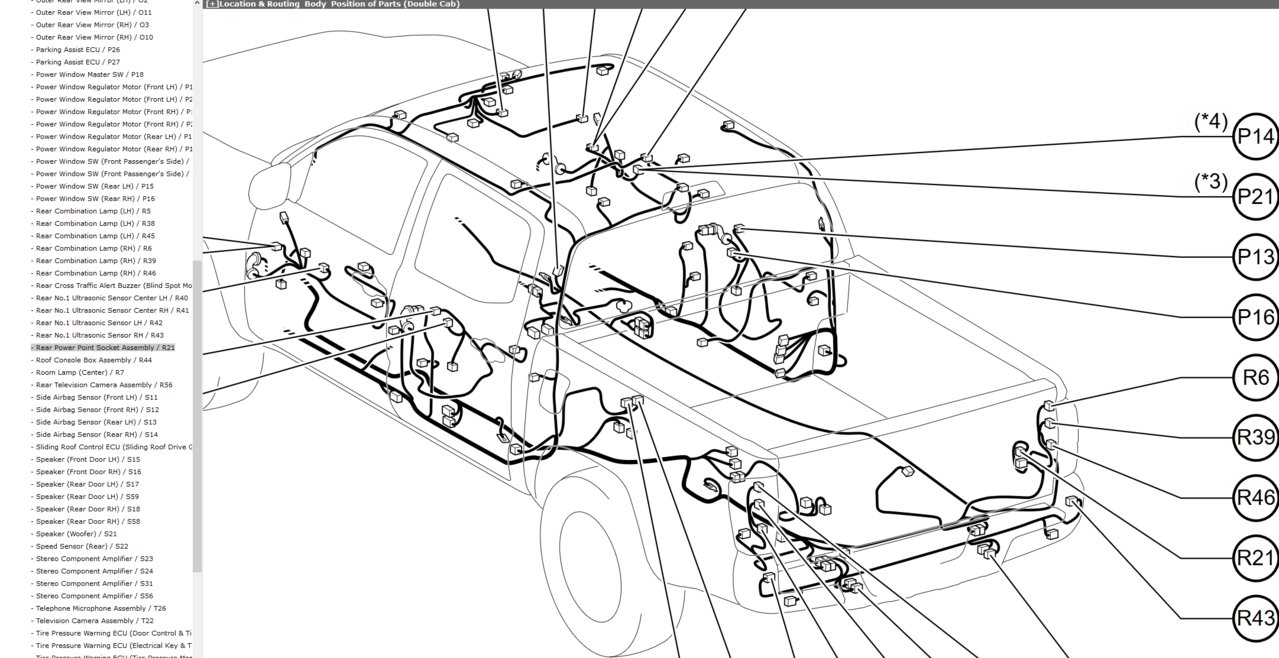

    Blue single wire with BLACK connectors is fuse power to inverter.
    3 wire connector GRAY is harness to rear A/C (alternate current, not air conditioning) outlet.
