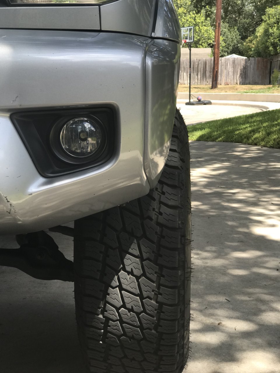

    Here is 8.5 -10 w/285/70/17 so they’ll stick out about 3/8” more, maybe a little bit more gives you and idea. EE4AE649-3321-4E8D-A195-436130F4F39A.jpg

    So they don’t stick out too far. 2mm isn’t gonna make a noteworthy difference. That picture eases my mind, thanks for sharing!

    Correct the 2mm + a 1/4” since they’re a 17x9
