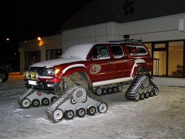

    I would definitely get into a 4x4, as capable as your 2wd has been for you all this time, you'll have a whole new world of locations and terrain to explore with 4wd. And there really is no substitute for 4wd on the snow/ice. Except maybe these

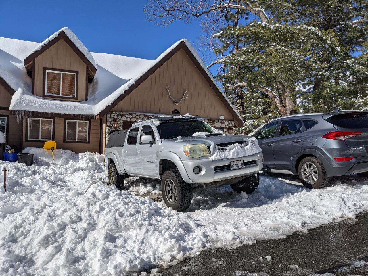

    if anyone's interested... here's the most recent photo: this morning in Lake Arrowhead after an hour of two dudes shoveling the front of the driveway. It was beautiful, but not ideal to be driving home. But we made it safely.

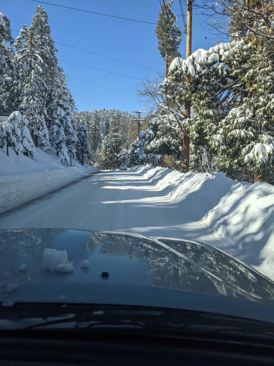

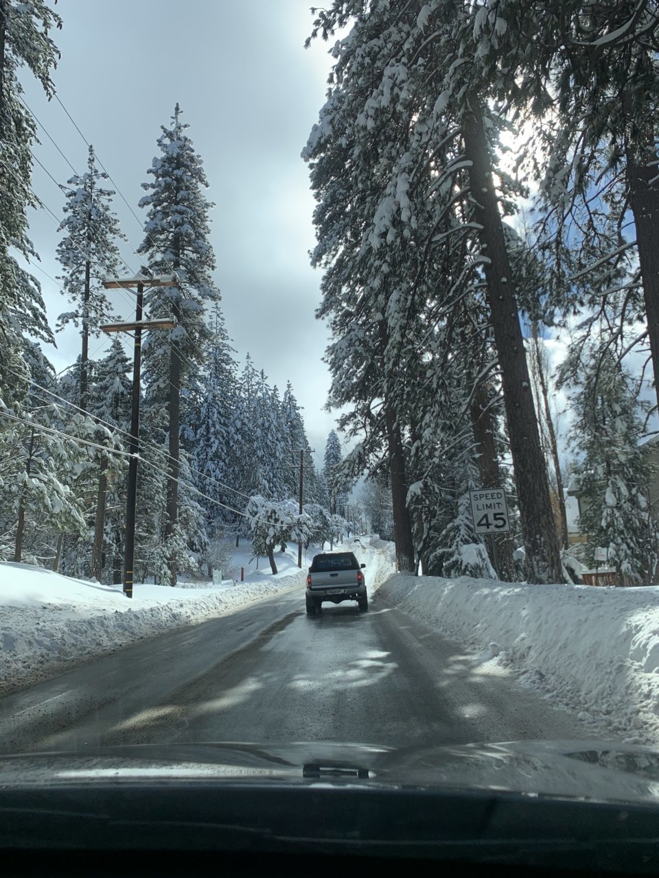

    Yes at3 4s. Like them a lot. Done some easy dirt trails and no issues. I made it through some nasty roads on the way home today. Felt it slipping it wasn't fun. A few days ago was worse. Chains on both days. But yes, great tires. I think it would've been worse with other tires. They quickly regained traction. I just wasn't stoked.
    Yes weight in the bed helps immensely. But we didn't have any extra room to add weight. Family of four and dog equals a lot of crap in the bed. Beer cooler was empty
    This was today's drive from arrowhead down the mountain .

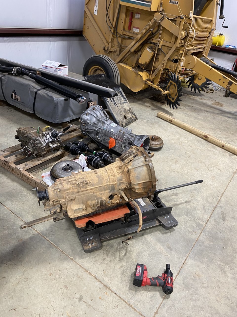

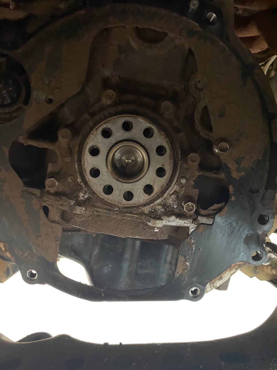

    basically how it goes, definitely want to source all your parts and have them before hand and not wait till things come in. Taking the transmission out definitely is a 2 person job. I did it by myself and it took like 5-6 hours and put it back in with an extra hand and took like half that haha. Also a good time to change rear main seal. I did that. Man I had no idea how dirty my tranny was with mud caked up in there. It really surprised me.
