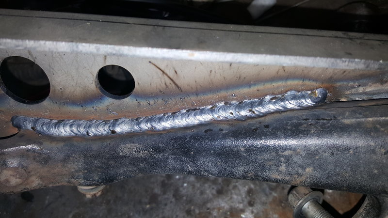

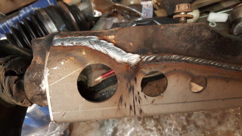

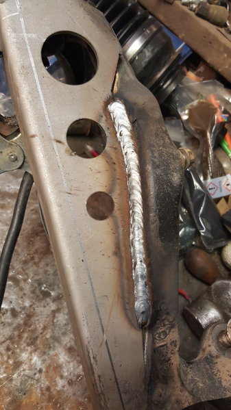

    Welding porn. Mig at 11:30pm after 13hrs of wrenching.

    All 3rd gen stuff is the same. It's the same truck mechanically in most ways. Just cosmetic changes.
    Hope you pre heated those spindles. Or they could warp or crack later.

    Spindle gussets :rolleyes:

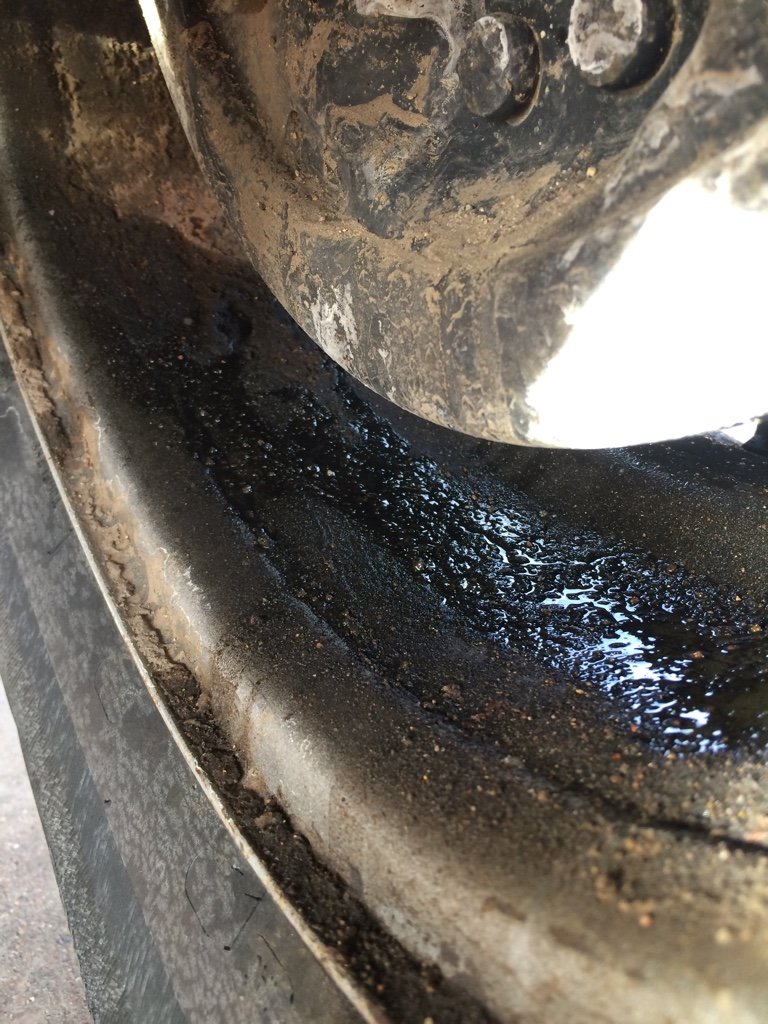

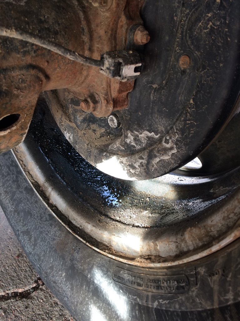

    I was checking my tire pressure today and smelt something funny around the passenger rear tire. Looked at the inside of the wheel and saw this puddle of liquid. It was a greenish yellow color and smelt. The only other wet spot around was on the bottom of the drum.

    It can only be a couple of things. Gear oil is definitely not greenish-yellow. But gear oil is stinky.
    Brake fluid is yellowish and does not have a strong smell like gear oil but still has an odor.
    How does your brake fluid reservoir look. Is it low?
