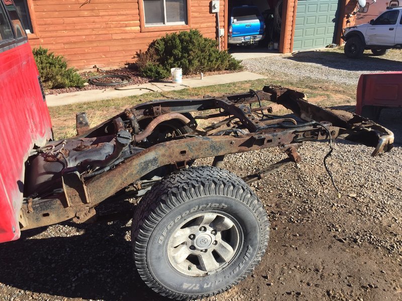

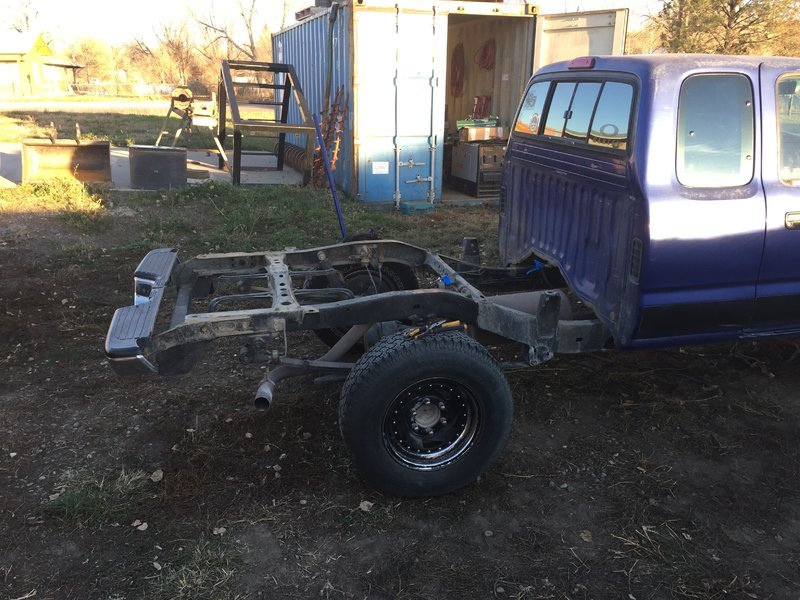

    Decided to go for it since I had a frame to fix it.

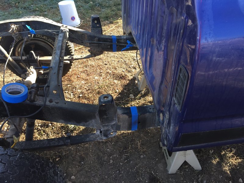

    Yeah it's the same from the behind the cab. There is a rectangular hole in the frame that I'm cutting down the center of that I will use to make sure it's welded back in the same spot. Then we are going to put plate on the outside over that seam to make that it's not weak in that spot. Going good so far. Really not a lot to disconnect since we are just going to use everything on purple frame. Driveline, gas tank, brake lines and exhaust
