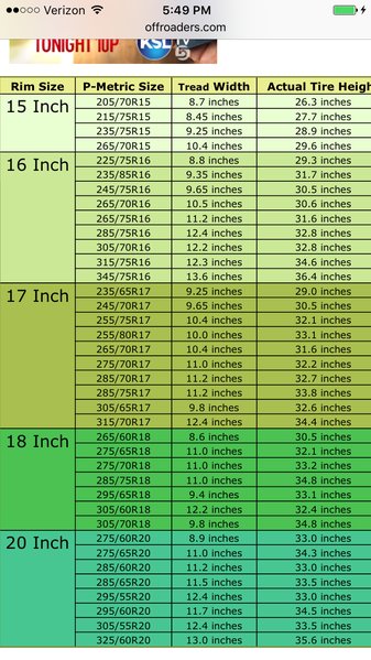

    Nope the 285/70/17 is a full inch taller than your current tire. Tread width is the same though
    You'd need 265/70/17 to have the same height tire
    Edit: derp you said ratio... In that case it's a difference of .75mm thicker sidewall with the 285/70/17 it seems
    Edit #2 : the table you posted seems to have the tread width wrong, I think what that table has as tread width should be section width... Cuz a 265 tire is always 265 mm of tread.

    I'm confused by that chart, 305/70/16 is narrower than 285/75/16? Or chart is just inaccurate?

    Think it's inaccurate. I pulled it off another 4x4 site. Didn't check it out just assumed it was right. Should of been more thorough looking it over

    First number is side wall height. Second is ratio to make width. Kinda odd way of doing it.

    No first number is section width from sidewall to sidewall second number is the ratio of sidewall height to section width.
