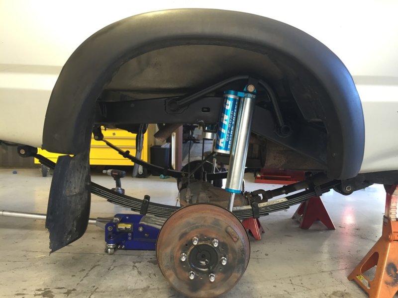

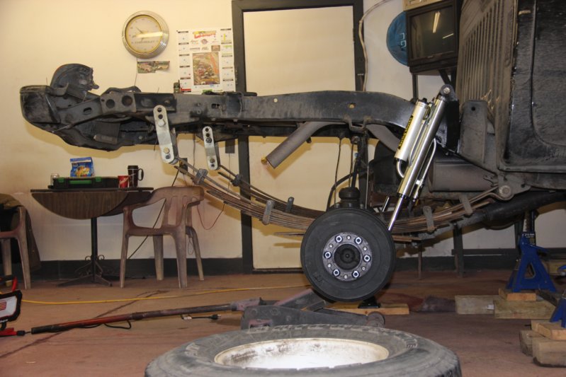

    Also i find this interesting for rear shock setup on our trucks.
    TC's outboard kit:
    Solos outboard kit:
    The TC one is much further forward. Less rubbing id bet tire wise..

    yes both kits require spacers. I'd think the TC one would work a bit better though in terms of clearance during flexing.

    I'd be leary of the TC shock setup, thats a lot of angle at full droop. At full compression its going to be a worse angle. I wonder why they didn't angle it back instead of forward, then it would straighten the shock vertically as the suspension compressed, which is what I did with mine.

    It's a lot of angle, but not a lot more than stock really.
    Its a compromise and probably the only solution to fitting shocks outboard on our trucks that works without swapping out a larger axle.

    True, but stock had them in both directions. When you only put them on one side at that steep of an angle it puts a moment on the drivetrain, sort of like axle wrap when hitting a bump. Now with how thick most LT leaf packs are it probably doesn't matter though.

    Well..not sure i agree with that. Not going to be a big issue anyways like you said. I mean look at how 90% of all rear long travel setups are.

    I noticed it on my setup, granted I'm not running a LT leaf pack, but I have a bastard pack of 63's and OME's. Although now that the suspension has broken in some it is less noticeable.

    could always add a trac bar.
