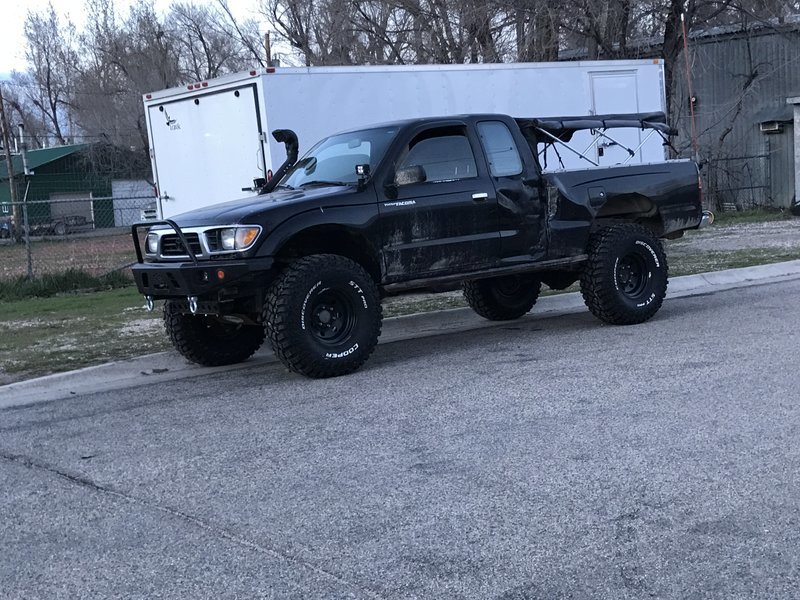

    35s? how was the cutting?
    How slow is it haha

    Sick dent
    Cutting wasn't terrible. Not the easiest thing ever but not horrible lol. Haven't driven it very far but we'll see here shortly haha.

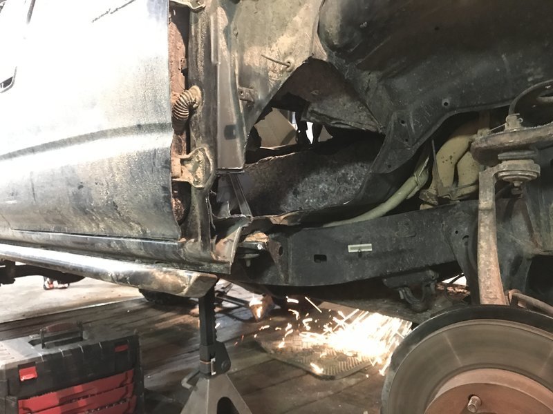

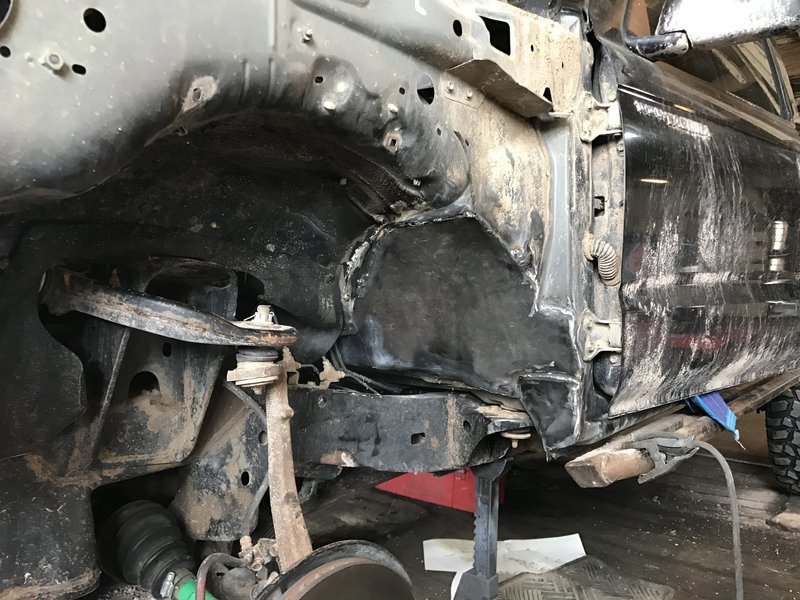

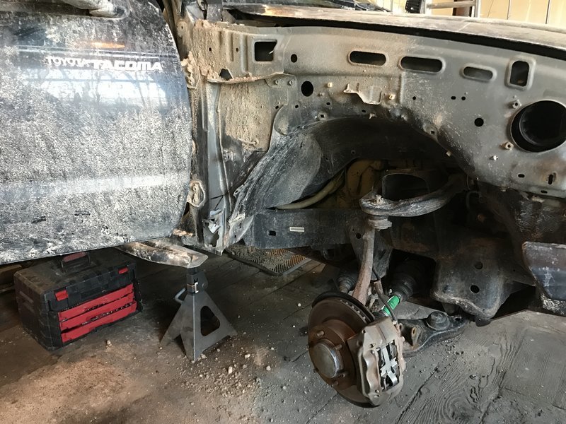

    Didn't take many pictures but here's a couple

    Ended up doing one big plate over the large opening then did a small plate over the pinch weld area.
    Got the tires mounted on the wheels and pulled the fenders and got it prepped for cutting Wednesday.
    Started cutting Thursday after work
    Didn't do much other than cut the filler plates out Friday night.
    Got it all welded and seam sealed today. Just have to put the interior back together and get it sorted out. Probably gonna clean it out and maybe mask and undercoat the panels from the inside tomorrow. I do rub the frame rails a little bit at full lock so might have to get some spacers..or just be cautious when turning sharp.
