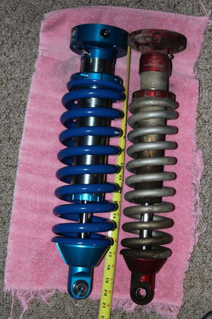

    That is what we had to do on the first aftermarket CO, when it had been all stock before that. It did not occur to me at the time that the SAWs would be all that much longer. But they were.
    And here is a side by side length comparison between the SAWs and the Kings. SAWs are longer but not by much

    No limit straps Mike?

    Yeah, my LCA did not raise and lower as I turned the axle. Not really certain what the limitation is when the shock is removed.
    I don't think I will be doing anything with the LCA/bushings for a while. The stock bushings still seem very tight and the cam adjusters are still free.

    Yes, but depends on what you're doing. Are you topping out your shocks all the time?
    And see below on limiting travel.
    :rofl:
    First, there's more benefits to "mid travel" than just the slighlt increase in travel. Second, if strapped properly the straps would stop the travel just before your limiting factor, which would be the shock. You would loose a negligible about of travel and prevent wear and tear on expensive parts.

    Yeah it springs back. But you can still lever it down fully...least a real man can, ask your future wife to do it for you since she has the muscle of the relationship.
    The tire isn't going to change how far the LCA goes. The ball joints will bind first.
    Well i guess you either have the UCA uniball getting smashed or the lower shock heim taking the weight.
    Right now it seems your heim is.
    If the bitch runs without the weird held back feel. I will get a wideband ASAP for sure. ANd boost gauge. But until it at least drives a little normal first. Not gonna spend $400 on gauges.
    Not really. Considering it only needs to be 1/8'' short of the shock travel. Still more travel then your OME apparently haha

    Yes, your shock is your limiting factor. My old OMEs topped out hard. The coil is trying to rip your shocks apart when you do that.
