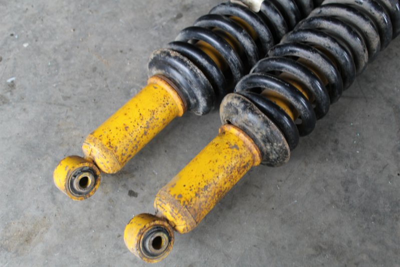

    Sure they do.
    Mine were destroyed when I took them off.

    Yeah the rubber wears on them just a bad. My 5100s were toast. after 2 years.
    So were yours, they certainly didn't look good.
    I've never had an issue with my ADS heims or my MCM uniballs. But i sprayed the shit Mike had on mine ones..and they squeaked after that. Idk about that stuff...

    The sleeves on Mikes weren't deformed either. It was the aluminum rod end. basically the same thing as the rubber.

    Hard to quantify this. All the time would include highway miles. Doesn;'t seen like it would be topping ou there. Yet it is obviously topping out enough to wear them out in 20K miles. I would guess from that, that the offroad travel is pretty hard on them
    Yes. I think you need to strap your OMEs. :rolleyes:
    I start lubing them when the failure has occurred already. The lube stops the squeaking.
    I would not get too high and mighty bucko. When the shock's lower rubber bushing fails, the only fix is to replace the entire shock. OEM, OME and Billies are not rebuildable. I will gladly accept this shortcoming on my Kings over those pieces of crap.

    This is not true. Tim told me the aluminum rod ends were fine and did not require replacement. And the sleeves were not deformed either. Only the heim was replaced.

    There's no rubber above the sleeves, the sleeves were essentially up against the top part of the mount.
    This, and a more direct connection between the control arm and the shock. It would be silly to have rubber bushing on a performance shock.
    Should be able to hear/feel when they top out.
