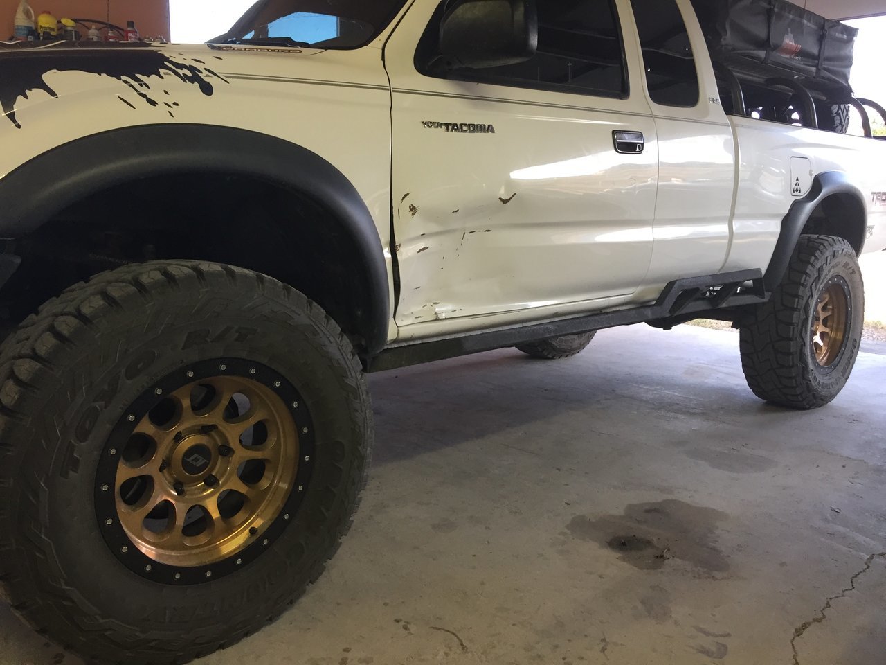

    Yeah I ordered them tonight. See how it goes.
    How it sits

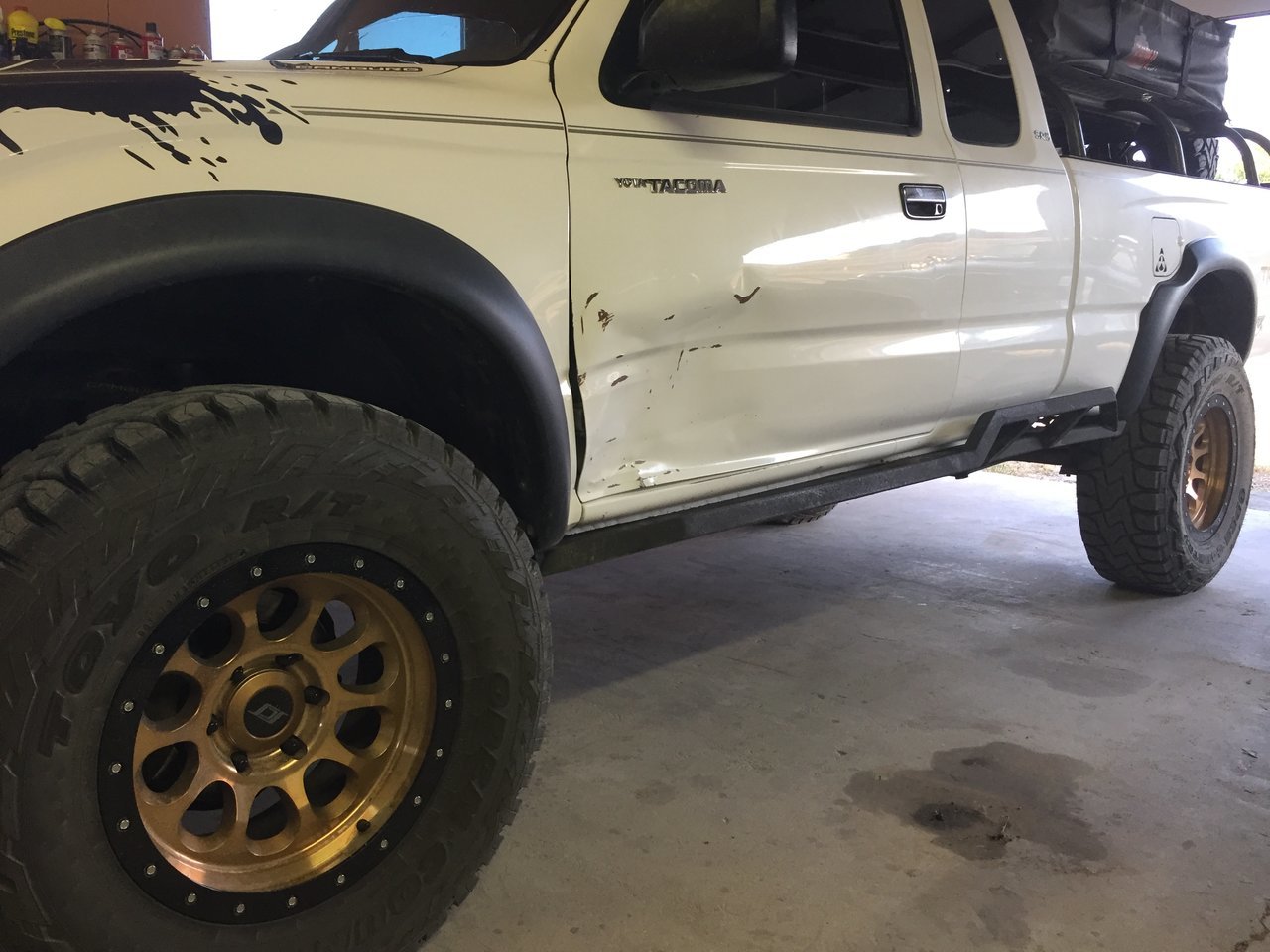

    Where I want to be

    Why exactly? 2" lift is almost perfect split of up and down travel

    Because I bought 295s like an idiot and rub when turning when I'm not flexed. Irritating. So I want to go up

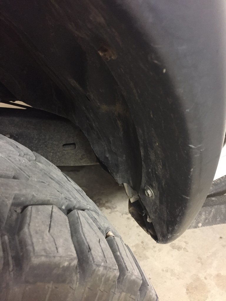

    lol I have no issue hitting it, just made sense that going up would help
    Catches the inside plastic when turning and when I hit a few hard bumps on the AZ trip it rubbed

    pfff cut that plastic off man.
    And cut off the pinch weld and hammer the shit out of the fire wall.
    Welcome to big tars :p

    You've got a lot of plastic to get rid of. Most of the wheel liner needs to go, bottom of the flare and fender, and all of the pinch weld. Also would help to ditch the stock flare screws and a get something that mounts flush.
    I'll take a picture of my firewall tomorrow morning.
    Going up helps at ride height, does nothing as soon as you use your suspension.

    Pinch is gone underneath the plastic. Was trying to keep as much there as possible to take the rocks the tires throw, plastic that is
