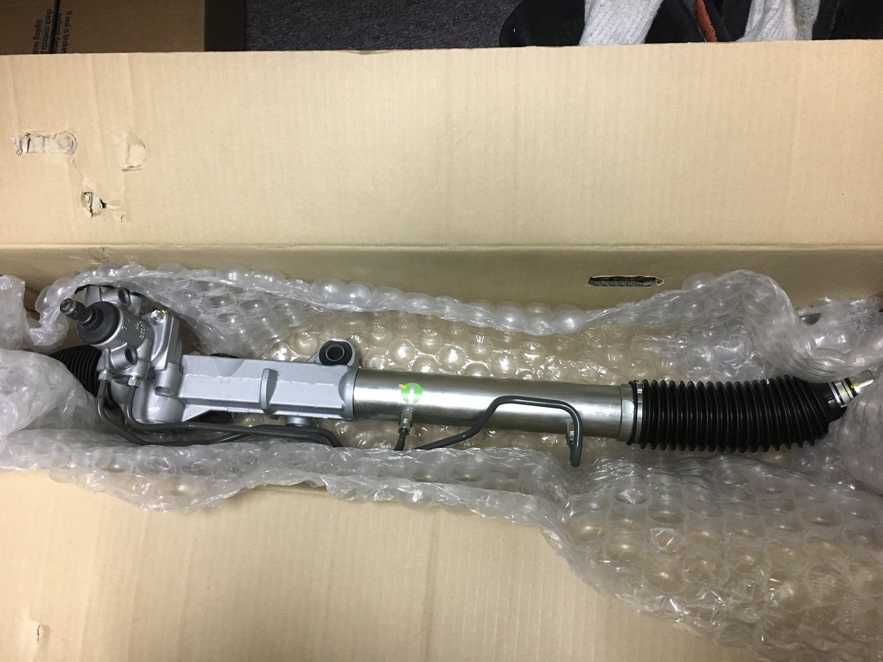

    At least my steering rack is here. Goes on with an alignment and will hopefully make the drive back to boise enjoyable for once

    Trying to just go home for the holidays and yet again the truck is fucking causing problems. Trying to replace the rack and the god damn outter tie rod lock nuts are seized together. I thing stupid fucking big o wrenched them down too tight. Any ideas?

    Got the ham nuts loose with bigger wrenches. Put those on the shopping list. Shock still confuses me tho

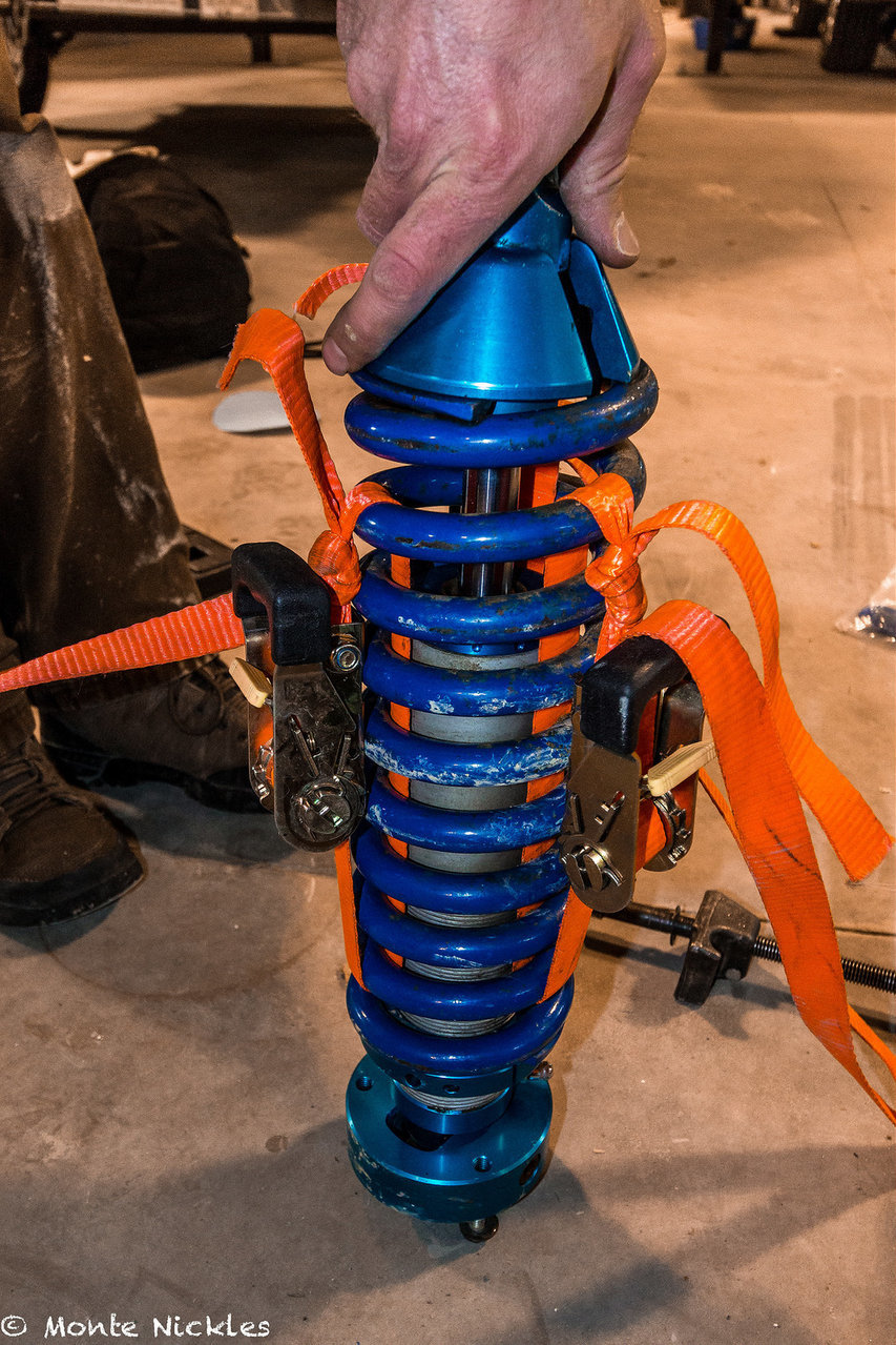

    Nope. And I have no way to get a coil compressor. The auto parts stores don’t “rent” tools here
    Ratchet strap method lol?
    i have 2 vehicle tie down straps. any reason i couldn't fish the loose end of the straps through the springs, back to the ratchet, hook the strap hooks to each other and compress just enough to take tension off the collar.
    The hooks themselves are too big to go in the coil, already tried that. but then i had the thought i can just loop the strap through the coil then put it in the ratchet and its way less sketch

    We just tied them on. Seemed to work fine. But will be way easier off the truck.

    Was there a 3rd strap on the back side that isn't seen in this pic? Looks like the coils get a bit marred up using this method.
