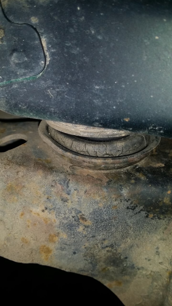

    It's a taxed rubber bushing. They crank and deteriorate like any other. Offroad is real rough on them.
    For instance here is one of my fronts since I have the bumper off.
    Pretty rough looking.
    However my body lines show no significant different from the cab to the bed. Remember the bed is hard mounted to the frame the body isn't. As the bushings go out the cab will sink up to 1/4" from the bed lower. If that happens definitely time to swap them.

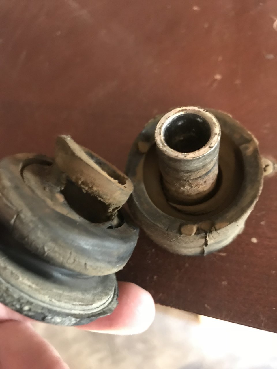

    These were my radiator ones at 41k miles on a 2011. But my body can mounts looked brand new still.

    Must have happened back in its days at the mine

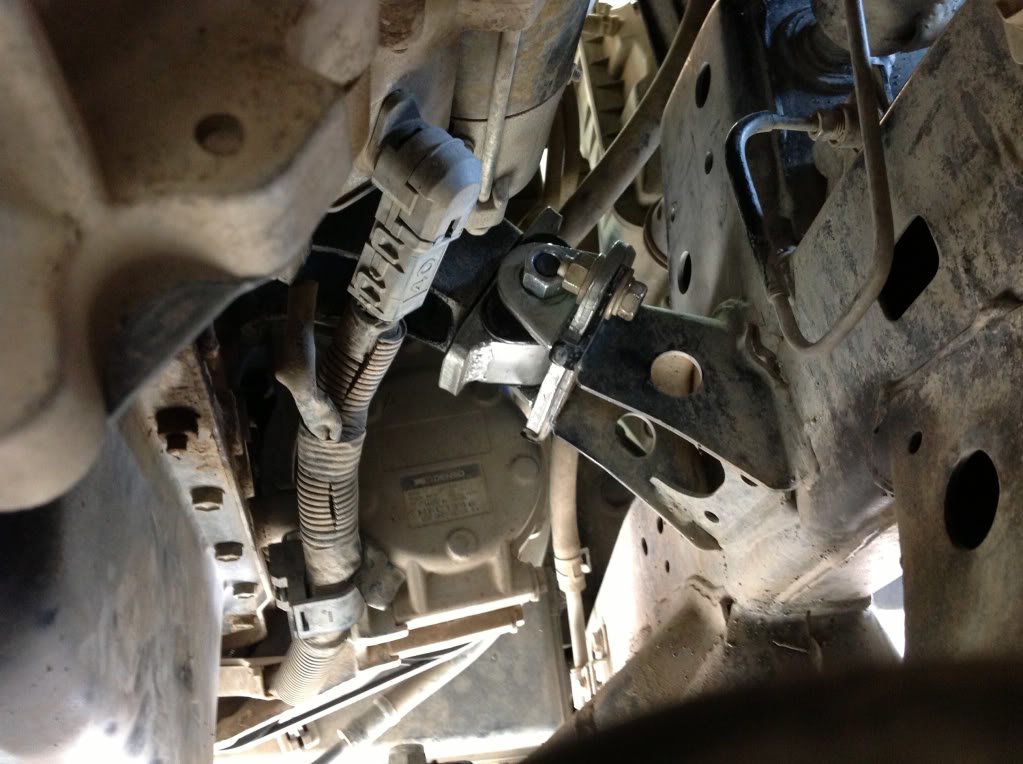

    look cast iron.
    Bozen uses the OEM mount form the motor as the bolt pattern and I think just gussets it. He won't take the cast iron ones though obviously.
    perches are dinky.

    Oh weird, I guess V6s get cast iron mount perches then. Mine have some bent 1/4 plate that make up that part that the motor mount bolts to.

    nah Bozen said that the cast iron ones were only in the early models and kind of rare.
    Might be just steel. Those are Franks obviously and Im not by him right now.
