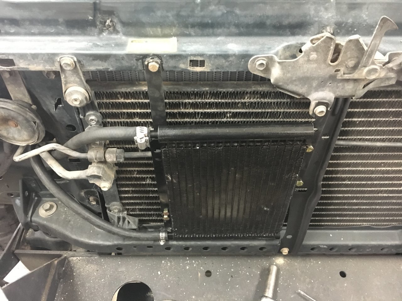

    I did something very similar

    Thanks. It's held up like that?
    That looks pretty solid. I might have to wait to do this till after st louis. Need the truck back together first to drive there

    Yup. Very solid on there. May be a lot easier to do with no bumper in the way. I did not have that luxury.

    Will be towing a trailer back from St Louis so guess it's prime time for the tranny cooler.
    What did you guys do about the ac line? Min hits it pretty bad in that location. @IDtrucks @Digiratus

    Nothing...lol it just bent *slightly* back when I mounted the bracket up

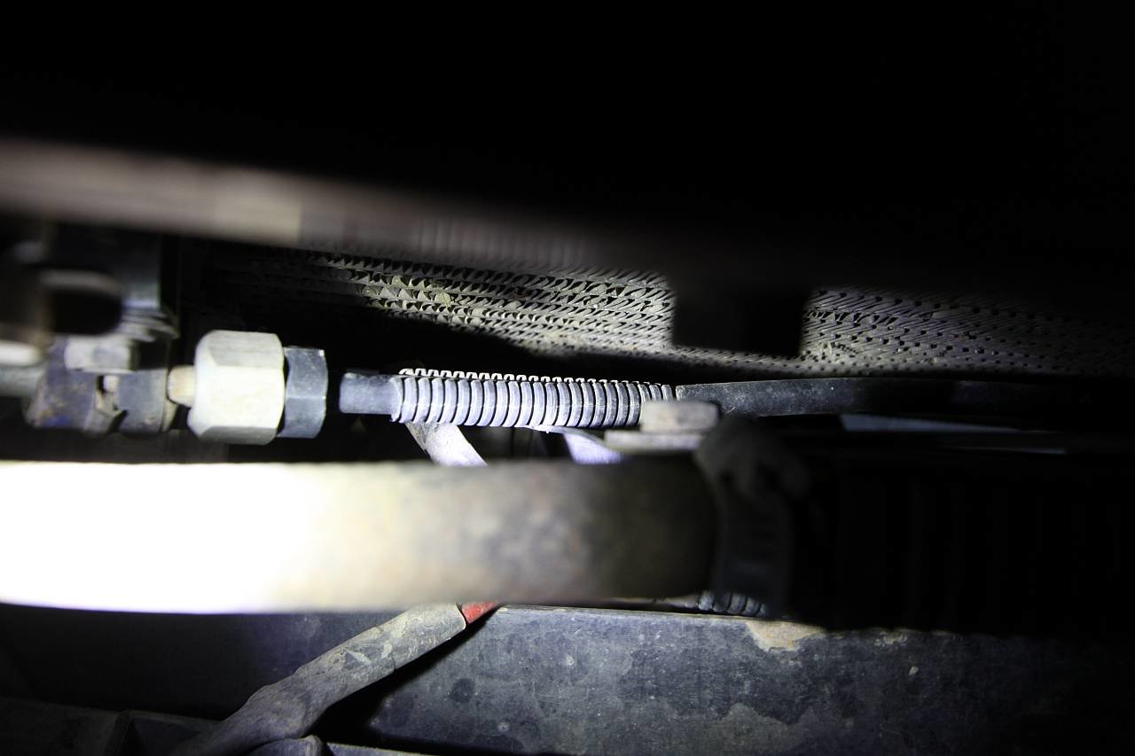

    I was not super concerned about the 1/2" wide flat surface against the AC line. If it had been a sharp edge, it would have been different. Plus it was tight up against the line. Not like it can bang into it. I did put a thin piece of plastic split loom sleeve on the line which you can see in this photo.
    I just took this view from above about 5 minutes ago. Looks like 3 years of mounting it this way has had no impact or wear on the AC line.

    loom is a good idea. I'll grab some. need some hose to line the hole through the core support anyways.
    did you barb into the stock lines to the tranny?

    My fluid path is through the radiator, then through the cooler then back to the trans.

    right so did you just use a barb fitting from the cooler to the stock line back to the tranny or run new line?

    I really can't remember for sure. :oops:
    It makes sense to run a new line from the cooler all the way back to the trans hard lines. Make sure the kit came with a long enough line to do that. I'm pretty sure that is what I did.

    no way there is enough hose in the kit. I'll just get more 3/8ths.

    You shouldn't need to go all the way back to the trans. Just have the lines go; stock input line from trans to rad can stay, join output of rad to input of new cooler, join output of new cooler to stock trans return line. Can do it all with some rubber 3/8 line

    yeah i know. Some use a barb and just hook them together. Thats what i was asking.
    Don't really care either way, just asking the guys that i know wheel hard with one installed.

    I haven't needed to change the one on the cruiser, it never gets hot and is half the width if the rad but I've done two now on friends Jeeps and they're cake. If it uses a threaded end I just cut them off and flare em with a brake flaring tool so there won't be the chance of a line accidentally blowing off.

    It isn't all the way back to the trans. It's back to the hard lines from the trans. IIRC, the hardlines run up along the frame to about half way to the front of the engine.
    I would just get a longer hose and not use something to connect two pieces of hose together. Seems like another point of failure to me.
