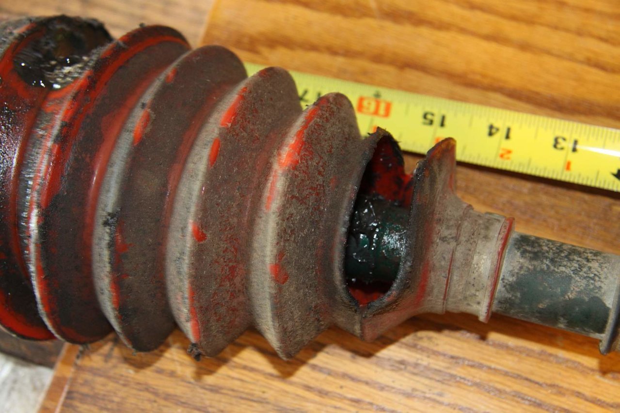

    I have a question for those with some experience with repairing/rebooting our 1st gen cv axles.
    Should I be able to stretch out an axle so much that the rollers come out of the cage or guide they normally ride in. Is this normal? Ignore the torn boot.
    This is a CVJ remaim axle that is about 2 years old and has about 25K on it. I swapped it out of the passenger side today.

    Yup, the cage slides right off the tulip freely, the geometry of the front makes this impossible when installed but the boot is the only thing holding it when uninstalled.

    Ok. My first experience with a torn boot. Good to know the axle itself is probably fine and worth rebooting.

    Mark it so you can put it back in on the same hump

    How are you supposed to do that with all that grease all over it. I suspect in the cleaning process itself it will be easy loose sight of which ball goes in which slot. :oops:

    I use a little center punch and puch a divot on the end of the tulip shaft and on the outside of the hump on the receiving end

    Ah yes. That makes sense now.

    It's been torn for a few months

    Yeah, it did. Supposed to be their good one too. It slplit along the ridges in two places. It is sold as a high angle, silicone boot. Paid extra for it too. Kind of disappointing actually.

    Almost a year actually. Monte saw it first when we swapped out idler pulleys in the O'Rielys parking lot in Moab last fall.
