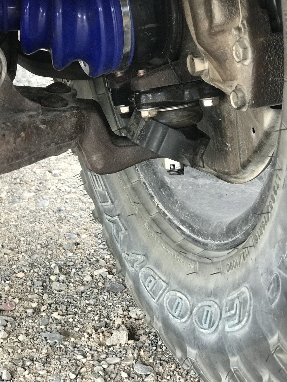

    :( Not very concerting, considering I installed the same exact axles last weekC5B7911C-3AE6-4CF1-8CED-CC51D8028B94.jpg and also no project would be complete without one numbnuts mistake. Really don’t want to break the joint just to put it on right side up.

  9. Aug 13, 2018 at 5:35 PM

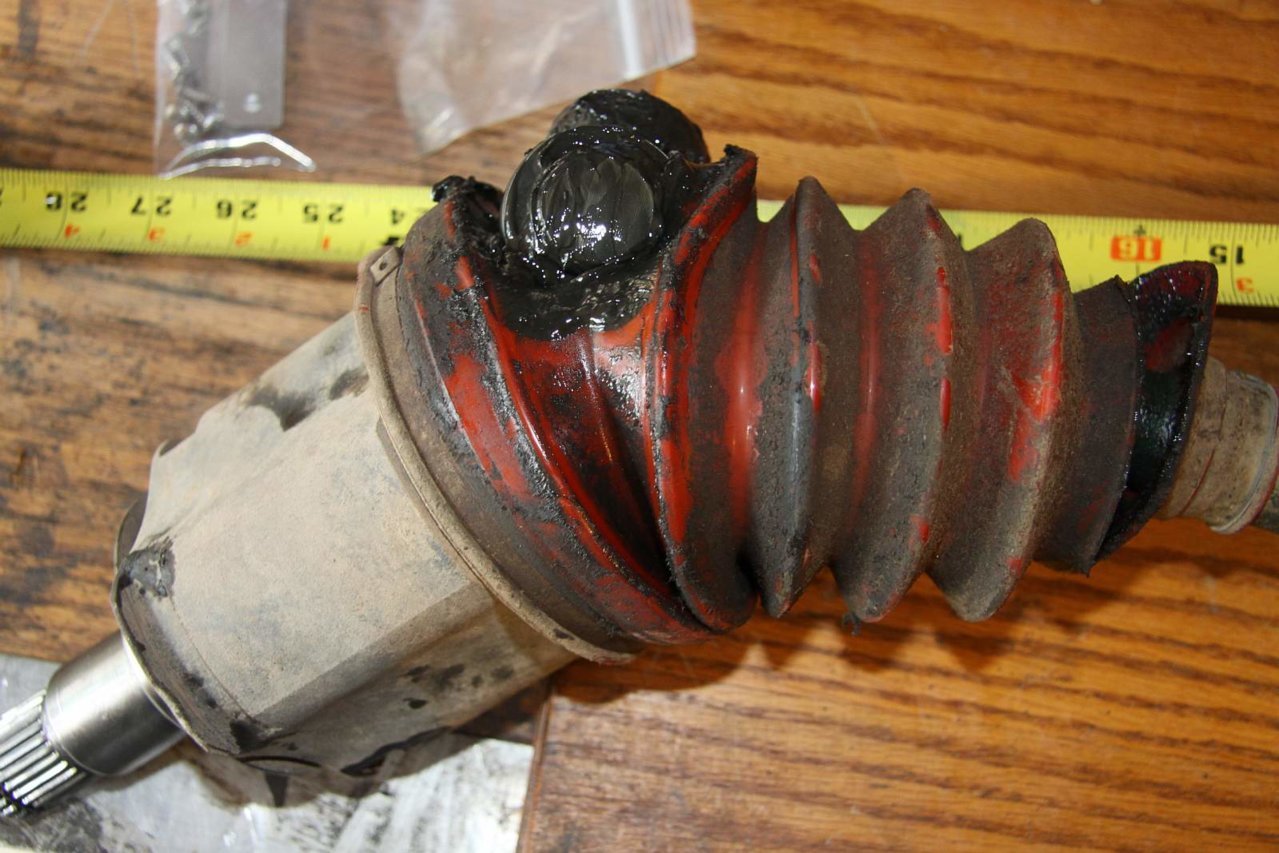

    The red boot is supposed to be the better choice. Just not as sure about that as I once was. I am sure the axle itself is fine. It is OEM afterall. I am still hopeful my red boot was not typical because I have another one on the other side.
    What is the blue boot? I haven't seen one of those before.
    Did they do the boot slide mod on yours? How much axle shaft is exposed on yours? I am wondering if stretching out the boot may have contributed. Mine split in two places right on the ridge. It was not from rubbing wear.

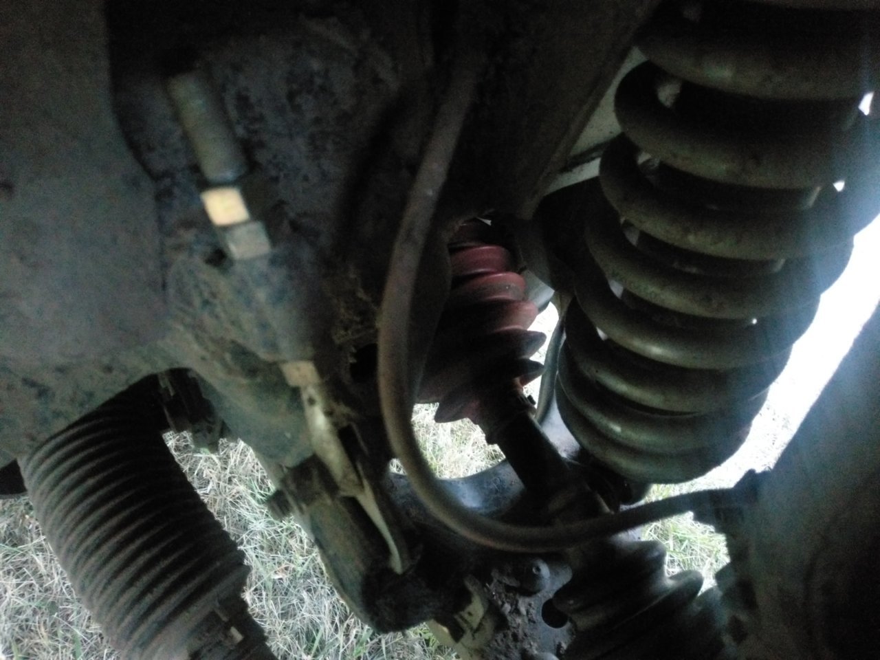

    Mine did come with the boot slide, but also an extra set of clamps, and a note saying you may have to move it for your application.
    I did end up moving them inwards, as they were rubbing against the bottom of my coilovers, but I don't think there are as far inwards as the stock position. They also had a little tube on the outside clamp, that you removed once you got it where you wanted to relieve any pressure created from moving it.
    Crappy phone picture:
    Digiratus[QUOTED] likes this.
