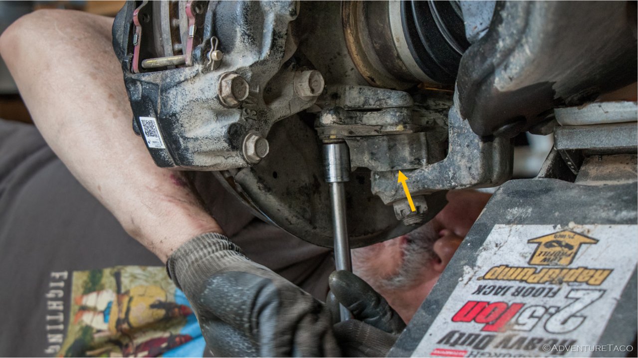

    • 98-00 LBJs DON'T have a rubber skirt that covers the LCA where it connects to the LBJ. Since the bolts contact the LBJ directly (and thread into the spindle), they use a flanged bolt.
      Here's a picture of my LBJ without the skirt:

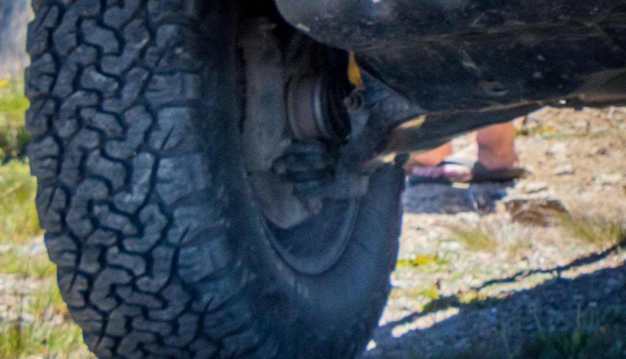

    • 01-04 LBJs HAVE a rubber skirt that covers the LCA where it connects to the LBJ. The bolts push up through the skirt, then the LBJ, then into the spindle. Because of the rubber skirt, these bolts have a washer on them (so as you tighten them, you don't tear the skirt). You could of course use the flanged bolts too, but you'd probably want to remove the rubber skirt.

    In looking at your truck, I'm not sure if you have the rubber skirts anymore (here's a pic from our recent idaho trip). If you don't, you can use the flanged bolts, in which case, my part numbers above fit and come with bolts.
