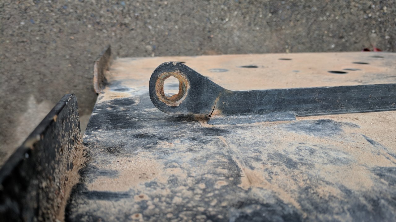

    interesting. It also looks like the point under the mount was suspended and not welded there?

    Yeah, it's welded right up to the point where it starts into that "ear" up to the bolt, so not directly under the bolt. Other side below.
    Must have been broken the entire last trip, probably happened sometime on Re-Tour.
    Could be the heat from the weld I guess, but I'd think that Eric is more experienced than that. Not continuous either, but given the location of the break, I don't know that continuous would have been any different.
    68 is pretty good. Hoping to get another trip in early Dec. Shoot for 75!

    IMO - if that's how I would have mounted my mid skid, it would have broke on trail #1.
    There's some holes in the transmission crossmember you can use. Drill 2 holes in your skid, use a carriage bolt all the way through with a big washer on top. Works fine.

    Ooo, I like that idea! Probably easier to attach as well - it's been a royal pain trying to get these onto their respective crossmember bolts each time I install the skid. Will just need to figure a way to square up the hole so the carriage bolt wont spin.

    A few minutes with a good file should cut through that mild steel pretty easily.

    Yep, just drill a hole then use a chain saw file to square it out. Takes time but works good.

    Seems odd to not just continue the seam to me and weld under the bolt.

    that may be true but certainly not that you can't fit the tip of the welder there. Looks like PLENTY of room for that.

    Yes that's what i mean. I don't see the point really..
