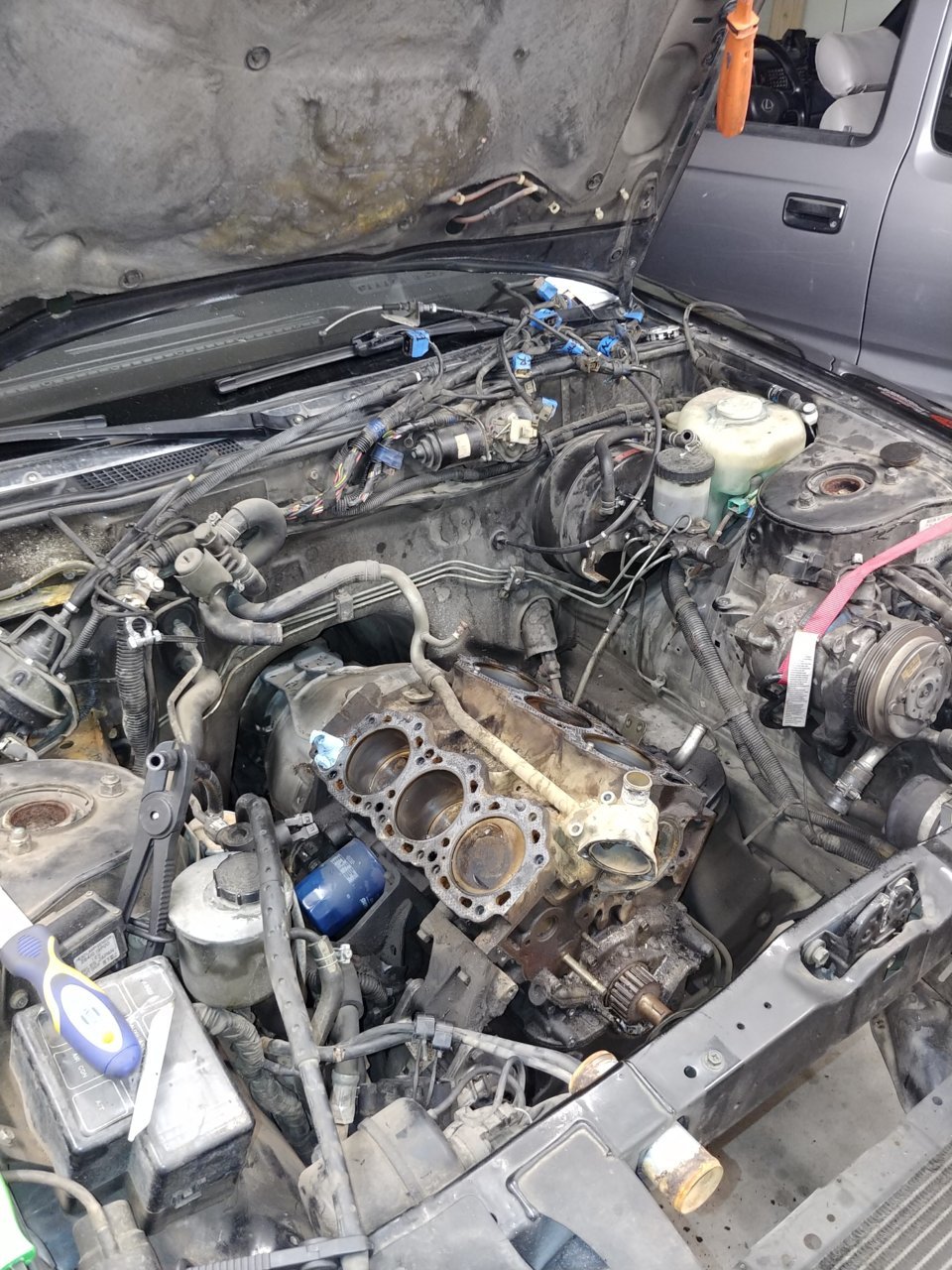

    Completely, down to a block and rotating assembly. Went through it to bulletproof for boost. Heads are rebuilt and ready to rock. Trans I resealed and fixed the shifter. I'm reassembling the long block and cleaning up the EFI harness right now. Been like this for a few weeks though as I prepared...

    You did the heads but not the pistons/rods and bearings?

    I checked the tolerances on the mains and rods, they didn't need to be touched. Rods and crank are already forged on a VG30 so no reason to fully tear down. I was contemplating changing the Pistons for forged but at 25lbs of boost there isn't much to worry about. This stock bottom end is known to hold 700hp reliably. I'm only going for 400-425. Anything above that is gonna require quite a bit more than just Pistons. Haven't put the heads back on yet cause I was considering throwing bigger cams in first. Still not decided on that yet

    ah gotcha. Idk shit about nissan motors really other than a bit about the RB25.
    Cool though.
    I don't think anything more than 450 is worth it for a street care. That is plenty of power to kill yourself with haha
    Twin turbos? Single?

    Single, holset HX35 with a .53 turbine housing and changing the stock compressor wheel out for a billet unit. Should come on pretty aggressive starting at 2800 and build to the top of 38-3900, the thing revs to 7200rpm so I think that's pretty reasonable. And unlike the stock turbo cars with their low compression. I'll actually have some low down grunt too

    The HX35 is nice. Be great with a billet wheel. With a rev range that high you'll be good. I still prefer less turbo lag personally just so it's more fun to drive on the street.
