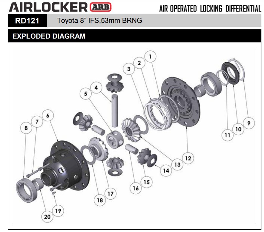

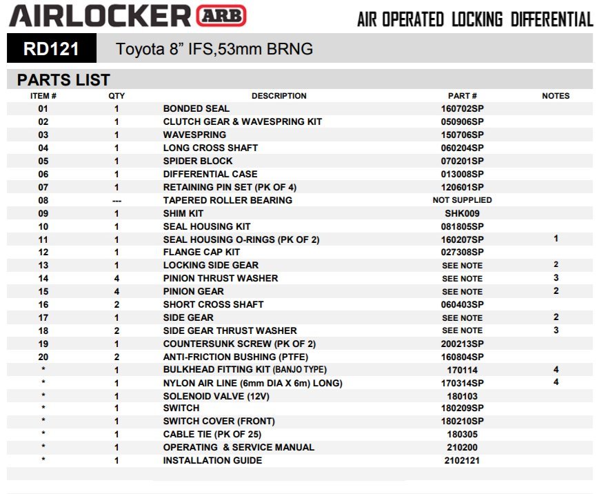

    The ARB replaces the entire carrier and comes with a bushing in it. I would try a different axle before anything.

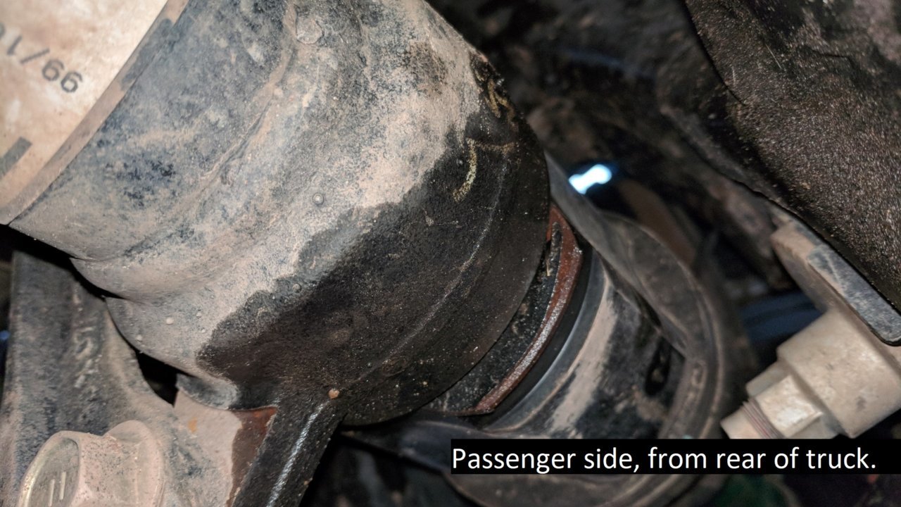

    Those could be pics from my truck from this afternoon. :oops:
    Are you certain they installed new seals? If they did on yours, they most likely did mine too.
    How much in-out play are you seeing, particularly on the driver side?
    And we need a copy-cat emote on here. It could be named Dan.

    I knew the ARB replaced the spider gears but did not realize that bushing was also replaced. I still have the axles that came with the truck but they need new boots. I will rebuild them and then reinstall. Thanks for the feedback Brett. Very helpful.

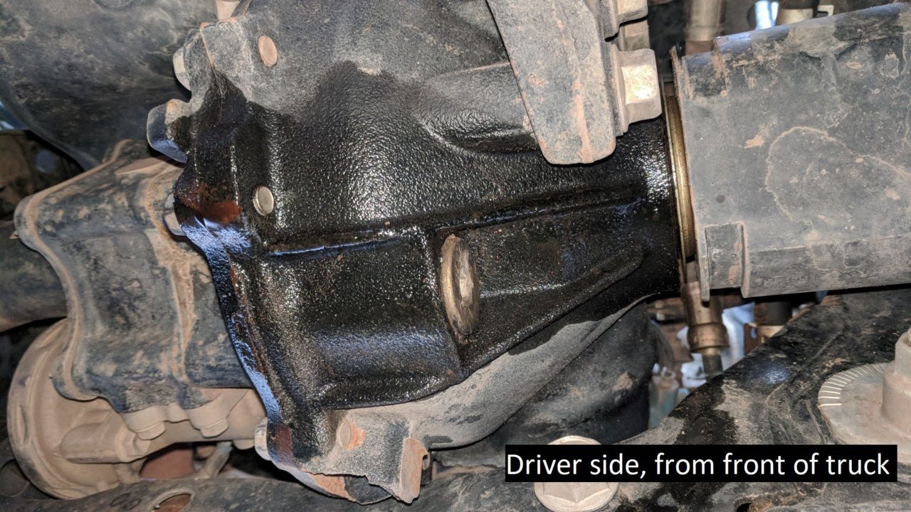

    I am certain they installed new seals. I actually emailed Carl (JT's Parts) since we've traded a ton of mail in the last year so he's always really quick to get back to me. He confirmed they put new ones in and suggested it could be my old CVs (I might be learning a lot about the truck, but I'd never come up with that myself :D), which is why I asked.
    I didn't check play, but just went out and checked. I'd say less than a 1/16" in-out play with the wheels straight and on the ground. Both sides.
    I don't think it's the breather. At least for me, mine's been "working well," which I know because it's been burping up diff oil for the last 6 months. :rofl:

    Brett you're saying the needle bushing is replaced?

    However as Brett stated the ARB negates this and has its own bushing. So..no it isn't relevant as both Mike and Dan have ARBs in the front.
    Yes that photo is for a 8'' clamshell but same thing for ours just smaller.

    Up and down play or in and out play? I have almost no up and down play.

    Yeah, good idea. Brett - just pressure wash the outside of the CV/Diff joint? Mine already looks pretty clean at this point (from the pics).

    So now, to show my lack of knowledge - is there a seal right there at the joint between the diff/CV? I guess I thought the seal was "further in" towards the diff for some reason... Can you "see" the seal in either of my pics? Is it the gold-ish piece on the driver side (or in that gold piece)?
