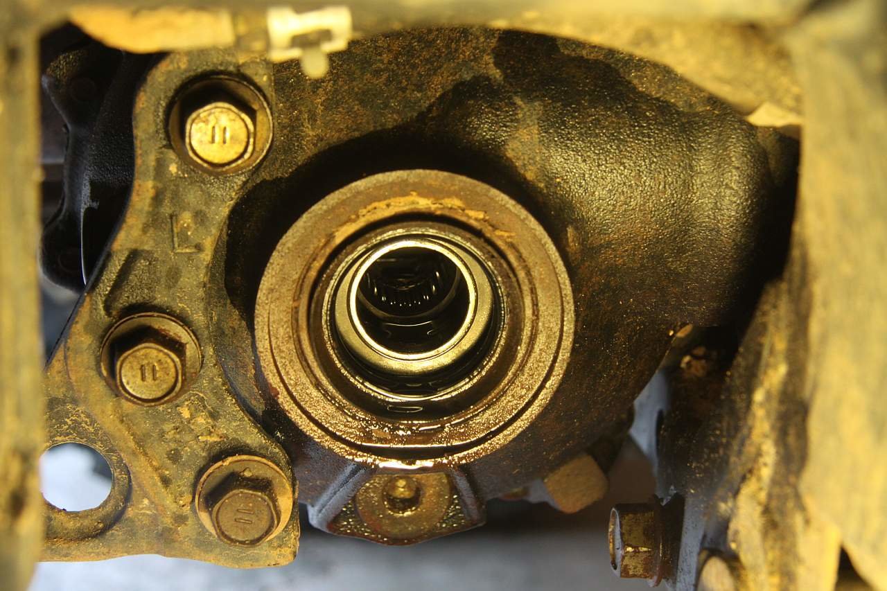

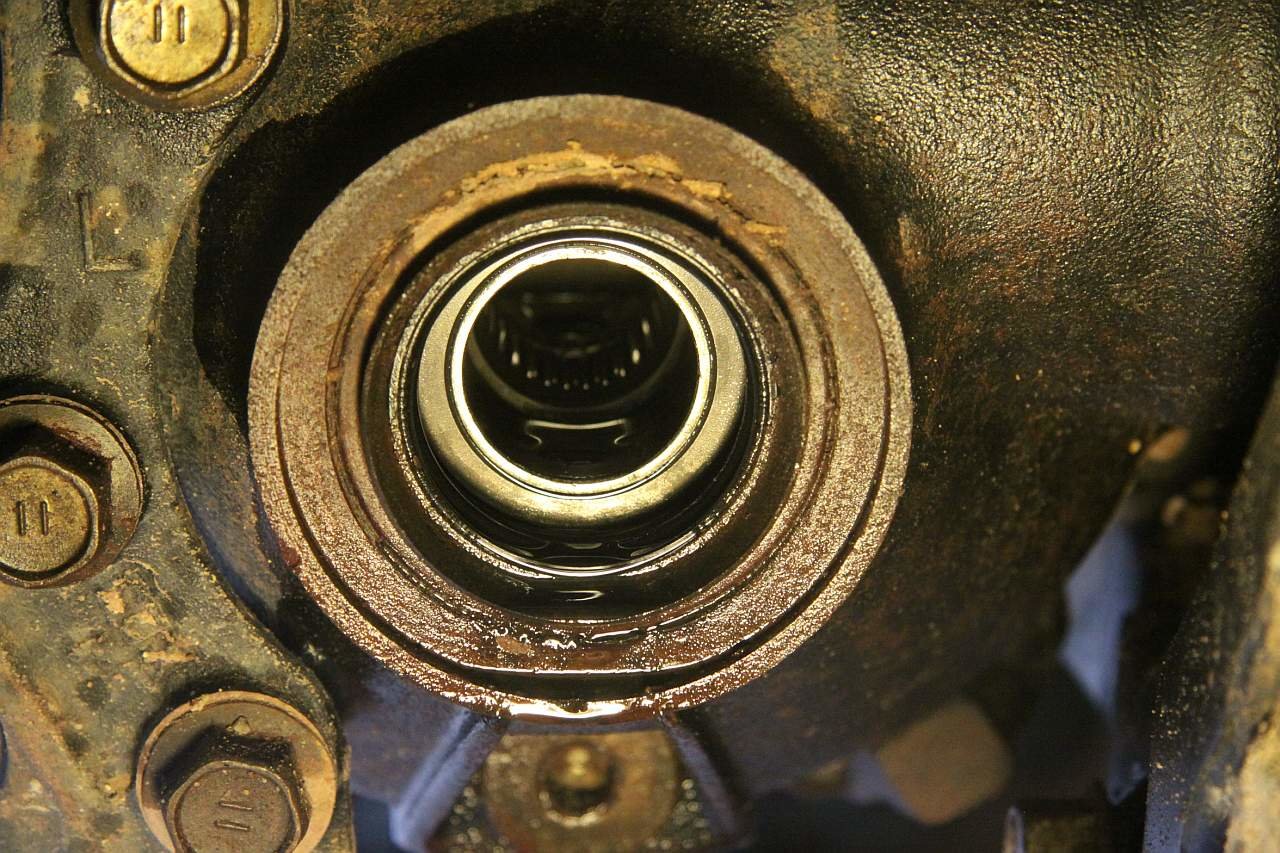

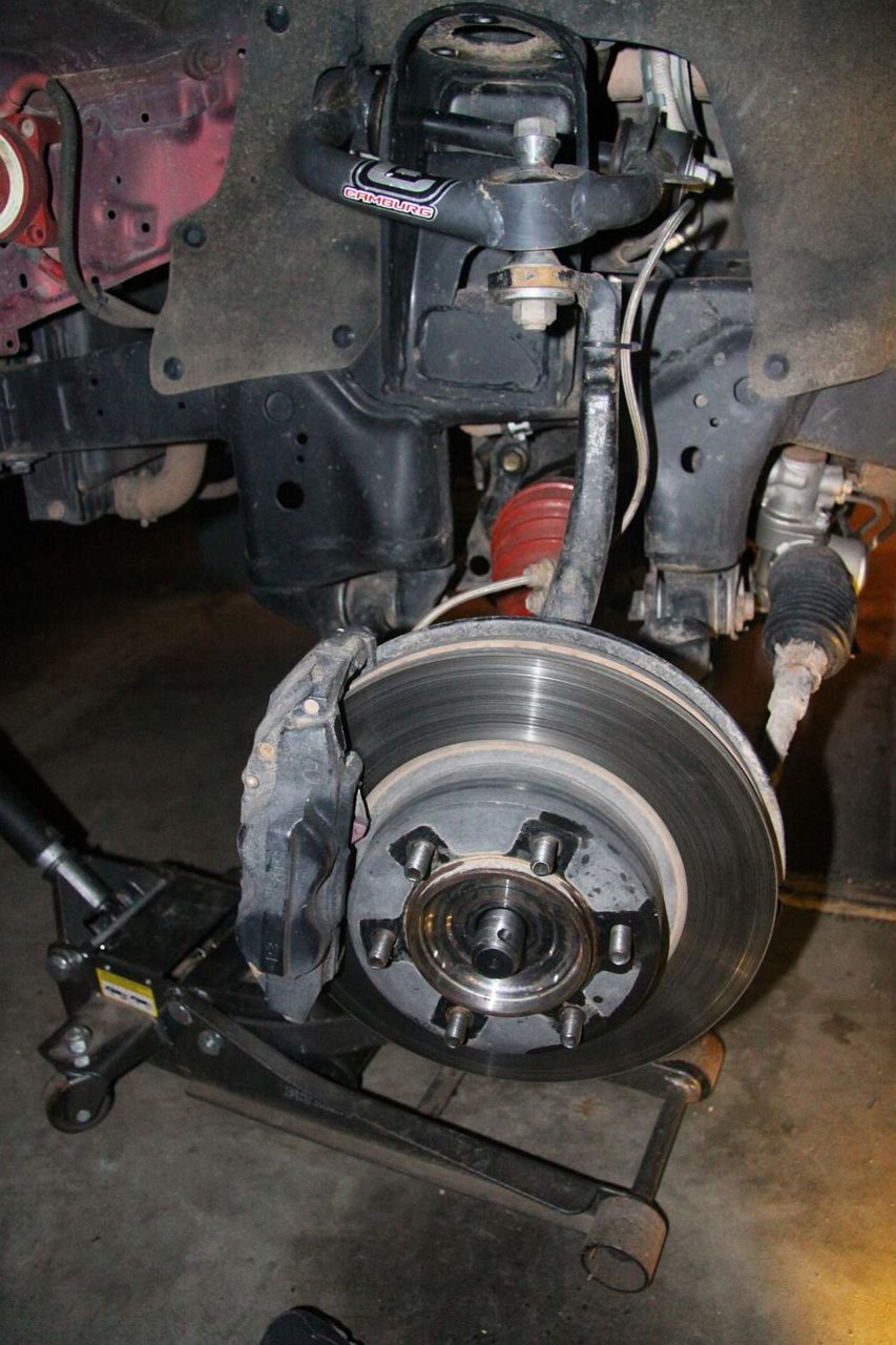

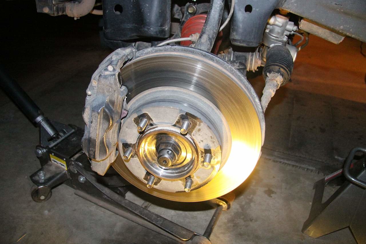

    After pulling the axle, I found a very dirty seal.
    I clean it all up and the seal itself seems to be in good shape. It cleaned up really nicely (no pic). Time will tell tho. Reassembled without replacing the seal.

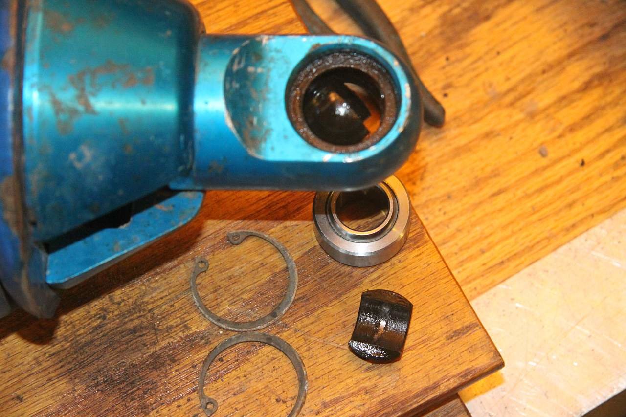

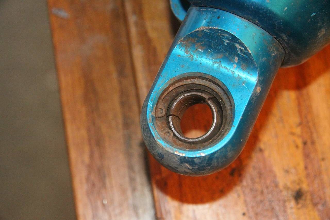

    Also replaced the lower shock bearing. It was making a lot of noise, now I know why.

    Still happy with the cheap daystar bumps in the front.
    And how old was that bearing, Mike? :rofl: Mine last a season.

    That's just how long they last in the lower rod end. They develop some play and get pretty noisy.
    FWIW, upper last twice as long. Just the dirt and water and grime kills those in short order.

    Depends on your definition of fail.
    IMO, if there's play in it, it should be replaced. Could it be run longer? Yes.
    It's less than $10. Cheap assurance on an expensive shock.
