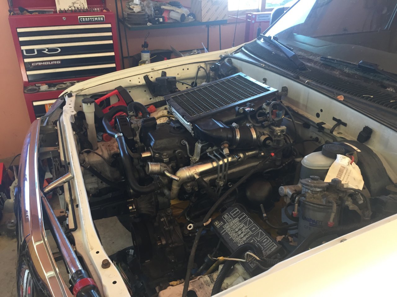

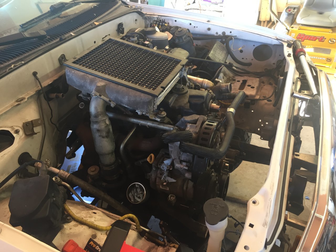

    I can almost hear it idling, love how it all just fits.

    When's the FMIC go in and more boost? :p

    Find one and I’ll help you get it in. Not sure on the FMIC, think there are plenty plug n play chips overseas I can order for more power in the future.

    Be more efficient. Be cool to mount right behind the grill like the other turbo guys
    And maybe haha probably do a 2jz first.. but rolling coal would be sweet!

    Friend works at a body shop so my plan is to go with the skewp on the hood. I’ll go front mount if the hood isn’t going to close but so far it looks like it will be fine

    Ah the 4runner scoop mod is nice when done well. Gotta build a shroud for it too

    Yeah not sure how it’s going to work yet, let the pros handle the metal work. Maybe just put some adhesive foam underneath to create a seal. How much more efficient is a front mount? I guess I just assumed they did that because a top mount wasn’t an option and front mount kits are easy to get ahold of.

    They can be a lot more effective.
    A) the intecooler can be bigger
    B) it's not getting heat soaked by the motor by being on top
    C) more direct airflow generally
    Downside is you can see a bit more lag as the tubing is increased and can see pressure drop too with bad ones

    Ah, yeah I suppose if I was going for max HP I would look into it more. I like that it’s on top and not down low too. Feel like since it will be for off-roading, less things can destroy it being up high. Can’t be all that bad since Toyota has been putting them there for years.

    nah same for subies. Its not bad, just not as effective and a hell of a lot easier to mass produce.

    Yeah, just easy to package. Too small and heat soaks easily.
    Turns out heat rises, who'd have guessed that
