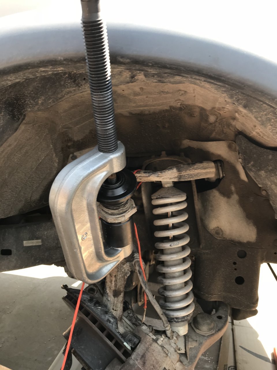

    Q: pressing out the UBJ and pressing in the new collar for the SPC UCA's (with a ball joint service kit, cups, etc.) - easy enough to do with the spindle still attached at the bottom, or should I take it all the way out?

    I found it much easier to get the old upper out of the spindle on the bench. we struggled with it when it was still attached to the lower bj . The spindle moves around to easily.

    Yeah take it off. Just do the 4 lbj bolts.

    0B68B3DB-C9F7-46BC-B953-463BDEE32AFB.jpg You don’t have to, as long as you have an assortment of impact guns, it’s fairly easy to leave it on the truck.

    That snap ring has caused many men much pain haha

    Getting the new snap ring on was my greatest source of frustration.
