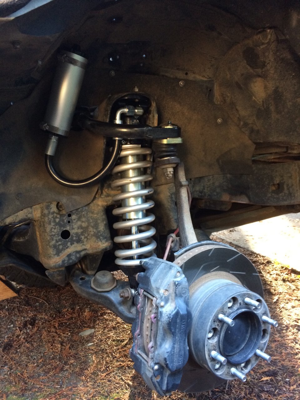

    But how? Here's a crappy photo, but you can see that the resi is hitting the body mount already. Can't move it any further forward.
    Edit: maybe I just figured this out myself looking at the photo. Can I adjust the fitting at the top of the coil where the hose connects? angle it out slightly more?

    Yep move the fitting.
    DO NOT LOOSEN IT. You'll loose your nitro. But should move. If not. Twist the residents so the hose get a bend in it. Slide it more towards the coil and zip tie the hose on the bucket

    Your front suspension looks awfully familiar :cool:
    After my little incident last year, I shortened the hoses and moved the resis to a vertical position next to the UCA. I looked at doing it the way you have it set up but I think my tires would rub there, and I feel like they’re better protected from rocks and whatnot higher up.
    And those hoses are crazy tough. Incidental rubbing on the smooth coil springs would take about a million years to wear through one of those.

    Yeah, I tried twisting the resi already and it didn't affect the part of the hose that touches - it's too close to the fitting on the shock. Also, seems like a zip tie to the bucket is the same as a little rubbing on the spring.
