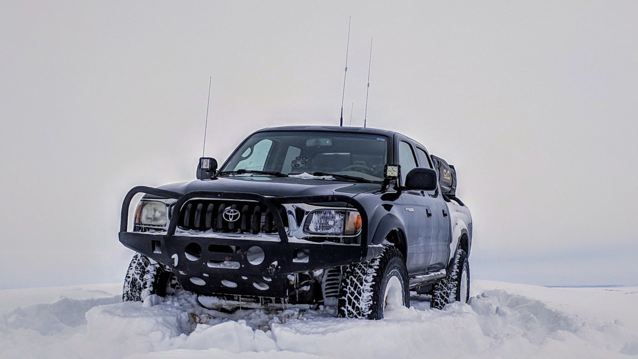

    Got to off-road sort of today for work. Busted up the mountain in a foot or more of powder to get to a sculpture to do some filming and recording. Was fun.

    Yeah was super pretty out. Calm before the next wave of weather. Been snowing like a bitch here. Was fun busting through all that though. Couldn't hardly see most the time due to it coming over the hood haha
