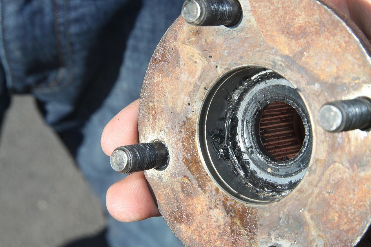

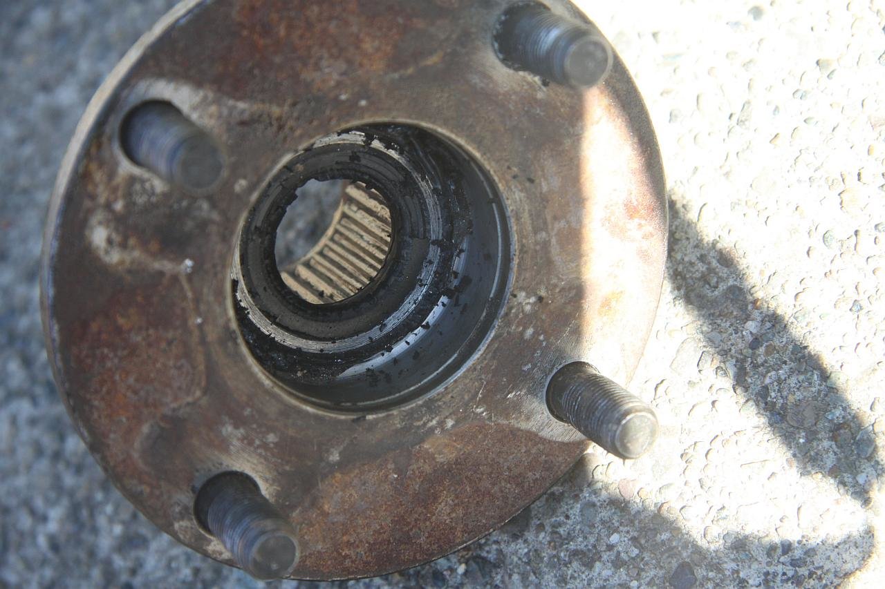

    There seems to be a reoccurring theme here. You may recall last December when I discovered the driver side front axle seal leaking out of the blue. Afterall, we had been back from our adventures for over a month but it seemed like some of the things I did with the truck were coming back to haunt it.
    Here is what the seal looked like when I pulled the axle:

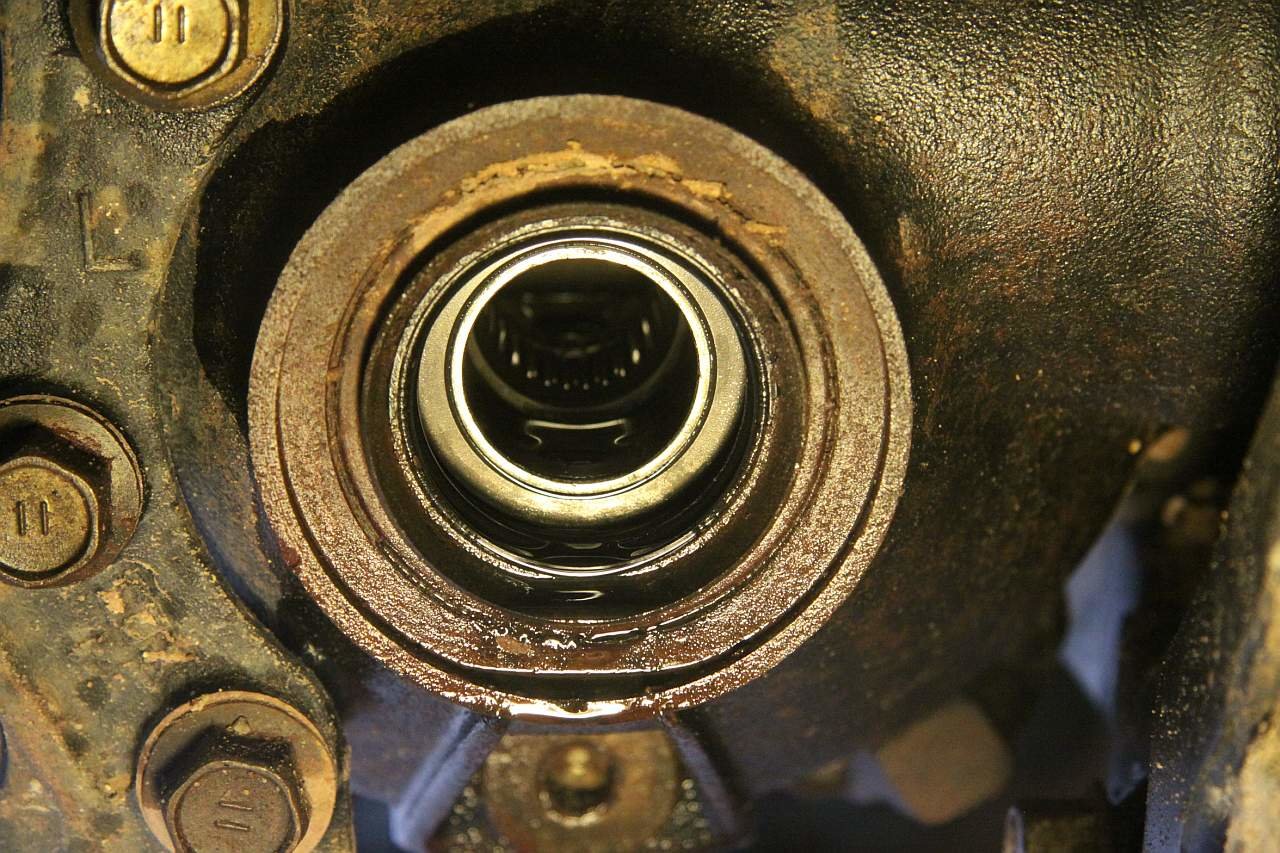

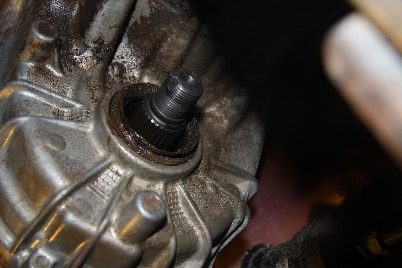

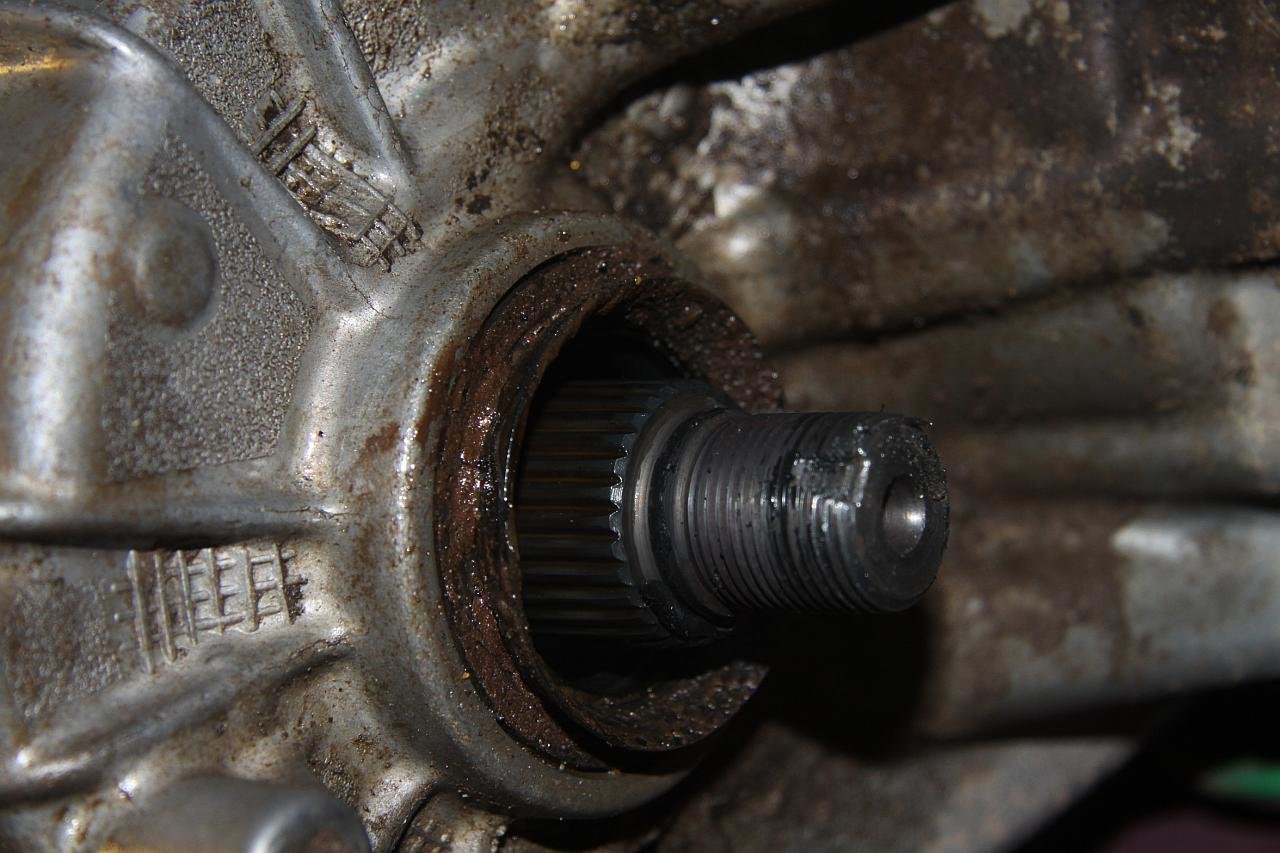

    Fast forward to yesterday when I finally got the staked nut off the companion flange on the front output shaft on the t-case. Here is what that seal looked like when I removed the flange:
    Looks familiar doesn't it. :brianr: to muddy water crossings.

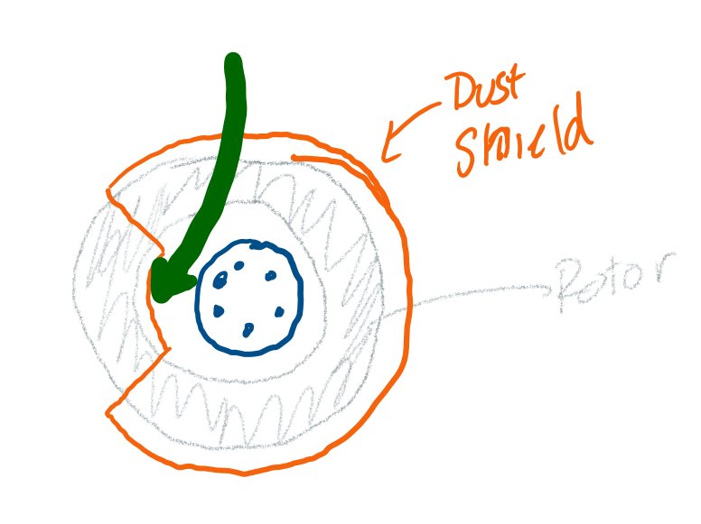

    I'm 99% sure it's not rubbing on the dust shield. I know that sound (had it on the Taco). But, I'll poke around and see if there's something else it's contacting. Hope that's it, because it'd be an easy fix.

    What was your final method for the stake nut?
  4. Apr 1, 2019 at 9:22 PM
    Digiratus
    Digiratus Adventurer
    Mar 26, 2010
    #34006
    23,785
    Roaming the PNW
    The RedHead
    2002 XtraCab TRD 4x4 SCv6 AutoTrans With Lots of Mods ADS COs w/Compression Adjusters Camburg Uniball UCAs Whiteline Lower Control Arm Bushings Kartek 7" Limit Straps Plastics Guy Front Bumpstops Total Chaos Sprindle Gussets Custom Alcan Springs +800 lbs +3" ADS 10" Stroke Triple Bypass w/Resi Rear Shocks Custom Rear Shock Relocate All-Pro U-bolt Flip w/Timbren Bumpstops 4.88 Nitro Gears ARB Front Locker ARB Twin Compressor Black 17x8 Konig Countersteer Type X 285/70r17 Falken A/T3w Gunmetal 16x8 SCS Ray10s 255/85r16 Maxxis Bighorns Limited Edition (Relentless) Elite Front Bumper Smittybilt X2O 10K Winch Diode Dynamics SS3 Sport Selective Yellow Fog Lights in the Bumper Diode Dynamics SS3 Pro 4,000 Kelvin SAE Driving Lights with Clear Lenses on the Bumper Morimoto D2S Projectors XB35 Ballasts + 4300K Bulbs Badland Sliders FrankenFab Tire Carrier Swingout bumper w/kitchen BudBuilt Front & Bellypan Skids BAMF Rear Diff Skid Dometic CFX 55im Fridge/Freezer Alpha II Hardshell RTT Badland Custom Bed Rack Denso 210-0461 105 amp alternator Dual Northstar 24F AGM batteries BlueSea 7622 ML-ACR Battery controller Peak DBI Dual Battery Voltage Monitor Haltech IC-7 Display with Mako Dash Insert Haltech Elite 2500 Standalone ECU Magnuson MP62 Supercharger w/URD 2.2" Pulley Doug Thorley Headers Denso 650cc Fuel Injectors Aeromotive Stealth 340 Fuel Pump TransGo A340F Reprogramming Shift Kit OEM ECU Delete Full A340F Trans Control with the Haltech 2500 ECU 2.5" Magnaflow Hi-Flow CAT Magnaflow 18" Muffler w/Vibrant Resonator 13WL Brake Calipers with OEM Rotors & Pads Braided Steel Brake Lines Kenwood TM-71A Dual Band Ham Radio STI-CO Flex Whip VFH/UHF 1/4 Wave Antenna Midland MTX275 GMRS Radio w/Roof Mount Antenna Pioneer DEH-P9400BH HU Alpine Amps & Type R components (F) and coaxials (R) Wet Okole Seat Covers Weathertech Digital Liners Deck Plate Mod 1" Diff Drop Carrier Bearing Drop
    Haha, just hold down the button on the impact for longer than I was comfortable with. 5 second bursts wasn't cutting it. I would guess it took a good 20 seconds continuous to finally break it loose.

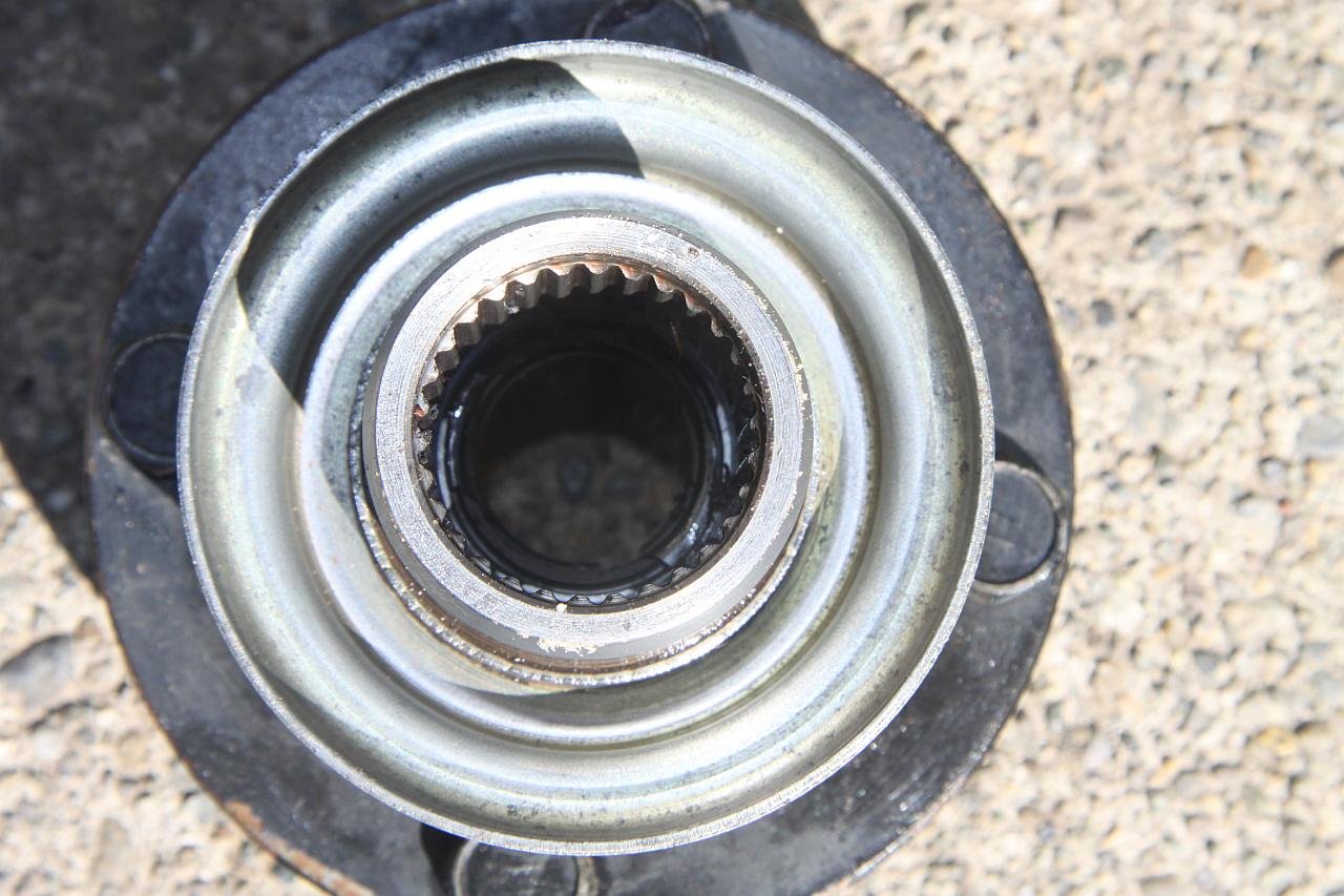

    @Speedytech7 Have you ever seen this before?
    Apparently there is a small bushing/seal on the inside of the companion flange. This is debris from it coming apart. It was dry tho, so no oil passing thru there.
    I didn't even know it was there. The last time I did this job, there was not this mess so no indicator it was even there. The FSM says its a single use item which I don't have ATM

    It's less Tacoma and more mod
    Is supposed to seal the leakage path through the splines. It wouldn't leak a whole lot anyway after the nut is on. Maybe have one ready in hand though just in case. Pretty sure mine was dry too, and shredded. It doesn't leak to my knowledge.

    So the shredding is normal? Good to know but that's surprising. Kind of a 'right of passage' :rofl:
    I guess Ill call Toyota of Renton tomorrow to see if they have one. Thanks for the feedback.

    Guess what, it was the dust shield. :oops:
    Though, not where I'd expected. It was actually the part of the dust shield that goes "inside" the rotor, which was rubbing on this one rotor and not on the others (and they must be different on the Taco, b/c never rubbed on either of those).
    So anyway, I'll just go over in the corner and eat my 99% now. :anonymous: Glad I didn't put any more 9's on there...:rofl:
    Thanks @m3bassman and @Digiratus
