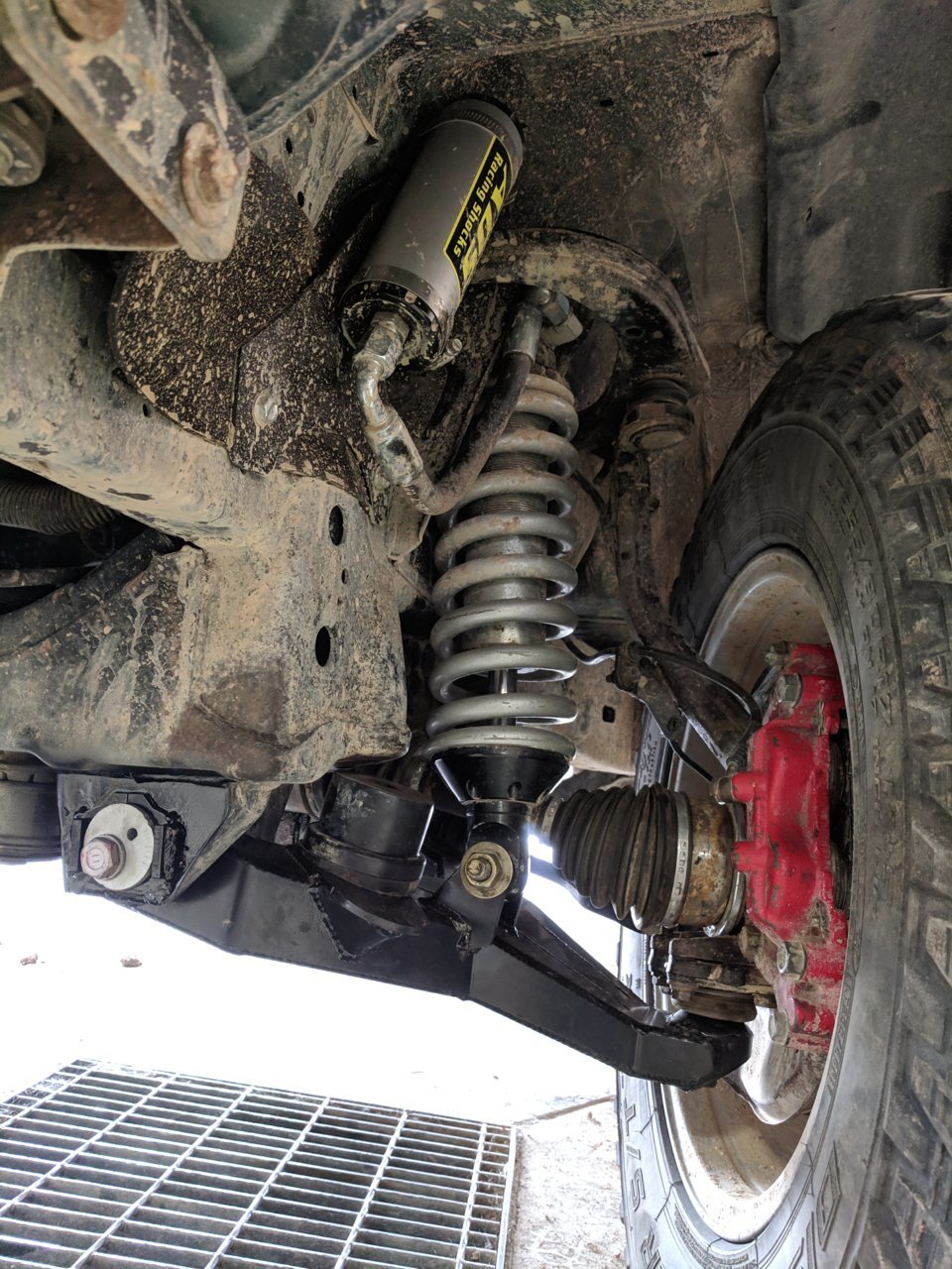

    Thanks. So I don't stumble through like I did the rear shocks, what's the right way to approach install/length determination? And, is there a "best practice" location to attach the straps in the front on our trucks? (Full disclosure: I haven't really even started to search/my research on TW, so feel free to tell me to do that or just point me to a thread.)

    On the stock lca the sway bar mount is a perfect strap location. You'll want to use a clevis upper mount so so can adjust the strap some and hopefully take up slack as it streches a bit. You won't need a very long one. Like 5" I think. But all you need to do is measure how far your shock pushes every at full lock out. From there do 3/8 or 1/2 for your strap.
    Right below the front brake line on the frame and towards the rear of the truck is a nice spot just above the rear bump point for the clevis mount. I'd plate the frame where you plan on doing the mount.then should be a pretty straight shot to the lower.
    I did this on Marc's truck but haven't done it on 1st gen. Though I mounted straps to Frank they don't have the upper clevis mount. But I have them to replace the old uppers so I have adjustment.

    I'm using 8" straps attached to the sway bar mount. There's not much science to it aside from putting the straps in a place that they won't be in the way, and accounting for the stretch of the strap.
    Next set might be 7" as I'm right at the end of my adjustable clevis. I'm a little concerned about the strap getting mangled at full compression if I go that route, but I could switch out my solid clevis setup to a spring on the bottom, or move the mount on the frame up.
    @jubei just finished his setup and it's cleaner than mine. Should be in the last few pages of his build. He cut off the sway bar mount and put a double shear tab in it's place. Probably a little nicer setup that allows you to keep the strap more in line.

    What kind of spindles are those? You just beef them up or is that an aftermarket dealy?

    Factory spindle with total chaos gussets. Going strong for over 3 seasons now of me beating on them.

    Hmm, that looks like a good idea, have to look into those or Fab something up with the scrap I have laying around.

    Pretty sure I paid around $30 for them, might be a little more than that now.
    Don't know how you value your time, but I couldn't come close to making a replacement for that price.

    Yeah the spindle gussets are worth the price. Plus you have to massage them anyways to get them lined up perfect anyways

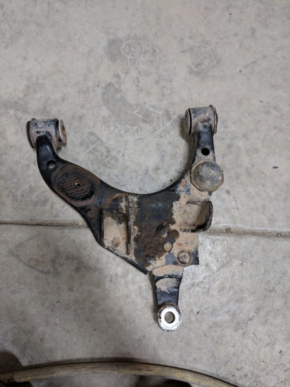

    Have a lot of photos to post. Plan on doing a bit of a write up as the cam tab gussets took more work than I thought they would and figured it would be good to share. LCAs are nice though. My alignment is great now. Moved the wheel 1" forward so no more rubbing either.
