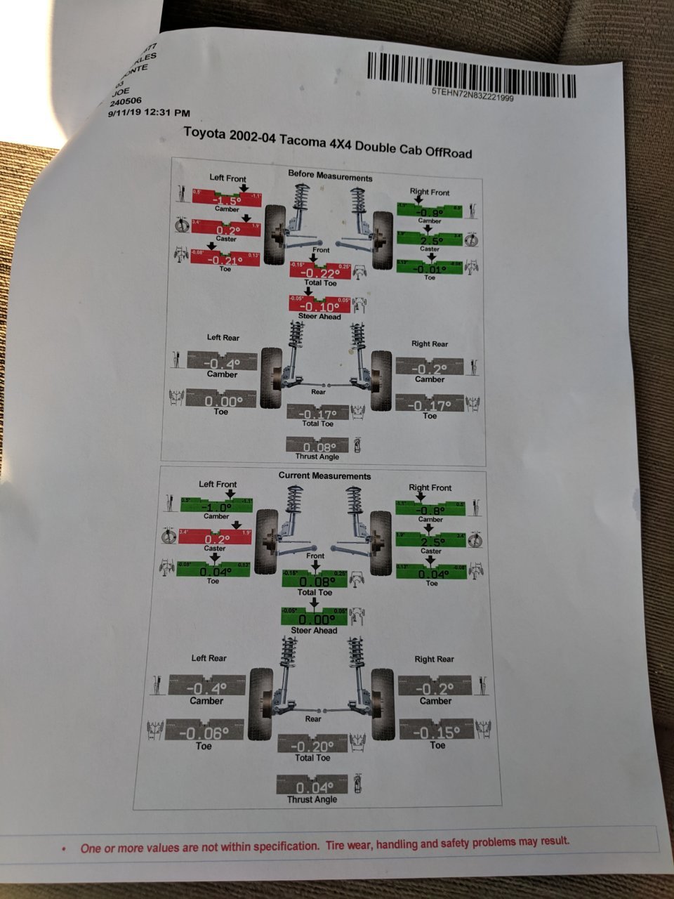

    Tire shop is claiming most of my front end components are shot on Igor...
    I know the tie rods and LBJs have about 50k on them or 60. Was planning on replacing the LBJs this fall. i had check them for play before Canada and saw no movement.
    Uppers might be near shot but had planned on replacing those too.
    LCAs are brand new obviously.
    Little annoying to hear. Not sure how true it really is but whatever.

    Do you trust them? Sometimes shops will say stuff like that when their main interest is to bolster their cash flow. :rolleyes:

    I'd definitely check things yourself. I've had them them tell me that before so I ordered the parts to do it and it ended up being play in the rack.

    Picked up Igor this morning. Should left it. Short drive home I think they made it worse..
    Something must be bent..damn

    Yeah, something ain't right with that driver side LCA or the mounts for it.
    edit: Your still on stock uppers correct?

    Then the 2.5 degrees of positive caster on the passenger side is mostly coming from your new LCA. Very curious that is isn't the same way on the driver side.

    He can still have some caster input from the way the cams are adjusted, you can achieve almost 2.5* with that in a perfect world.

    That's a shitty alignment.
    Swing it by my place on your way down and we'll see if we can do better.
    But if you cams are maxed/frozen, I'd say you have a bent spindle.
