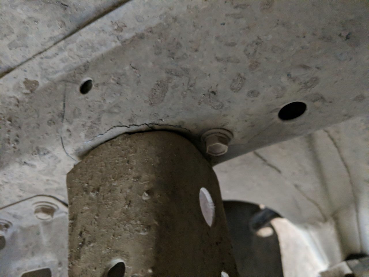

    It's less Tacoma and more mod
    Me: *walks to Land Cruiser to look for cracks*
    LC: *is covered in snow and suspension is covered in grease*
    Me: "I'm sure it's fine" *laughs in double wall boxed frame and gusseted link mounts*

    Ah I see it now. Yikes. Could've been you and Mike haha
    I think his started where Brett's first crack was
    Then just went to shit from there.

    Beef up the bed crossmembers if you can.

    Don't need one. Mine are like that on Frank. Scared to look at Igor.
    But that's the mounts not the cross member.
    Cross member and boxed frame will mean less frame flex and more energy through the shocks. Not a big deal for you since you're not using custom valving and tuning your shocks.

    I think one could buy some 1/8" C channel that would fit over the stock channel and just stich weld about 6" at each side by the mounts.
    Only pita part is drilling a hole for the bolt. Actually though I'd drill out the stock nut since it's spot welded and breaks.(3 of mine have) and just super weld a new nut on the 1/8 360° around it. Then it'll never come off.

    That "camper" doesn't weigh any more than your rack and tent. And both of you guys have a reasonably light load back there (compared to the rest of us) otherwise. I think Brett said he was around 4800 lbs, below where I believe you were when we weighed ourselves earlier this summer.
    Edit: By the way, I think you're plan to paint everything back there is a great idea. I took the opportunity to do that when I had my bed off, and it's still great.
    If you don't mind spending the time, get a cheap ($15) sand blaster and some sandbox sand and use that to strip the paint in places that are hard to reach. Worked a treat for me, and was just an investment of time really.
    https://adventuretaco.com/dont-skip-leg-day-reinforcing-the-rear-frame/
