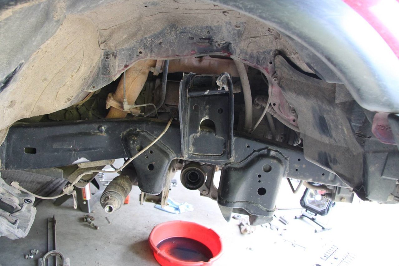

    We will be, at the very least, lifting the motor up far enough the easily assess everything. Makes sense to replace the perches and motor mounts. The question now is which perches to get. Any thoughts on that?
    edit: Are DMZ fab anf New Venture Motorsports the only reasonable options?

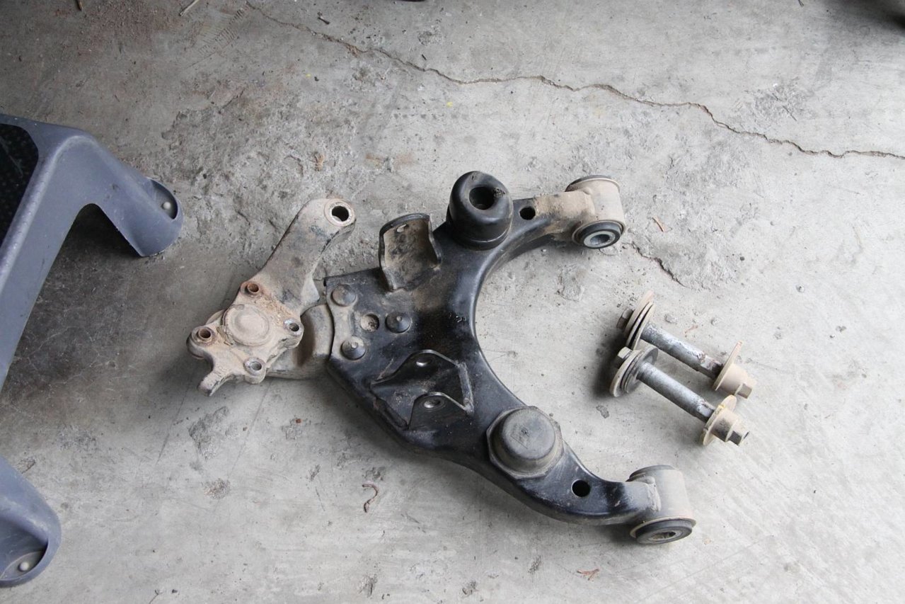

    Yes, a few more discoveries. We worked all afternoon repairing my LCAs (both sides) in several places. At some point I will start of thread detailing that process.

    Yes only options I'm aware of. Brett did the new venture ones. Dmz come welded together I believe.
    You will have to pull the motor no matter what to install the new buckets. Just remove it and get it out of the way now.
    I could see the white lines tweaked already too looked like. Was their cracking there?
    I'm doing my lbj too. Have 60k+ on them and seem fine but over my 50k rule and it's been 3 years so it's time.

    Yeah bushings looked crooked from being forced that way.
    And I haven't. I have seen several guys use the dmz ones. On Brett and on other guy I've seen use the others. Not sure one is better than the other. I was going to go with dmz.
    And again you literally won't be able to get it out without the motor being a giant pain in the ass. Not sure it'll be possible really with it in there..not well anyways.

    The weld is too far down and along the frame to do it with the motor in.
    And I bet the price difference is due to the dmzs come welded together. So you just mount them. Are they the same material thickness?

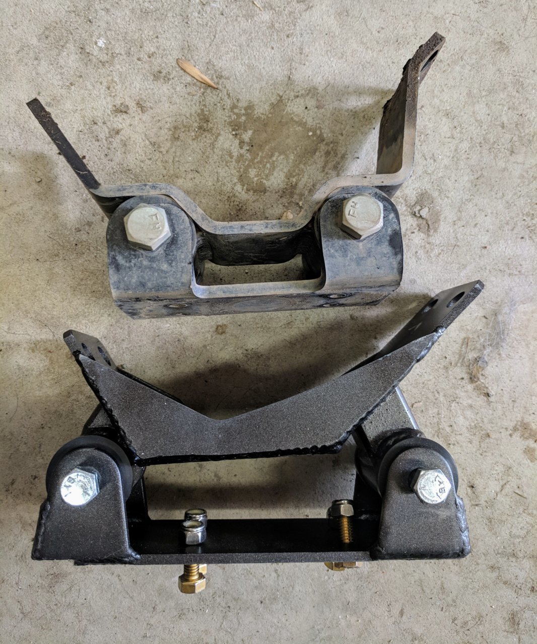

    What was the name of the guy that was making motor mount assemblies here on TW. I think you bought some from him IIRC.

    @Bonzen makes motor and tranny mounts. Only person I've seen that makes a beefy drop in auto transmission mount. A set I think of motor and tranny mounts is like $700 bucks. Not cheap. But very stout as it replaced the full brackets and mounts unlike the trail gear mounts which still use the stamped metal brackets to the block.
    95-97 used cast brackets so that's not as big of a deal.
    Welcome to race truck parts status...gotta pay to play..

    TG with a cast bracket. Stamped is thinner.

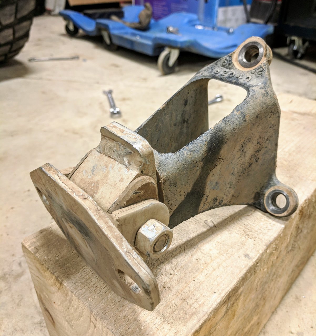

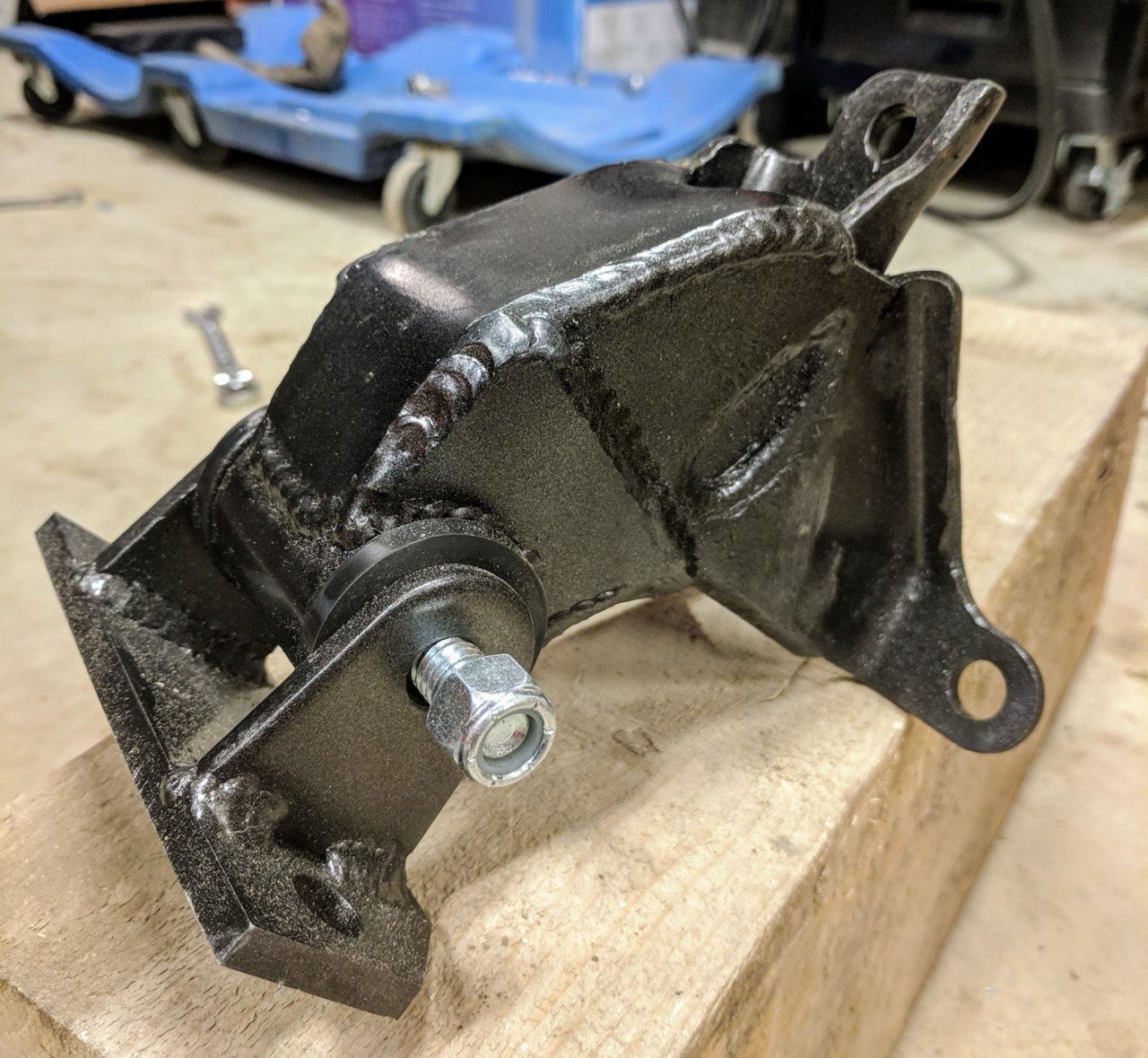

  18. Oct 7, 2019 at 12:16 AM
    Blackdawg
    Blackdawg [OP] Dr. Frankenstein
    Dec 31, 2010
    #48500
    81,606
    Monte
    Wyoming/St. Louis
    The Trifecta of Taco's
    This is my tranny mount. Top is 4xinovations which is a nice mount really. Bottom Bonzen. But this is for a manual and 4xi doesn't make one for the auto.

    Lca wasn't thick enough. The threads we're bottoming out on the lbj stud. Haven't called solo to ask about it yet.
