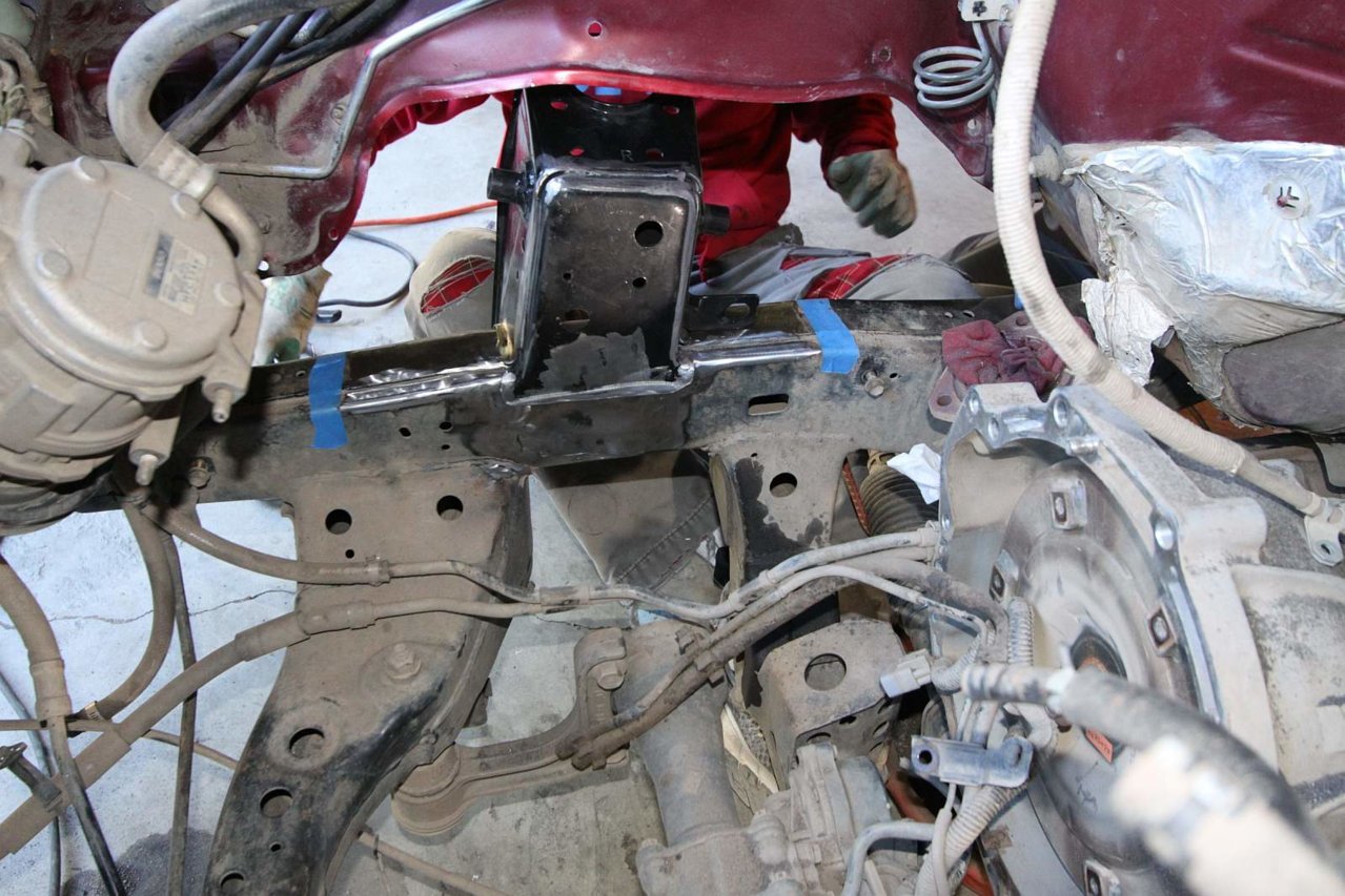

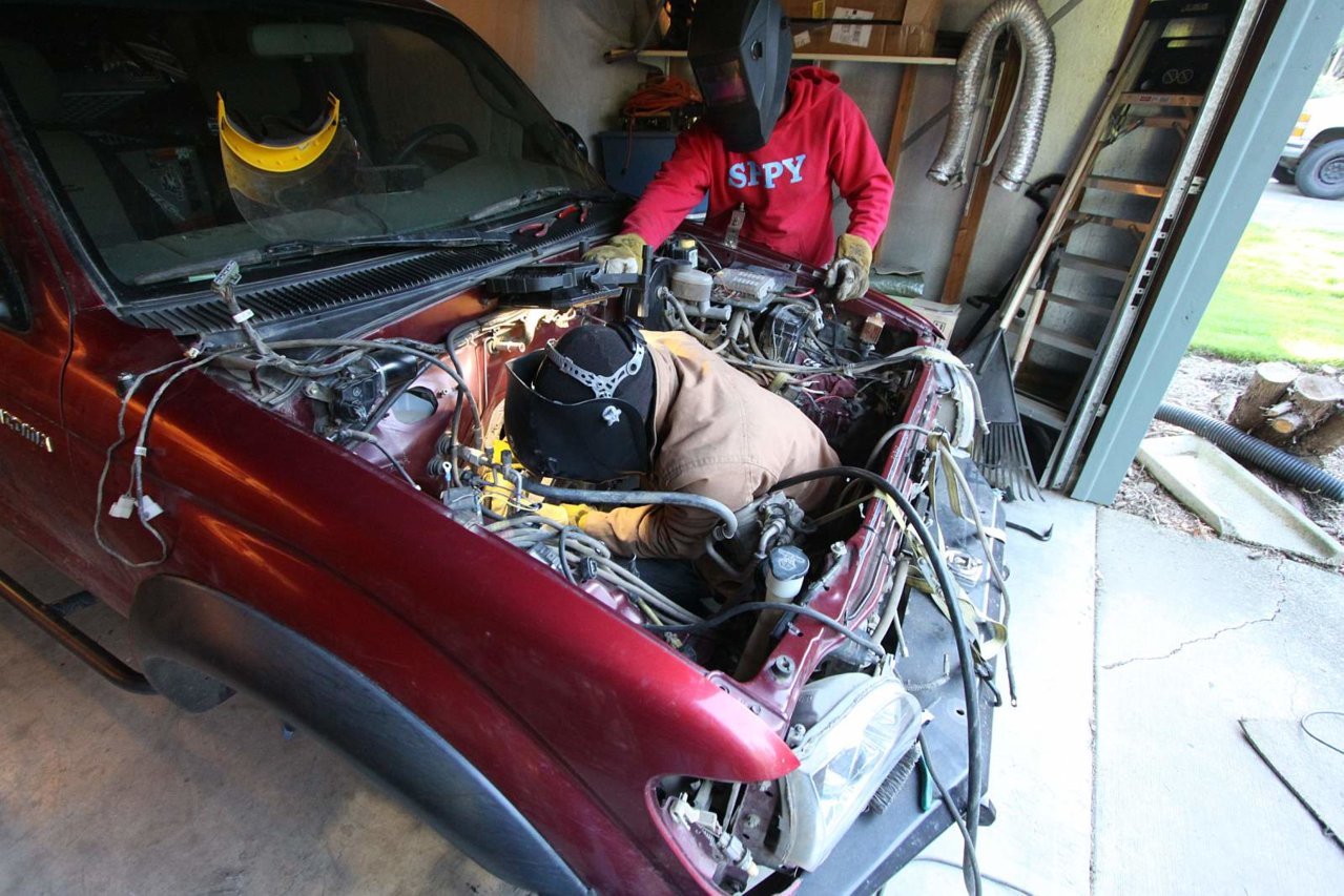

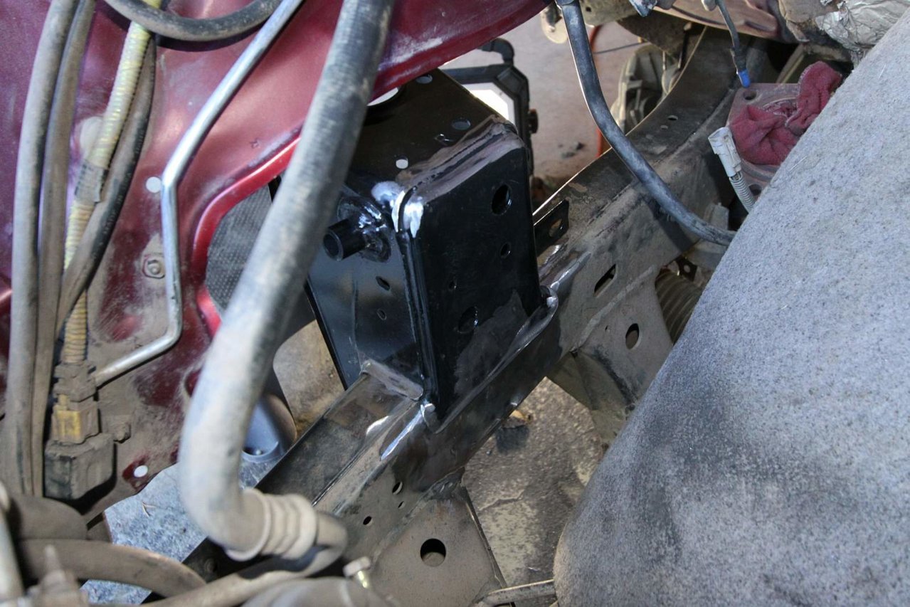

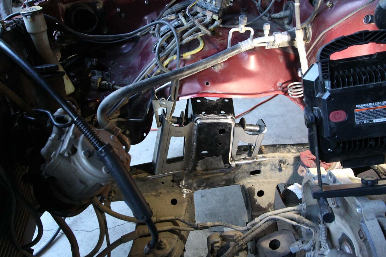

    Made a lot of progress today. The shock towers are burned in.
    And speaking of gussets...
    jubei, turbodb, BossFoss and 4 others like this.

    Nice work!
    That brings back memories of how uncomfortable it was sitting on the front diff welding shit in the engine bay.

    Should be able to tack inthe perches next Saturday and do a test fit. Then burn them fully in.
