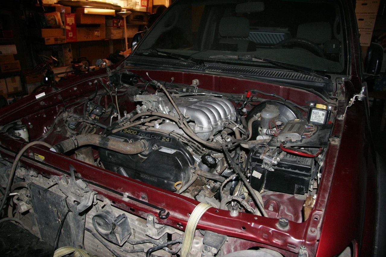

    Made some good progress on the redhead rebuild today. The motor is back in and mated to the trans. And everything fits...sort of.

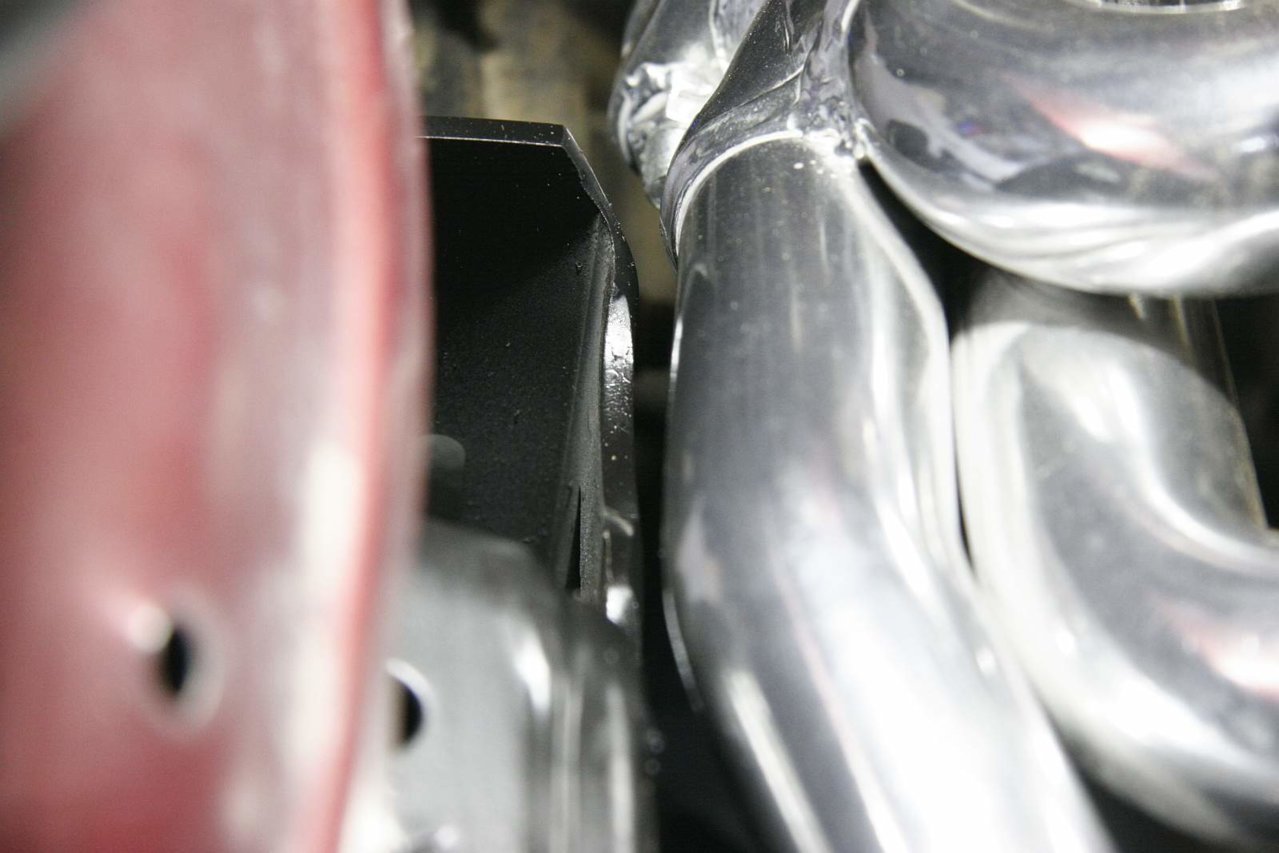

    The clearance on the passenger side between the headers and the TC gussetts was too tight and required modifying the gusset in two spots.
    Seen here:

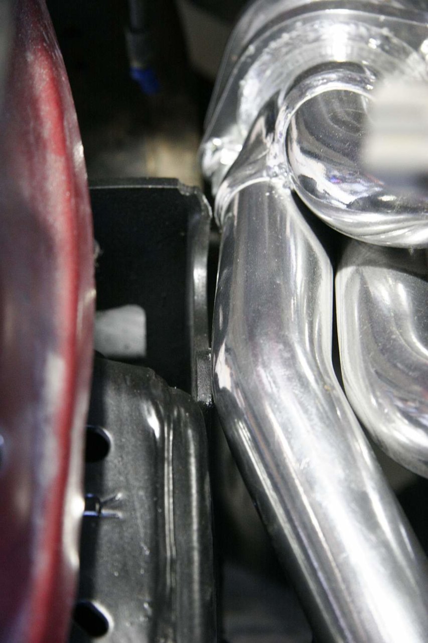

    After cutting off some of the gusset things were much better with at least a 1/4" gap everywhere:

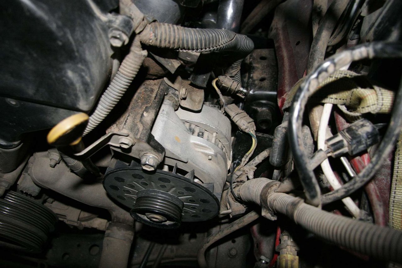

    The gussets on the driver side also created an issue that is yet to be fully resolved. Apparently, TC never anticipated anyone using these would also be using a big diameter alternator like the CS144. It's hard to see it in this pic, but the alt case is right up against the gusset.
    I am going to try a shorter drive belt to pull in the alt a bit to see if that will work. Otherwise a smaller diameter alt is in my future.

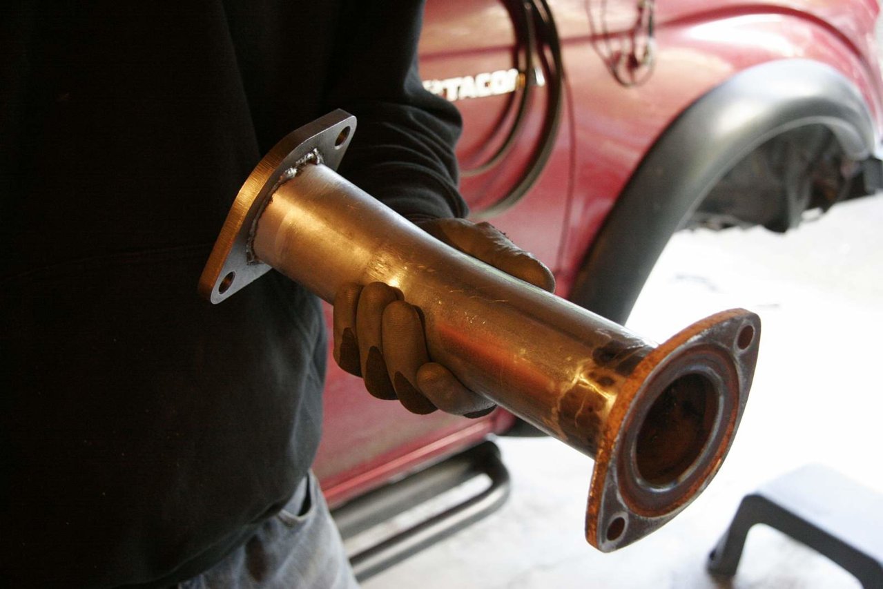

    We also started work on the exhaust system. This pipe section will replace the upstream cat.

    You're probably going to want at least 3/4" of clearance on the passenger side. If you're still using rubber mounts they allow quite a bit of movement. I have a bolt through my driver mount to hopefully lessen the rotation of the engine but I still get quite a bit of movement. Called the MarMount mod. It does add some vibration at low rpms but nothing unbearable.

    Well that put a damper in my plans. I was just getting ready to order a set of gussets for my truck. I will have to check clearances when I get home tonight...
