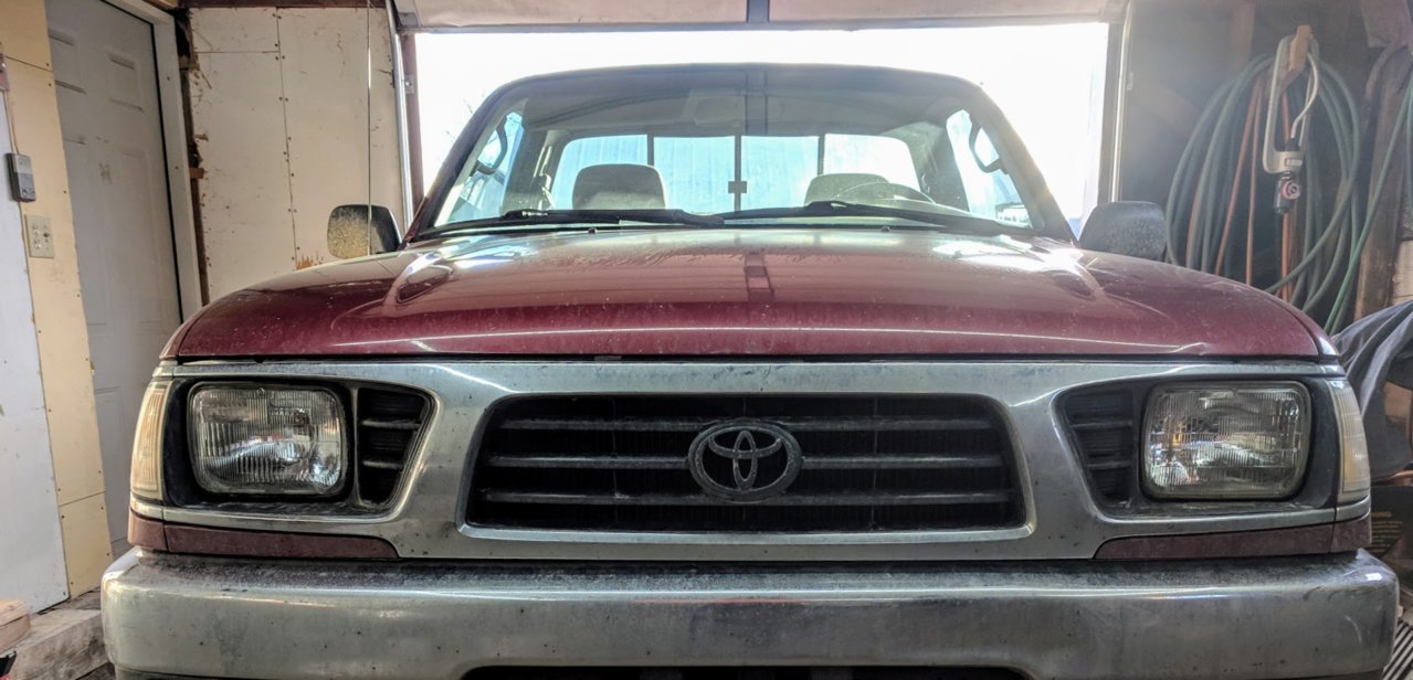

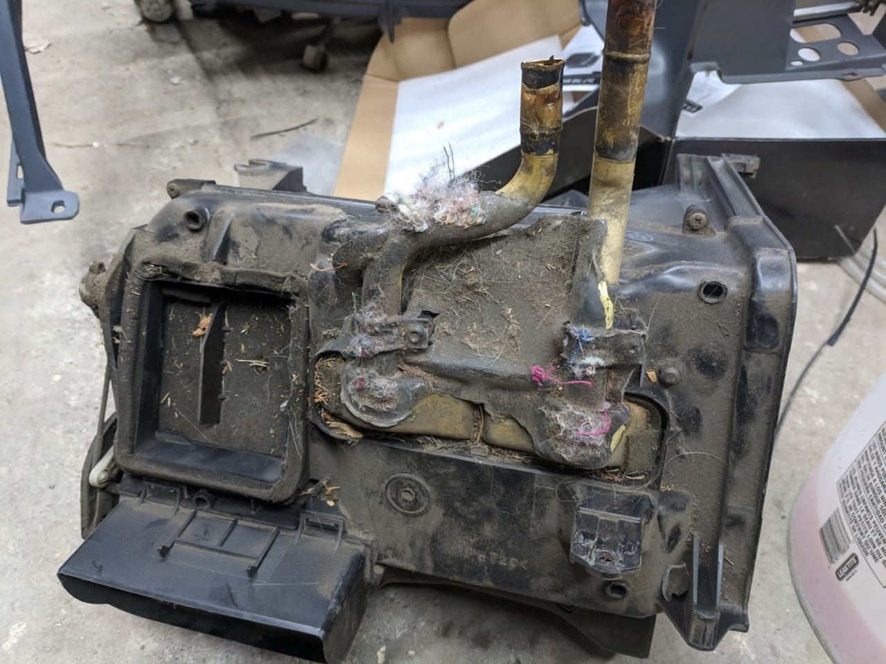

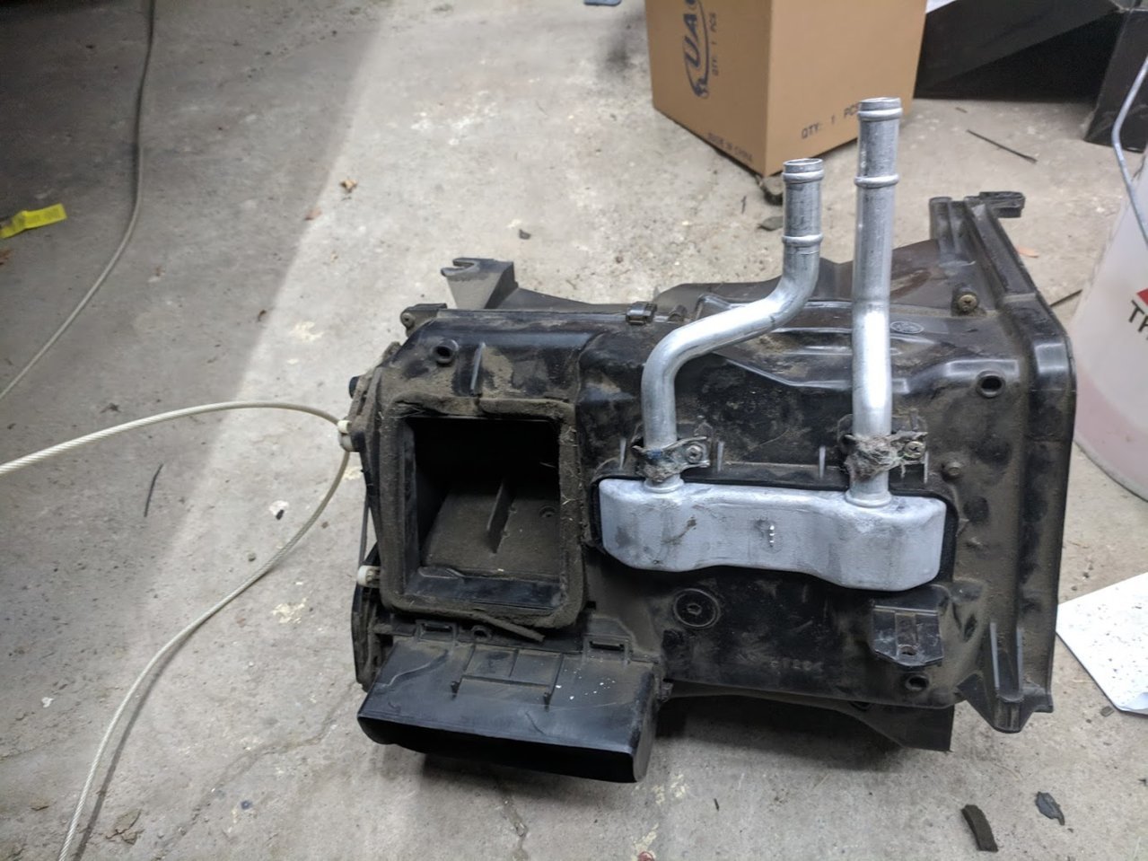

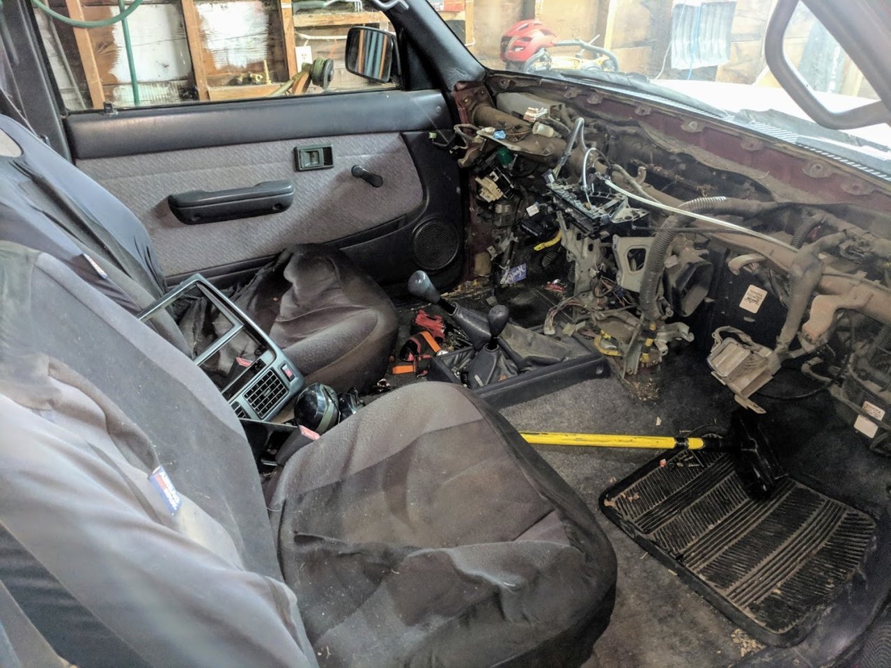

    Got the DD up and running again.
    Hhrw-OvNYGT0WDThagkRf9pHbI_MiQjRklaodBFu_da9da14338b3947c708f348c5e1b4c811ceeb461.jpg
    OdqD8-Y8V7kpyMc75jbcj60h0YVoPBMtC6efX_aZ_83cf7845f39da2249f81e21e86dd6b80f79e4d49.jpg
    1I80cGYMXXnxCtOhfNF0W5vYpVsEefabptkAEDOM_ab489bfedb44775d096a7b6a8f5815eea07482f8.jpg
    Then after the long boring process of flushing out the coolant..

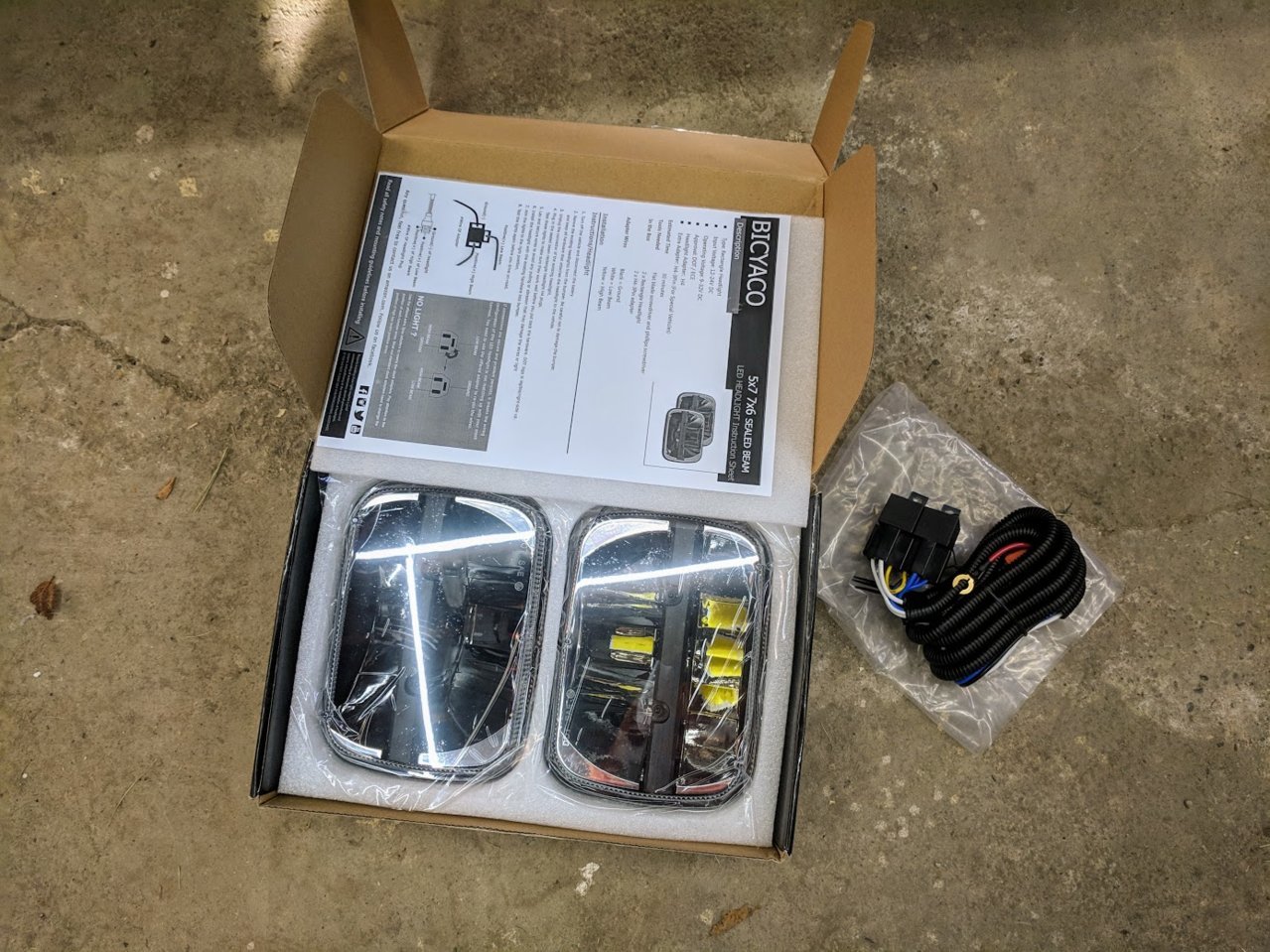

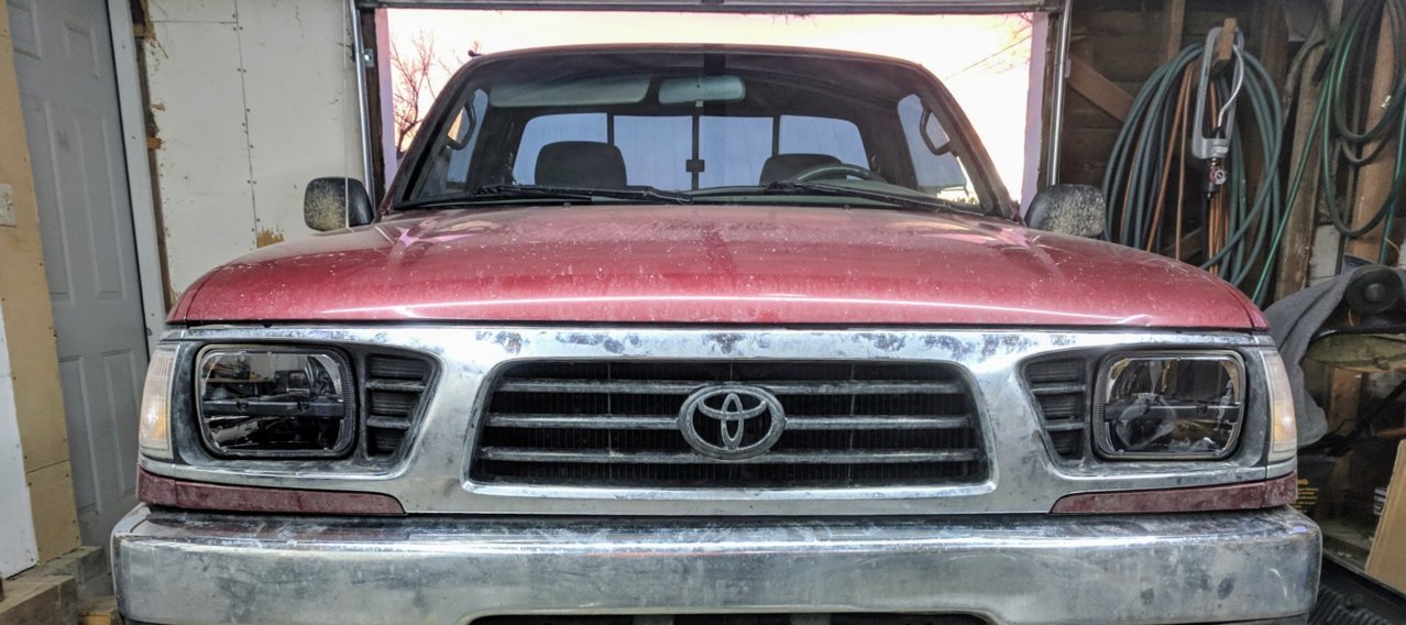

    And also upgraded the headlights to some 5x7 LED lights.
    E8oZoIv0X1fpFQxAbPhL65ATUnkghvx91wo_Njgo_3bfbf9704f4b6d6d03634bb21e4b26b9f655cb70.jpg
    hxHxks85QYwZnbi0NxDFEdFCBCxoXk6cBvSoZKbM_3cdf0b6a99990ebc53e3e89a4fde778bbbaa64c2.jpg
    EtF0aFxUgNVZyJd2T_8d4iMKCqLWu4lRg8G33Oaf_2f66816ae793216fc70765c8616b68cedbfef8d9.jpg
    Got to test them tonight. They work awesome. Cut off isn't ultra sharp but still very nice and never got flashed the whole drive. High beams are great too. Don't think I'll add fogs really and just get some ditch lights for the deer.

    Tell me a bit about the heater swap out. I think that's the piece I have to change as well b/c I apparently have a coolant leak there for my AC (b/c the coolant is being blown out through the vents).
    Did you swap out the entire black plastic thing, or just the metal piece that looks to be buried inside it? And, can I do it by just removing the glove box, or is it full dash like you?

    Just the metal piece swaps out.
    However...is coolant being blown out? Or refrigerant? because if its refrigerant for the AC which I think is what your issues is given a vauge recollection of a conversation on the last trip..you don't need to put the heater core. You need to pull the exchanger out which is super easy compared to this.
    All you need to do is remove the glove box(2 screws) then the lower cross bar of the glove box(2 screws and a bolt maybe). From there you're looking right at the AC exchanger. Its the part between the Blower motor(all the way on the passenger side) and the heater(dead center).
    You won't have to pull the dash at all.

    Just Amazon. https://www.amazon.com/gp/product/B074LT5B1M/ref=ppx_yo_dt_b_asin_title_o02_s00?ie=UTF8&psc=1
    Zane recommended them. They work nice.
    yeah I know that. But there is a nice cut off really. much more so than any other light I've had. So that's good at least.

    they are bright. But still going to add some pods for the deer. Still makes driving a night much better. It's just nice that when Im on low beams I don't feel like im blind when passing oncoming. So that's nice ha

    That said, these are in fact designed correctly, they aren't just a random LED bulb in a H4 housing. They do work as they are supposed to like a real head light. You can see the large divider in the head light. The top section is the low beams and the bottom is the high beams.
    I can still tell when some jerk just slapped non shielded LED bulbs in his lights. Its terrible. But with the way the projectors are these days..they aren't any better honestly. If you're below the cut off..you're fried.
