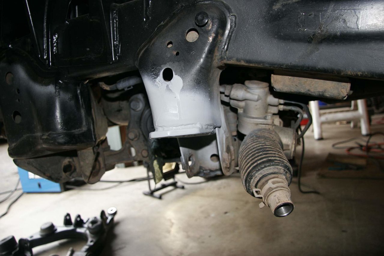

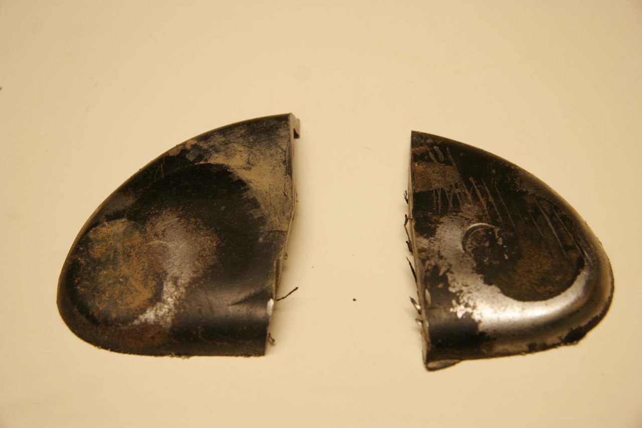

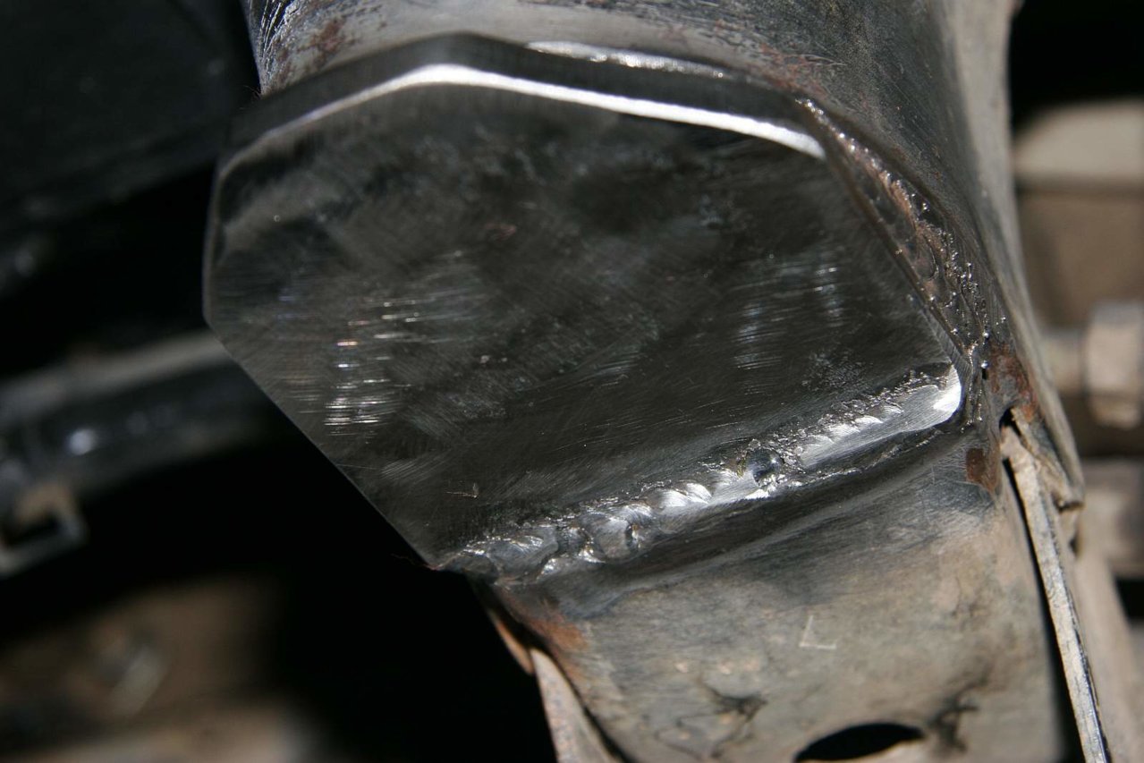

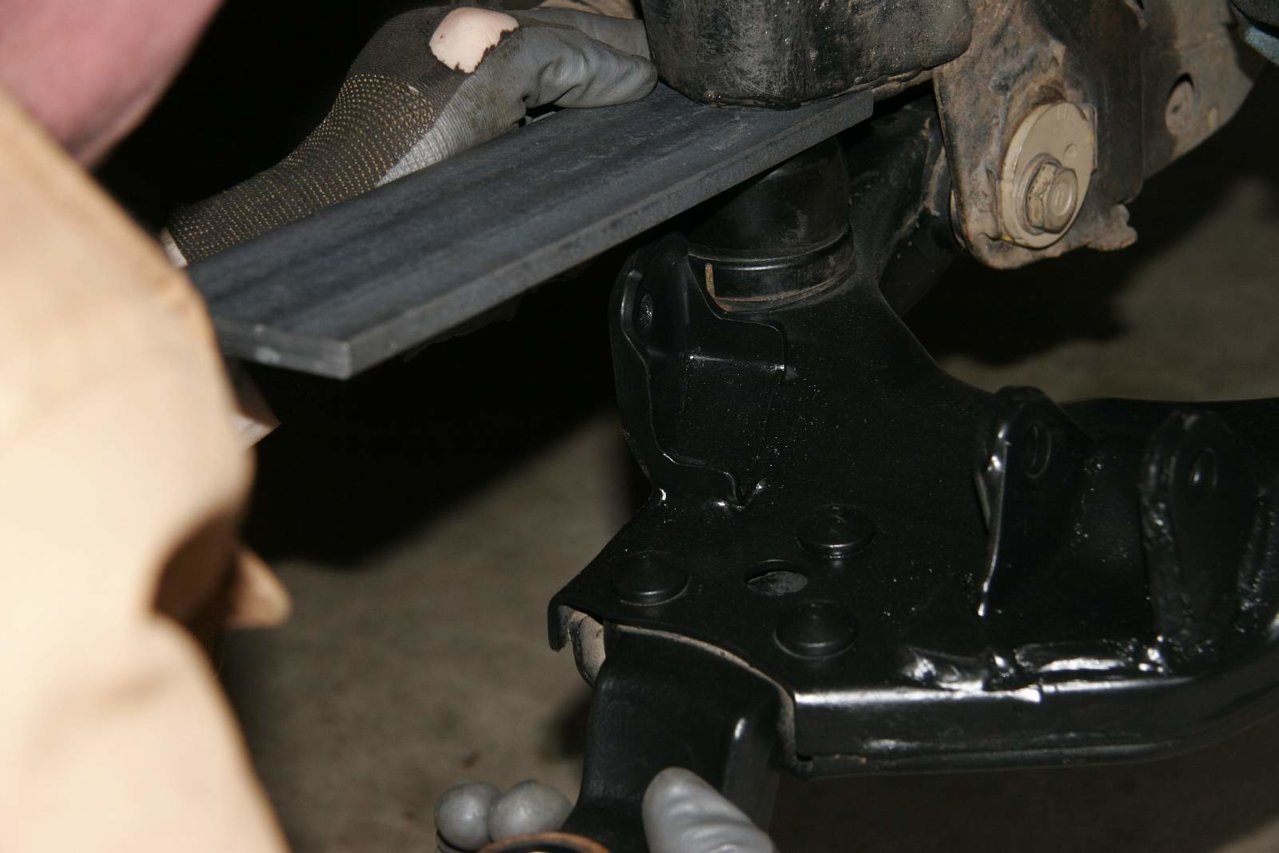

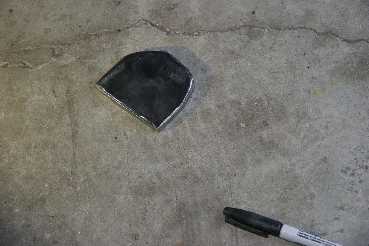

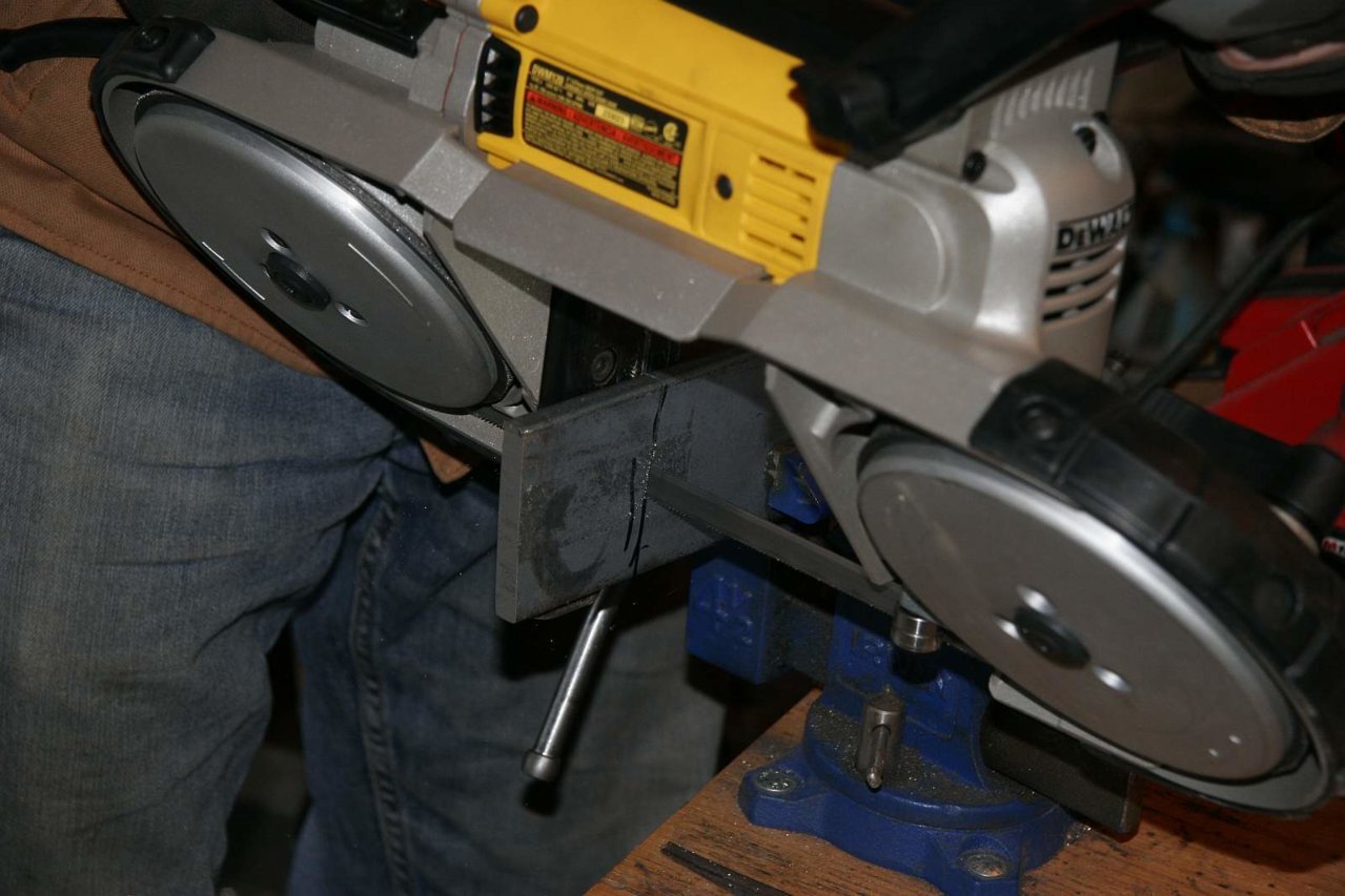

    Got a little more work done today. New strike plates and LCAs are installed and the steering rack is reconnected.
    Now the bumpstop hits squarely and fully.

    Damn you really did put a dent in the old strike plate with the bumpstop bolt. Somehow I think bumpstopguy's intent was to have the front bump completely stop travel before that happens.

    That was the passenger side. Pretty sure that happened coming off the trail where that coil bucket failed.
    That was a long, steep and rough downhill. With the coilover removed, all the weight was on that corner bump. I am sure the bolt that holds the bumpstop to the LCA is deformed too from all that pounding. And we know that the bump was not striking the plate squarely. Now it won't have that problem.
