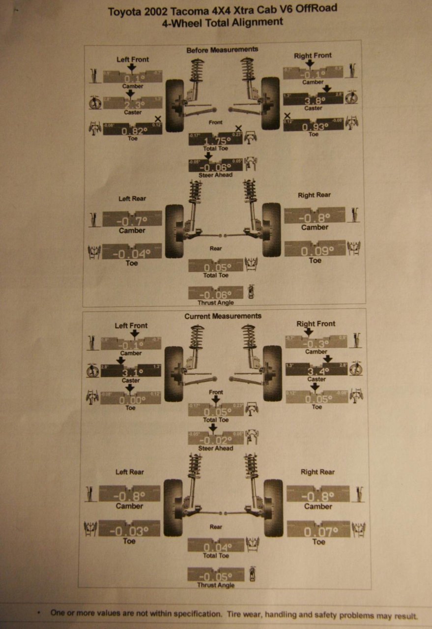

    Also, got an alignment today. The spec sheet below shows that the toe was out but everything else was remarkably close considering all the things that were done to repair the truck. Nice work guys.

    Super awesome to hear it's back on the road. Perfect Xmas present ehh?
    Since we had a lot of hoses off, I'd start by looking for a vacuum leak. Seems like the most likely culprit to me. Smoke test is reasonably easy to do (I've got a homemade tester I used when looking for my P0171 cause, if you want to use it) or you can do the old "spray starting fluid in the engine bay" that Zane suggested for me :). After that, I'd clean the throttle body, since it could have gotten gunk in it; then start looking at the IAC valve.
    Wow, that's really great considering all the work.
