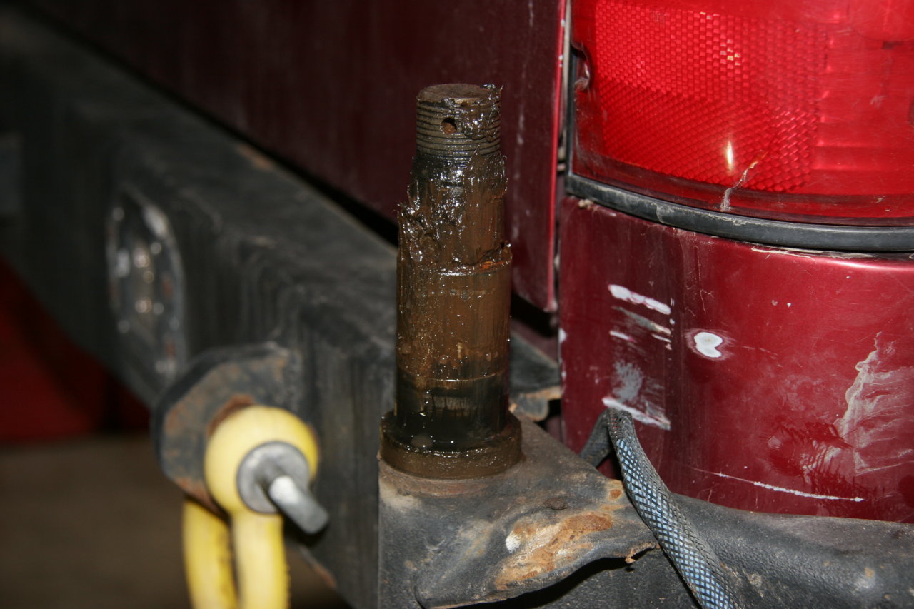

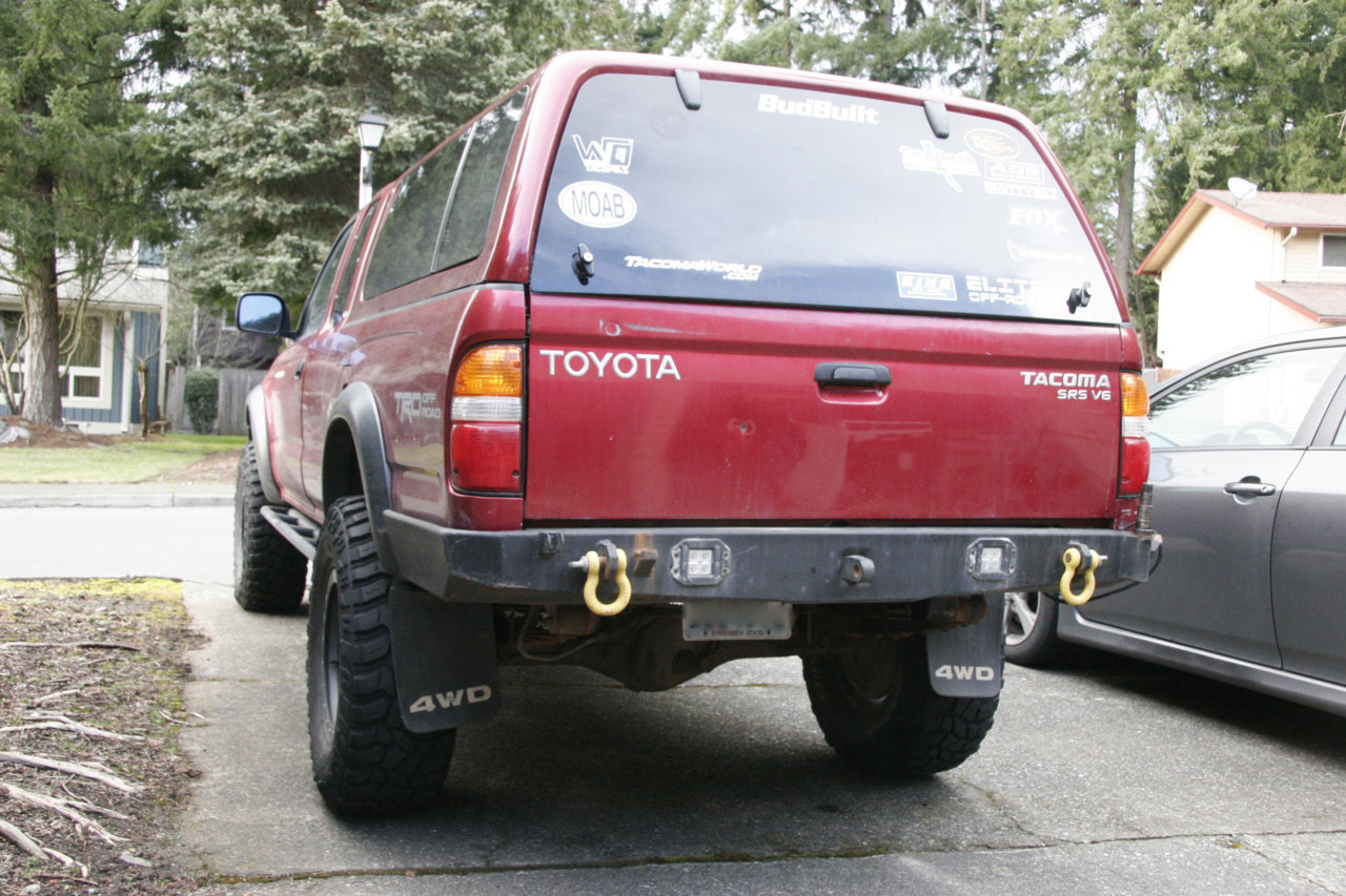

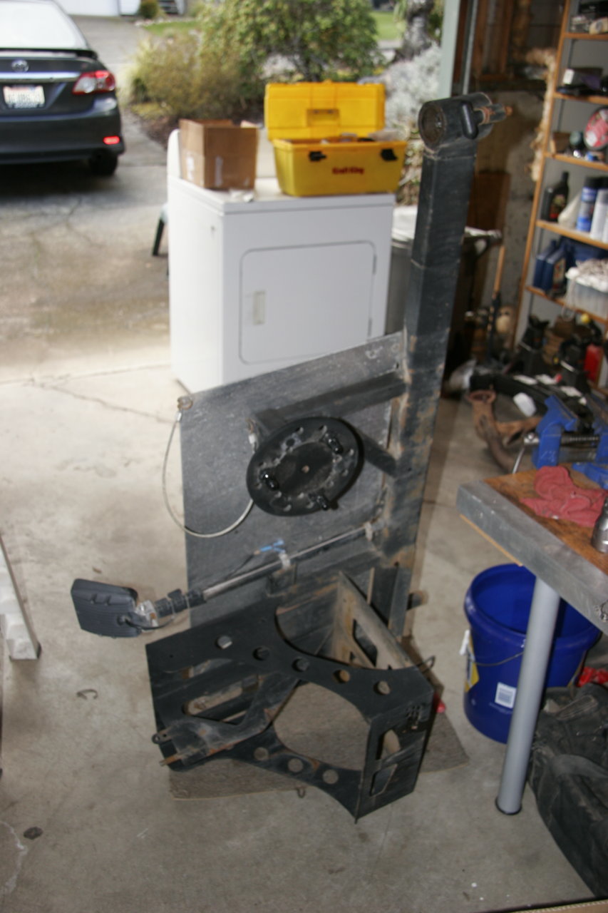

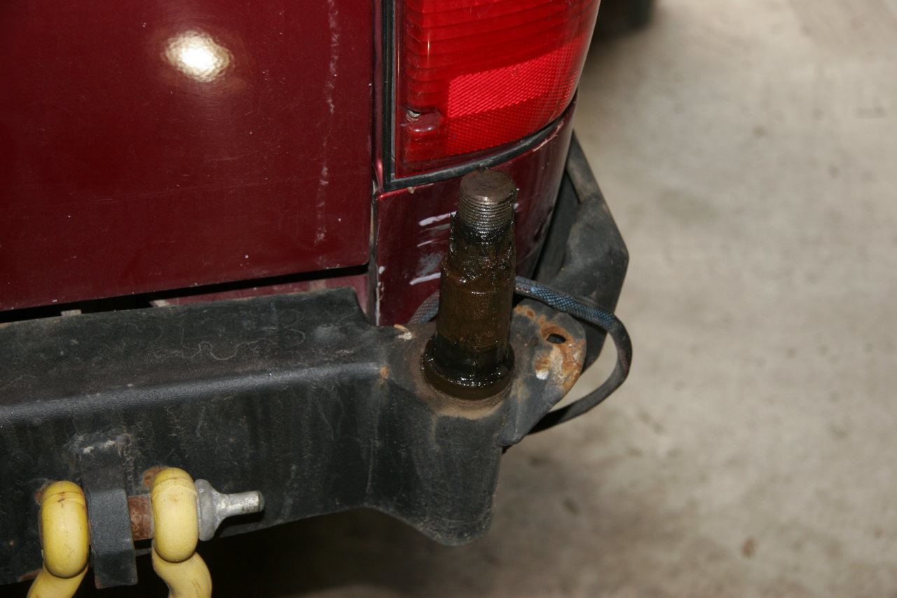

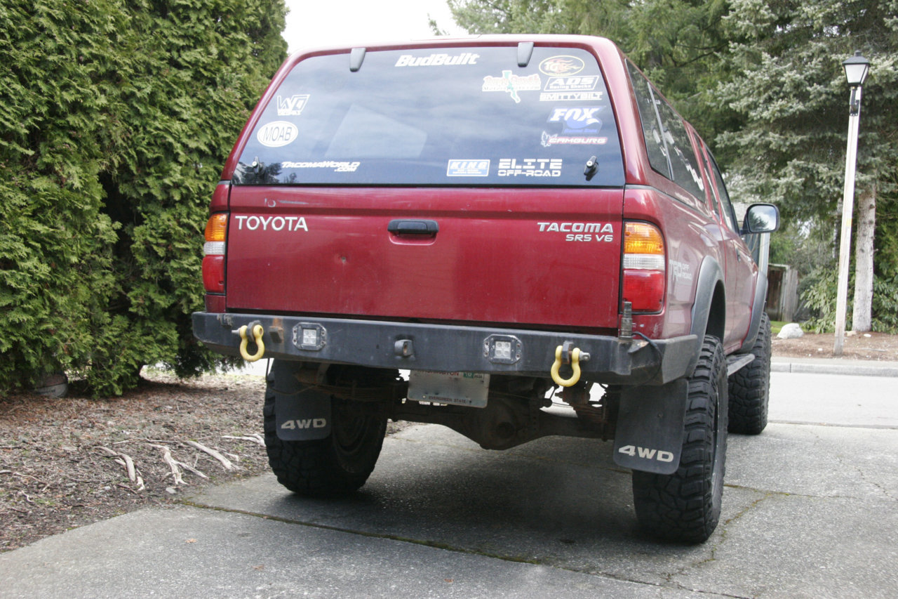

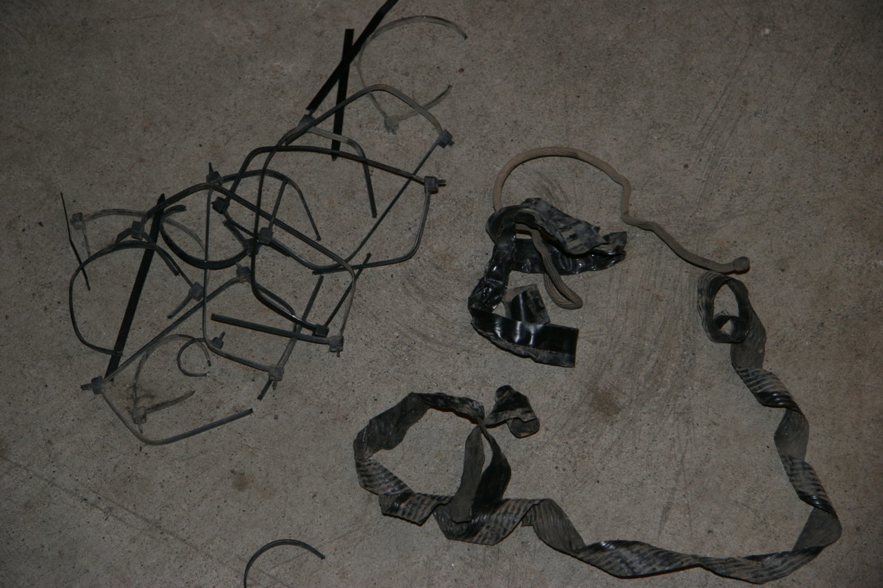

    In the spirit of weight loss, the redhead has started to shed some... :p
    Sure looks like that bumper is bent doesn't it?

    Well that would explain a few things...

    I didn't see it until I saw the pics. It may just be lens barrel distortion but seems unlikely. Probably need to put a straight edge on that main tube to be sure. I'll take a closer look at it tomorrow.

    Yeah, given that your swingout used to be straight and now...not so much, I'd say that's a prime culprit.

    Nice rebuilding it?

    Pulling the swingout is a temporary thing. Taking it off will make it way easier to take the bed off :anonymous:, plus I've needed to redo the bearings in the spindle for a while.

    If the tube is bent, not sure what can be done about it.

    It's that open plate design, just doesn't have the moment capacity or torsional rigidity of a closed tube shape. Would need some pretty extensive surgery to straighten the bumper.

    Dual swingout is the way to go.
    And how close is that to the body normally? Wondering how much it moved to cause that dent under the taillight.

    Yup, open channel tube.
    Yeah, figured as much. :pout:
    That trail damage was already there from before the bumper.

    Super tight. But didn't cause that.

    Frame could possibly be tweaked too

    I don't think the spindle on the bumper was meant to be used as an anal probe...

    What would you say about drilling some holes through the bumper face and bolting it down on a known flat surface, heating it, welding in close off plates, and then unbolting it after it has cooled. That's probably what we'd do at work, actually we do it a lot with bent stock, sometimes cooling naturally and sometimes with just a tiny bit of heat and a quick quench. Then afterward it would just be a matter of welding the holes closed.

    That could work, you would need to reinforce it afterwards as the steel has already yielded.

    I don't think you could do that as there isn't a lot of room there. Might be able too but would be like 1" or so from the plate to box it in before you'd hit the bed.
