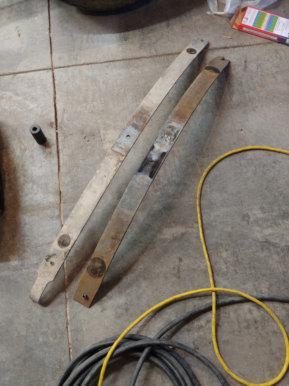

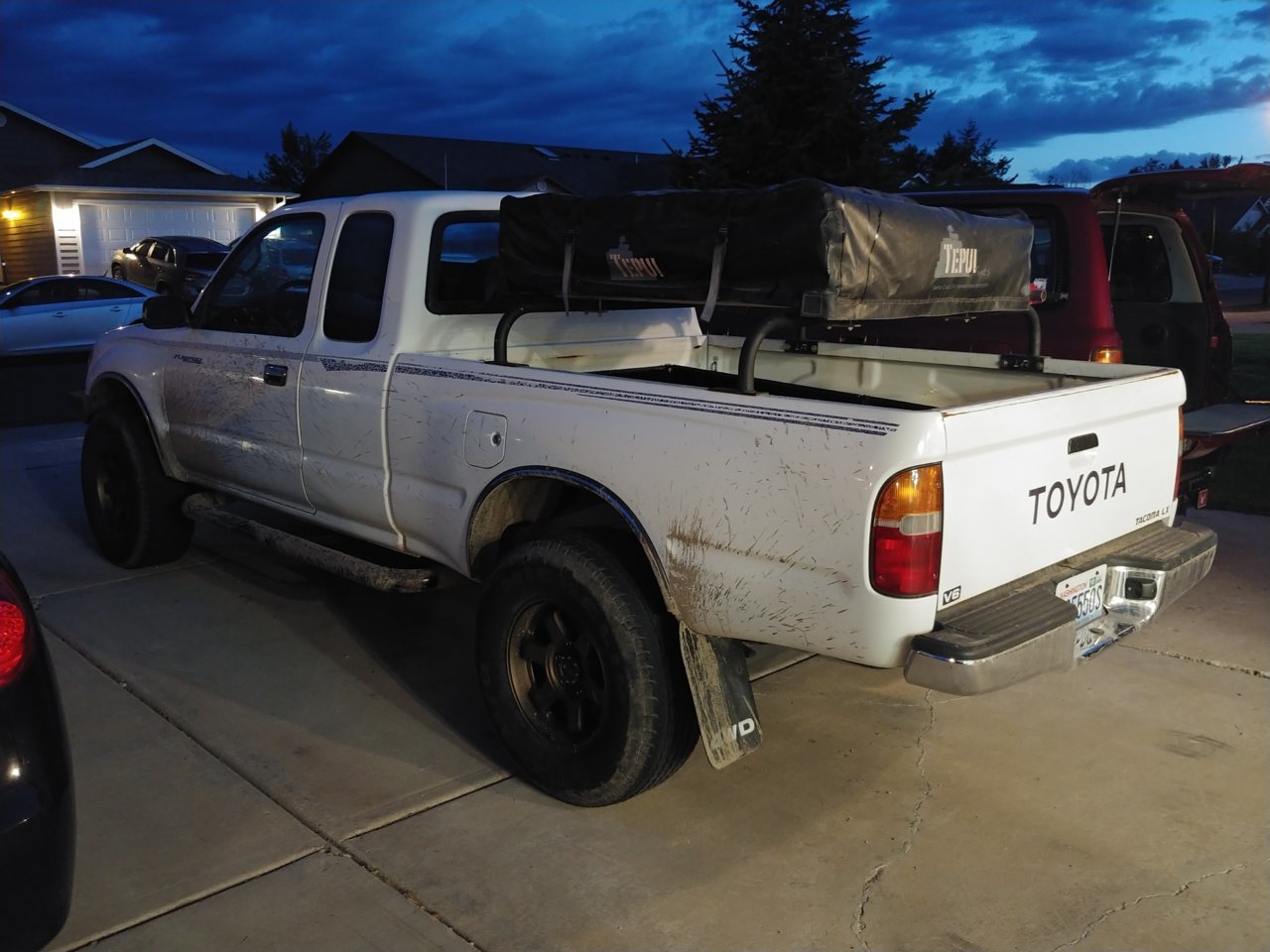

    Got my redneck leaf pack constructed. One Dodge Dakota leaf per side (perfect length for Toyota springs if it's a 3rd gen Dakota) gave me a solid 1.25" lift with my tent on and bedslide installed. That's considerable for a single leaf change per pack. I stole another leaf so I can match the front LT for a short time when I'm in between being able to afford the leafs I really want but I didn't install that one yet, would've been a ton more lift.

    huh good to know. Right width too?

    Yup 2.5" on the dot, they're perfectly off center for the center bolt just like the 1st gen leafs too.

    nice. I'll have to remember that.

    Can actually thank @rybern for that piece of info. He was doing the OMD leaf mod and stumbled across them. I just got lucky that they had a rather clean Dakota in the yard today, $22 and I'm back on the road better off than before.

    Nice. I need new leafs for my 95 and want to put the old kings on the front. Not looking for a lot of lift but I bet just one leaf will do. I use it to haul stuff now and then anyways.

    Worth noting, at least I'm pretty sure it's due to the slight lift. That there's a noticable vibe now, the new arch to the leafs may have moved my pinion angle a bit. Only shows up above 65 or so. Still a minor concern all things considered.

    Could just be worn U joints or CB too Id guess. Is an old truck after all.

    True, showed up right after the work tho. Still could be what you said tho.

    I don't really have the time or the desire to open up the leaf pack and slip in some shims right now. But I spent a couple mins making these to drop the CB a bit. I think it's a drivelines vibe, occurs at 65-75 or so, but goes away under acceleration (when the diff rotates upward). So this crap fix should work. We will know in a little bit, need some longer bolts.

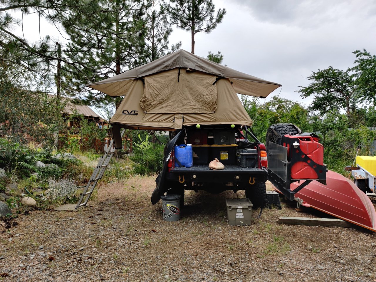

    Camping tonight at my sister's new place in Winthrop. Covid style visit. Haha
