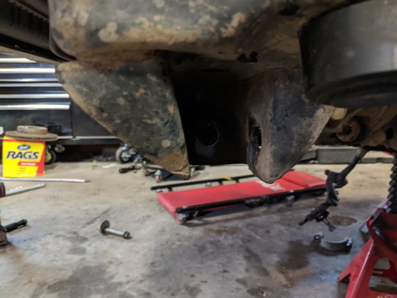

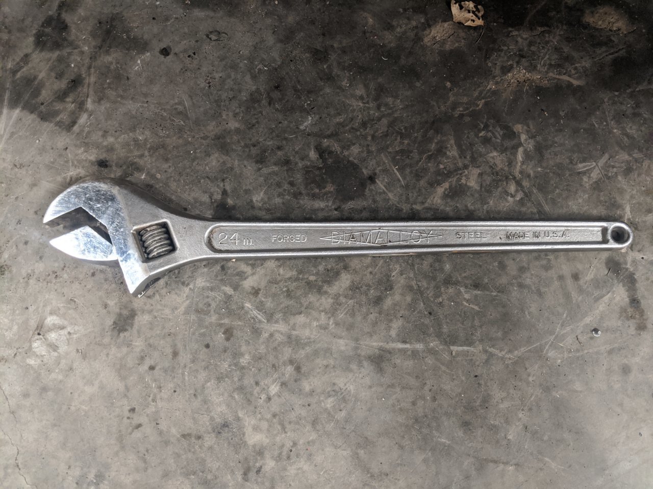

    Are your mounts all bent to shit? I had to take a giant crescent wrench and bend all mine back to get the new arms in. Also had to weld a little on those joints after bending then back.
    Right tool for the job.

    So rear mount by the steering rack. The two tabs that the cam/bolt goes there they bend, usually no an issue though.
    The LCA goes into the mounts but the rear mount, its like it should be a bit more towards the front and twisted. I can get the cam into the LCA on the front so could bold it all up. The rear though it gets hung up, won't go through the second cam tab slot, I'd have to twist the lca so it bent upwards.
    This makes sense given the crazy odd wear I was seeing on the cams in the photos I took/posted last night. The whole cam is being torqued up towards the front. This is caused them to bend and wear down a lot
    I don't know how to address this really because I don't think the LCA is bad as my LT LCA does the same thing, in fact it's even further off to the point I cant get that LCA in the mounts because id have to hammer the front side of the rear mount more to widen the gap alot, but there there would be a 1/4'' gap to the rear tab at this point.
    It's like the rear crossmember the steering rack mounts too is tweaked backwards.

    they are off yes. The rear's are like different heights almost.
    I knew they could get bent and off a bit but this seems off by a lot. I don't have a wrench that long but could do something to make them move more will try again tonight.

    Those frame side LCA mounts have always looked a bit light duty to me. I have wondered how difficult it would be to tweak them outa shape. You guys seem to have found their limits.

    yeah JD did a nice mod to beef them up...but he's a prerunner so no CV axle in the way. Just ran a tube from the front to the rear.
    They are damn thin. Camburg is coming out with a DIY Center mount kit...i think I want it haha

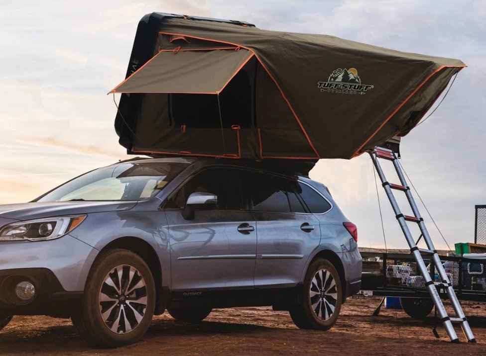

    Yeah, floor looks to be the perfect size.
    I'm not sure I see the real benefit of that over what we've got already though. Both are soft-top tents, so will have all the same pros/cons (wet, wind being the big cons).
    It's also funny that it says "NOTE: The ALPHA II™ tent is designed to open to the passenger side ONLY" and then the photo they show has it opening driver side. LOL.

    I think it is interesting because it is a hard shell that opens up to handle a full size mattress and still has small closed up dimensions. Also, it can handle all the bedding left in it when closed up. I don't see an issue to opening to the passenger side. I've run mine that way before.
    The hard shells that open vertically are small inside and too long for our trucks unless the excess goes over the cab. And then they are too high.

    I don't follow:
    • Closed dimensions are larger than our tents.
    • We can keep bedding in our tents too - I keep two full size pillows, two Queen comforters, and the Exped in my tent at all times.
    • Our tents weigh less.
    • You missed my point about passenger. Read it again ;), and tell me which side this Subby is opening on...
    The only "benefit" I see to this tent is the hard shell means no cover zipper to get dusty and break - but Ben has issues with the no-zipper pop up too, so I don't think it's necessarily better.
    And yeah, I don't think the pop-up style are great either (for the reasons you mentioned). For me, the only thing better than ours is a wedge - largely for wind noise, ability to heat from the bed, and dry storage of the bed. Even then, only GFC (so far) is really better. But, as you mention, it has the drawback of being high/over the cab.

    GFC id $6800, This is less that a 1/3 of the cost of a GFC. Apples to Oranges. That is another definition of insanity. Buying one of these and expecting it to be what a GFC is.
    Yes, it is heavier than what we have now. Closed dimensions are hardly larger. 60x50 compared to 56x48.
    I am unable to keep all of my bedding in my tent.

    You really are focusing on the periphery of my posts tonight Mike. :) You just trying to be disagreeable?
    90% of my post was comparing it to our existing tents, and making fun of their photo that contradicts the text. I stand by the "I don't see how this one is any better."

    Got the lcas on tonight as well. What a bitch..And steering rack back on with new bushings. Looking good now. Home stretch

    Great to hear! Just muscled them in? Figure out what the problem was?

    And beat the hell out of the mounts to get the straight. Weirdly though once I put them on and torqued shit down..they went crooked again..so..yay.
