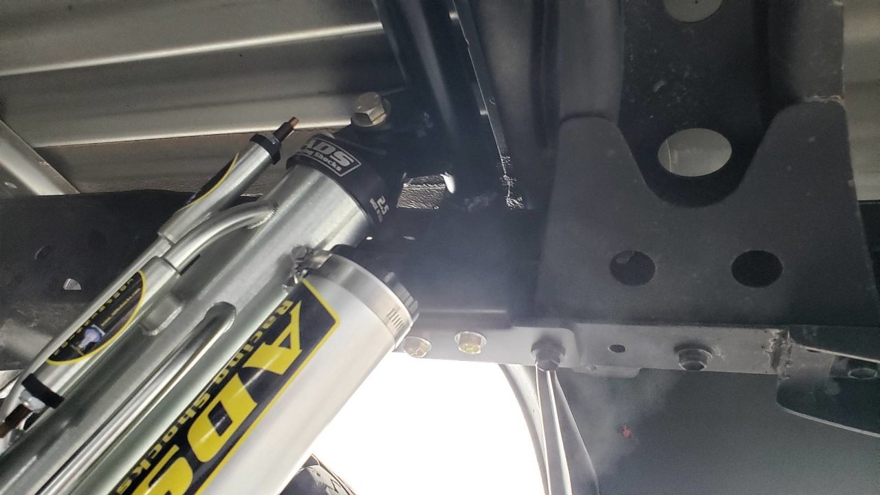

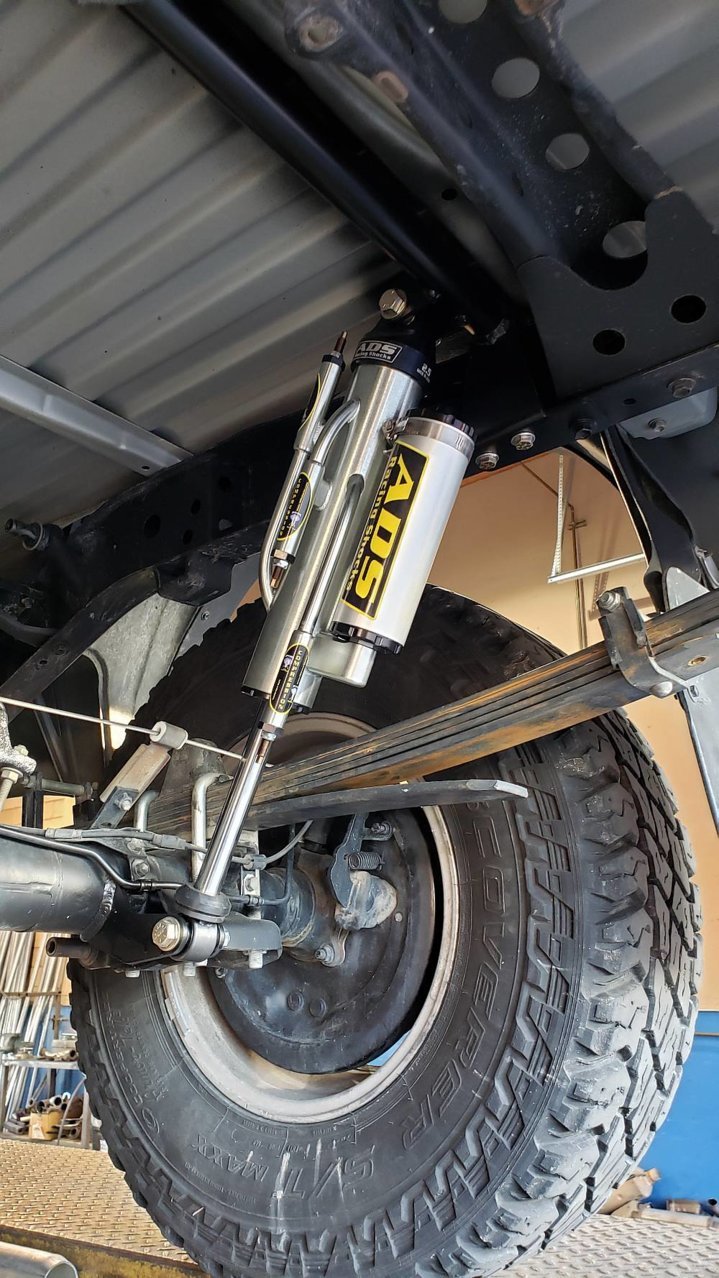

    I don't do instagram so I can't see what you guys do. Are these the images on there?
    These pics were sent to be by Matt last January when I was talking to him about rear shocks. This is the kit he was developing for our trucks at that time.
    FWIW, the shock pictured is a 10" stroke, 25" extended, 15" compressed and is exactly what I have.

    Yep, that's it. So it looks like the bottoms are still weld-on like we've all done. I guess having the top be bolt on, still makes it slightly easier...

    That's a good point. From what is shown in the pic, it looks to me like the MCM kit has the shocks angles more than mine are and certainly more than yours are.
