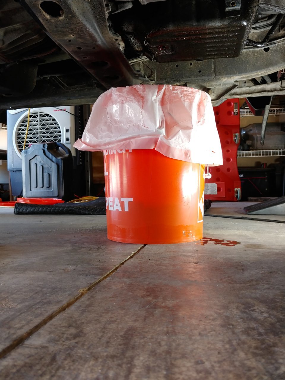

    That's a lot of ATF, I thought it was a typo when the FSM said the pan held up to 9 quarts.

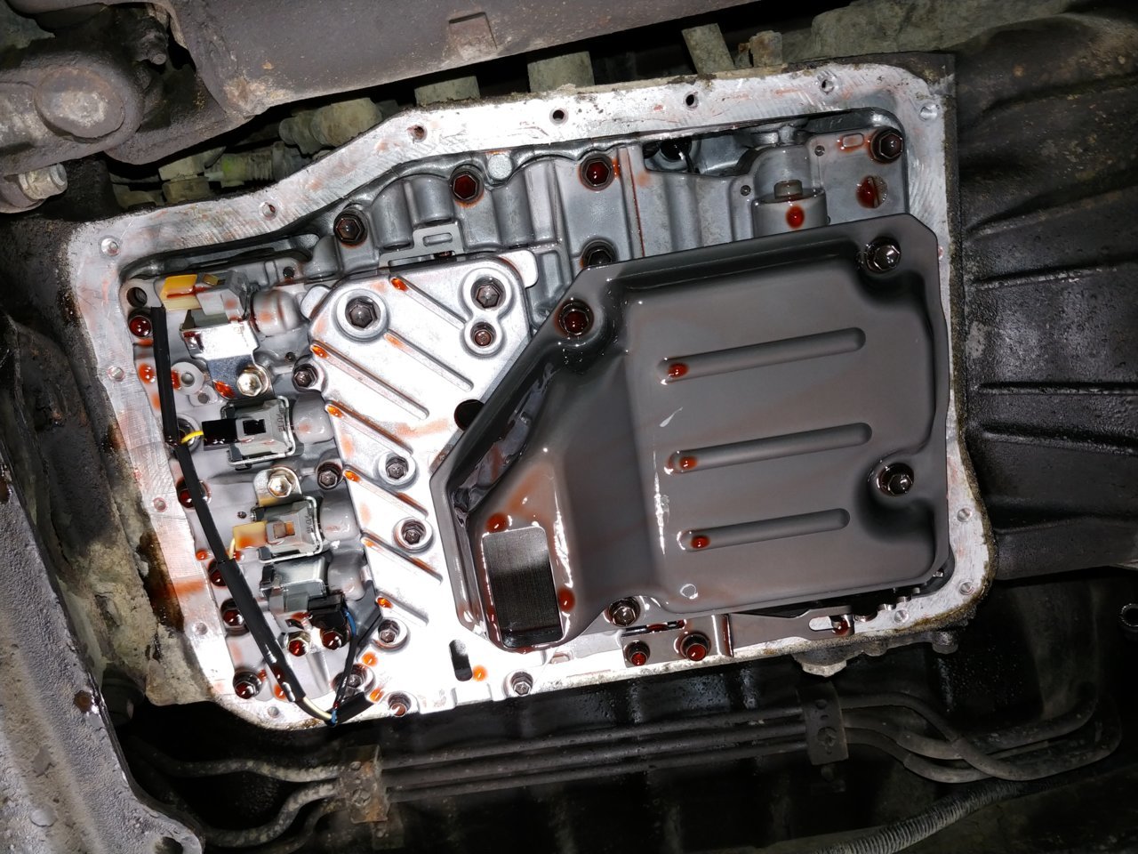

    Looking bueno so far, can see my four solenoids that are gonna get changed on the left.

    Why changing them out? Upgrade?

    Nah, one of my shift solenoids is sticking and the other is high impedance. I figure since I have to drop the pan to change them I'd do the timing solenoid and the lockup one as well.

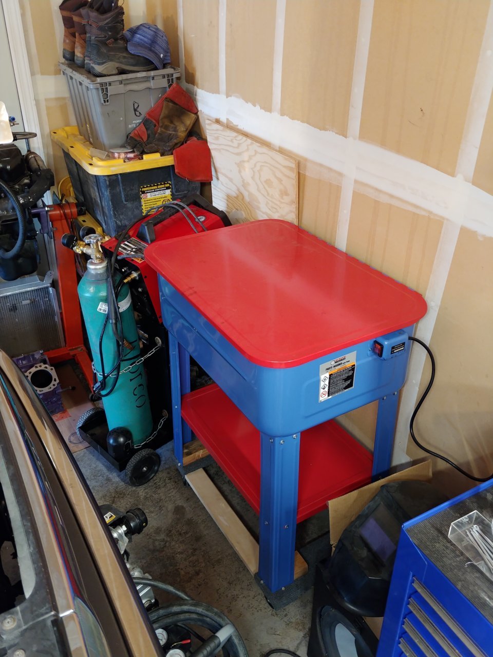

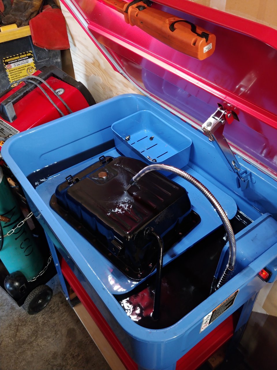

    you bought a parts washer? nice

    Yeah, the cruiser is getting a piece by piece restoration of the drivetrain. Taking care of every leak and the little things the PO fixed oddly or neglected. I figured a parts washer would help, I wash lots of parts and got tired doing it on the ground on a metal pan. I got this thingy and put it on a furniture mover filled with 10 gals of mineral spirits.

    very cool! Would love that myself. Some day i'll have a garage big enough

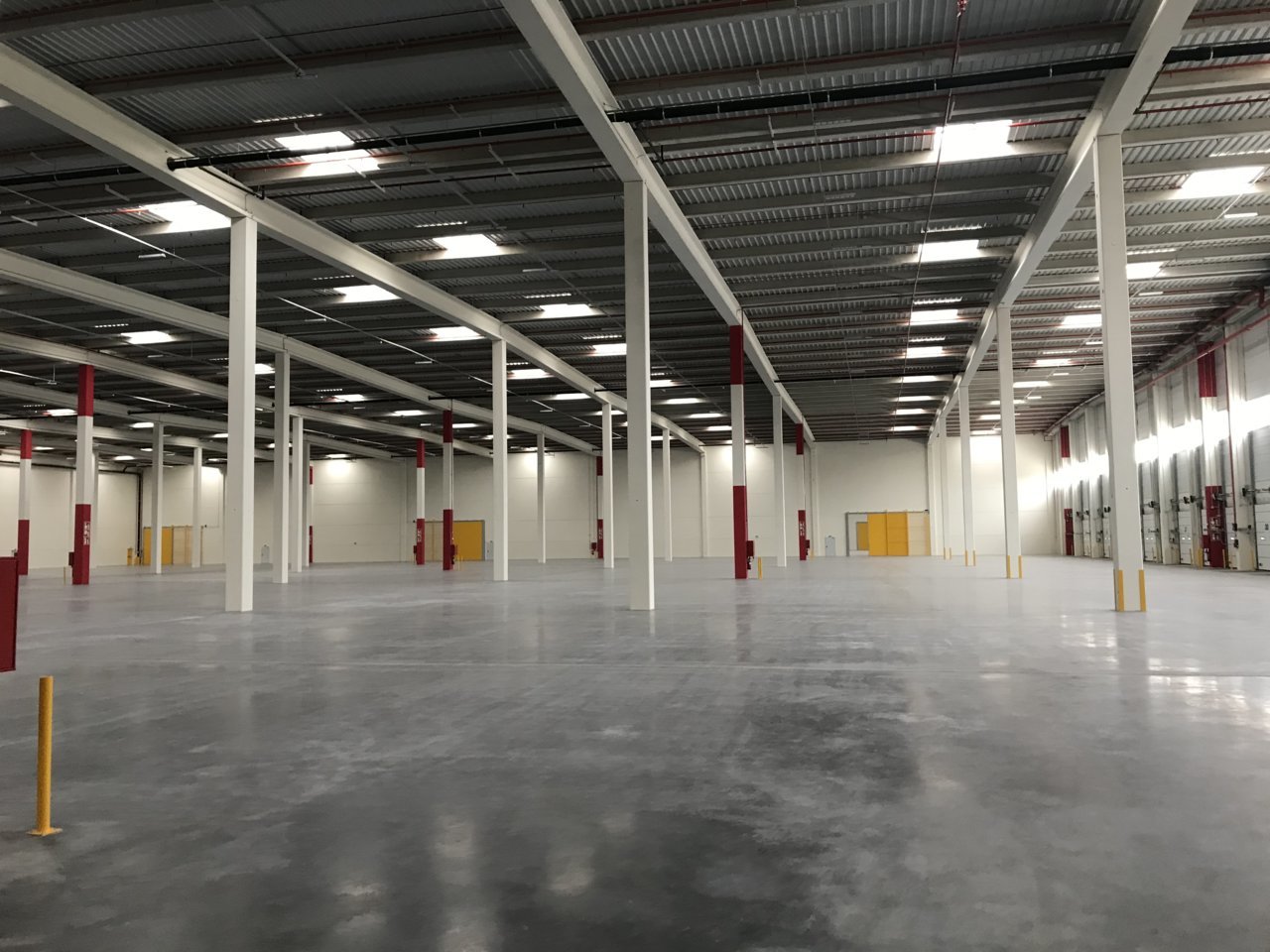

    A converted ice rink should be big enough...

    Plenty of room in those before all the crap goes in

    BOI2, that design can ship one million units per day. $150M just for the robots and automation equipment, let alone the land and building itself.
