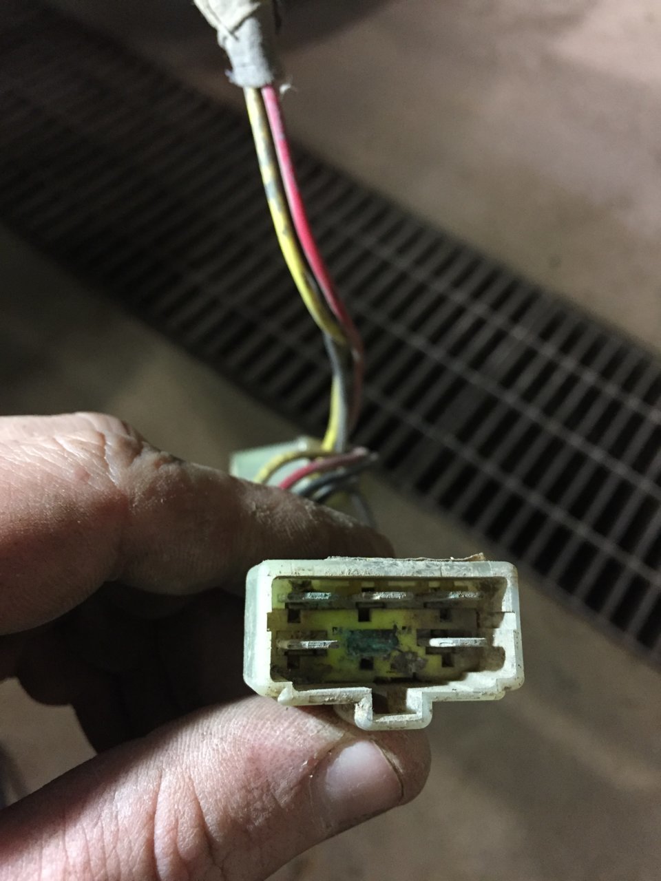

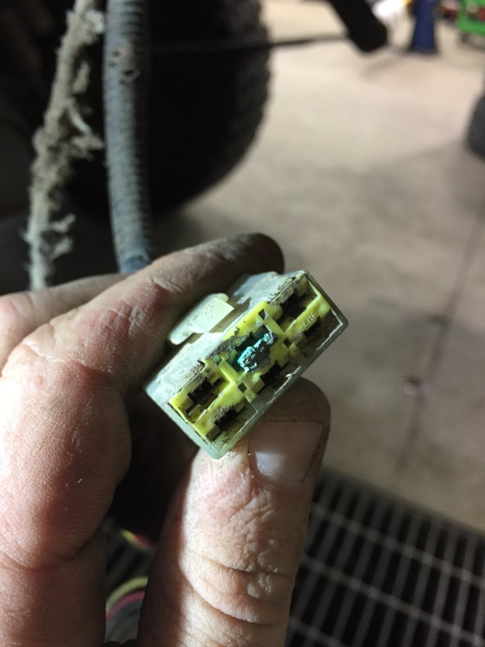

    Well I found my tail light wiring issue. The plugs (green tail light wire specifically) is a corroded mess. The extra harnesses are the trailer light plugs.
    Trying to figure out the best way to replace/fix all these corroded connectors

    I'd bet the pins and connectors are still available so could just cut the connector off and install the new. Or if you don't care on keeping it oem, could swap to like a duetsch connector.

    Dealer sells repair pins and pigtails and you can get new connectors
    wee bit pricey. But other option is junkyard.

    I’m just going to buy some waterproof 6 pin connectors and splice them in to replace all the old shitty ones

    Actually, I probably do need a couple sets of m/f connectors and pins. Then I could just reuse the same harness. How much is a couple of those
