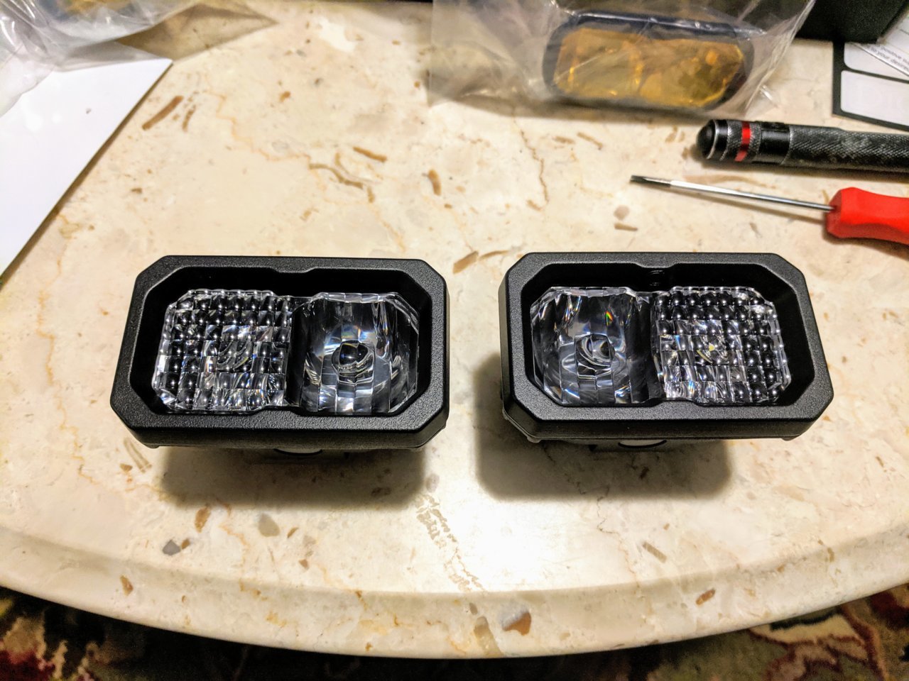

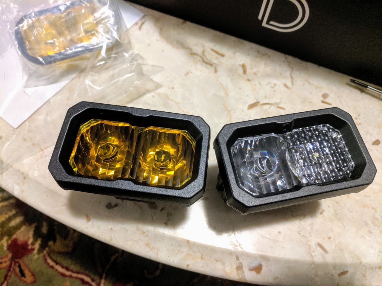

    Got my 2nd pair of c2s in and swapped the lenses.
    Looking forward to getting everything wired up and installed.

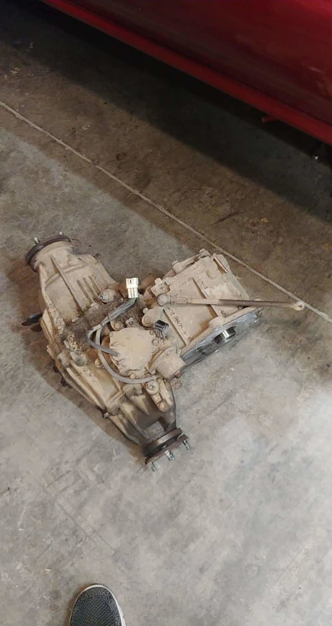

    Oops, this fell out

    Cruiser? Whatcha doing?

    Yeah, came outta the cruiser. Front output shaft seal started puking hardcore and on a cruiser the flanges are actually shafts that you press out of not 1, not 2, but three bearings after removing the extension housings. So since I have to remove the case and pry the extension housing off and press the shafts out anyway, I'm just gonna do the bearings too. Doing the trans output seal, case input seal, and rear output seal and bearings too since I'm already in there. It's a pain to remove this thing and it weighs a ton. Thought about doing the underdrive hi range gearset too since it would effectively make my 4.10s into 4.51s which would be nice. But it's proving hard to get a vendor to sell me a set. I guess wherever the gears are being hobbed is impacted heavily by covid.

    Excessively overbuilt, the land cruiser motto. That's my kind of engineering.
    It's got enough cooling capacity to run an underdrive gear set at highway speeds?

    The consensus is that yes it does, it's a 10% underdrive so fairly modest. The case is all aluminum and finned on the underside, holds a good deal of fluid as well compared to a taco case. I would wager that decreasing the OCI is important though and that GL5 for high pressure is more of a necessity since they're just regular helical cut gears and not a planetary setup.
    And yes it is overbuilt, the upside is I rarely have to fix anything. The downside, when I do it's fairly involved haha
