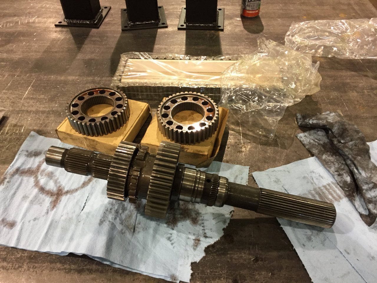

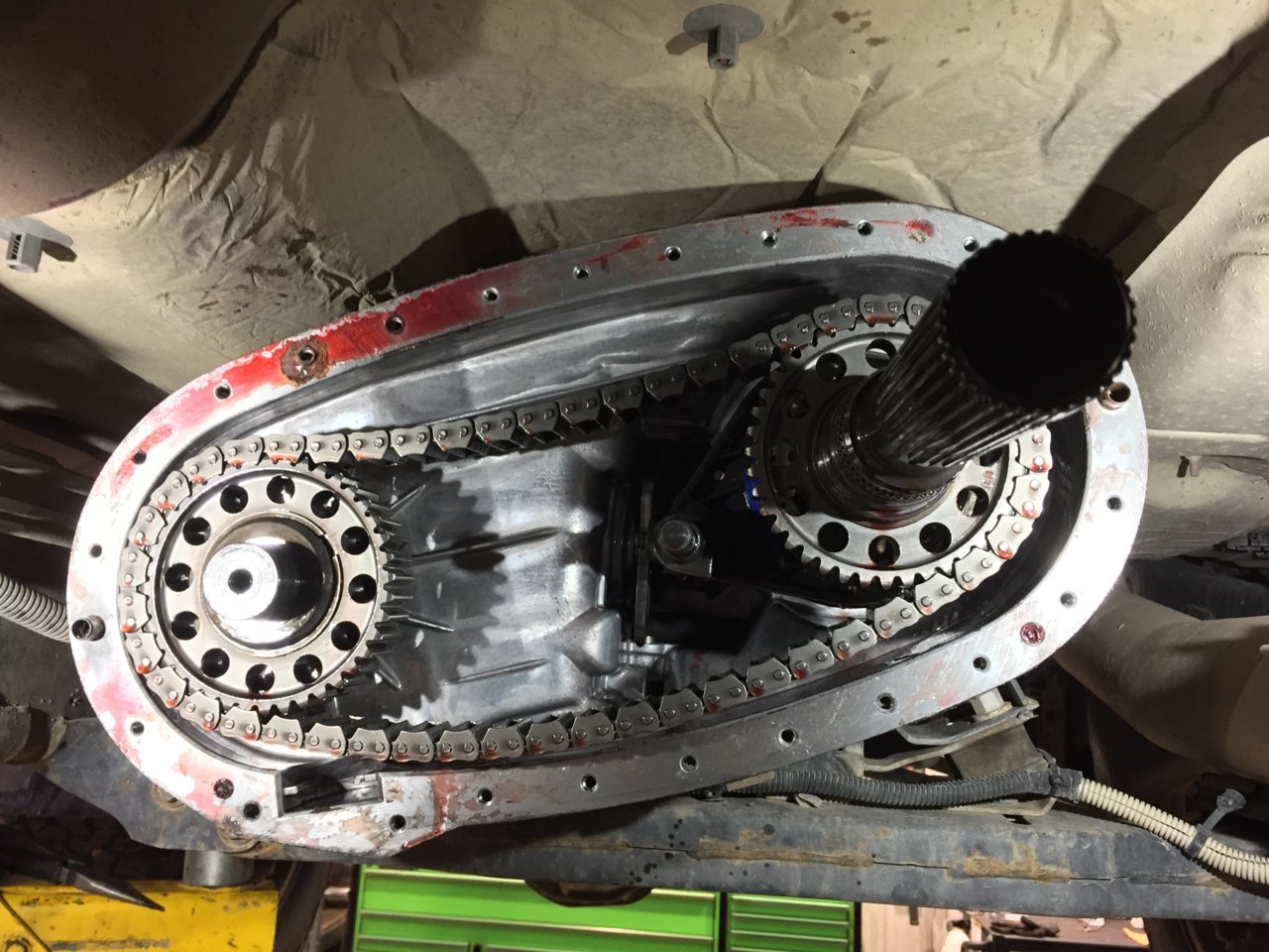

    Got the tail lights in the Tacoma working, wired in some new harnesses.

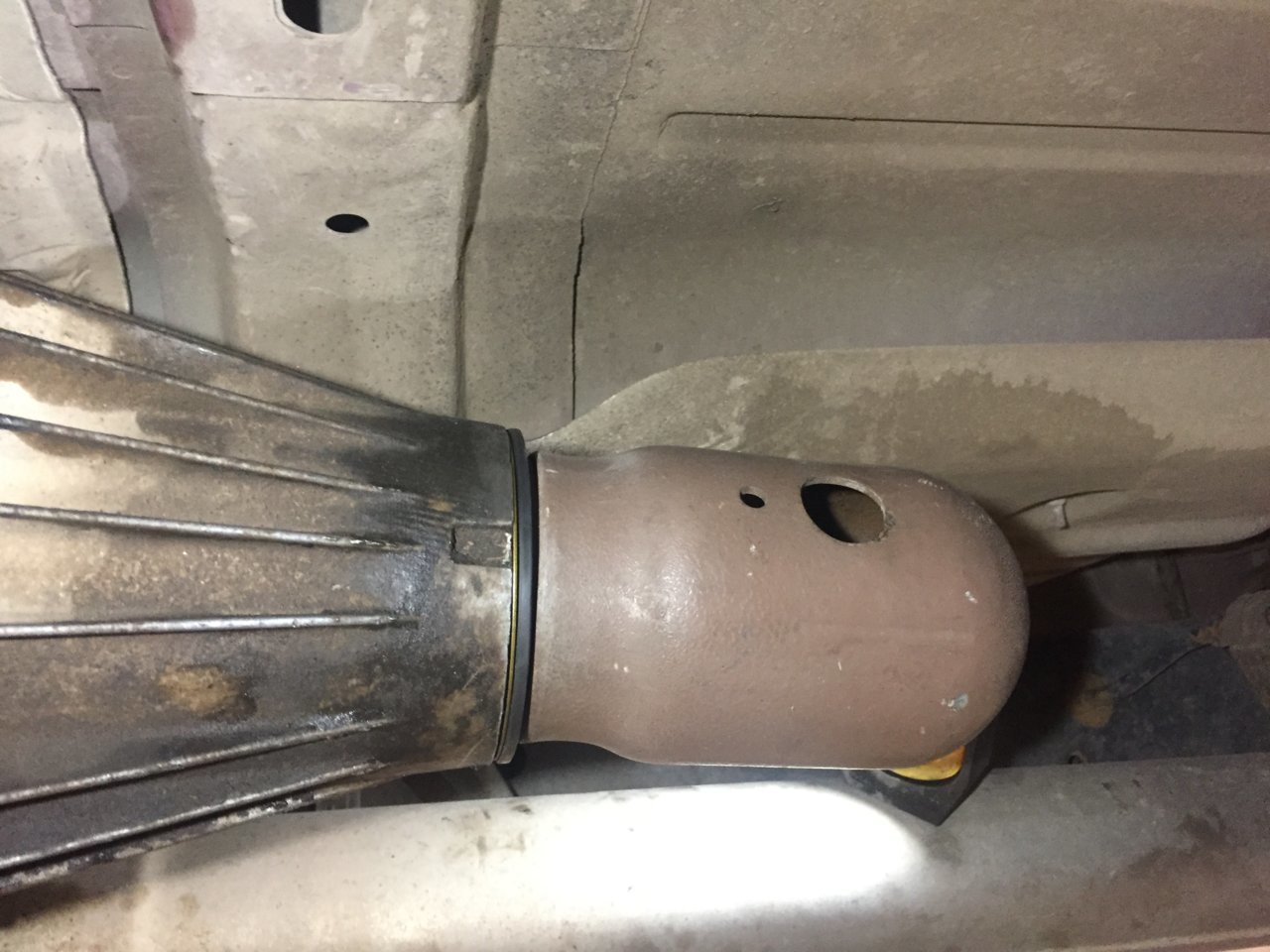

    Replaced the chain in the dodge t case. That bitch was floppy. No more horrendous banging in 4wd. Also found out that the cap for a welding bottle makes a great seal driver for the rear shaft seal. Also found out that if you smash your hand with a dead blow against a transfer case...it fucking hurts.

    Was the banging noise from when it would slip?

    ya. in 4hi or lo (way more pronounced in 4lo) it would jump the teeth on the cogs and cause the front drive shaft to also jump. It was stretched enough it was slapping the bottom of the case and gouging it. Only cost me a sunday and $163 in parts. Was a pretty fun job honestly
