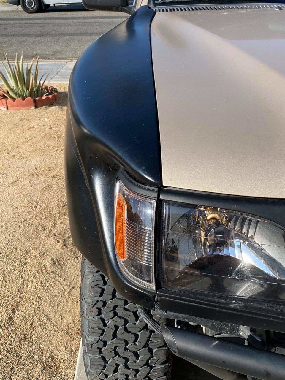

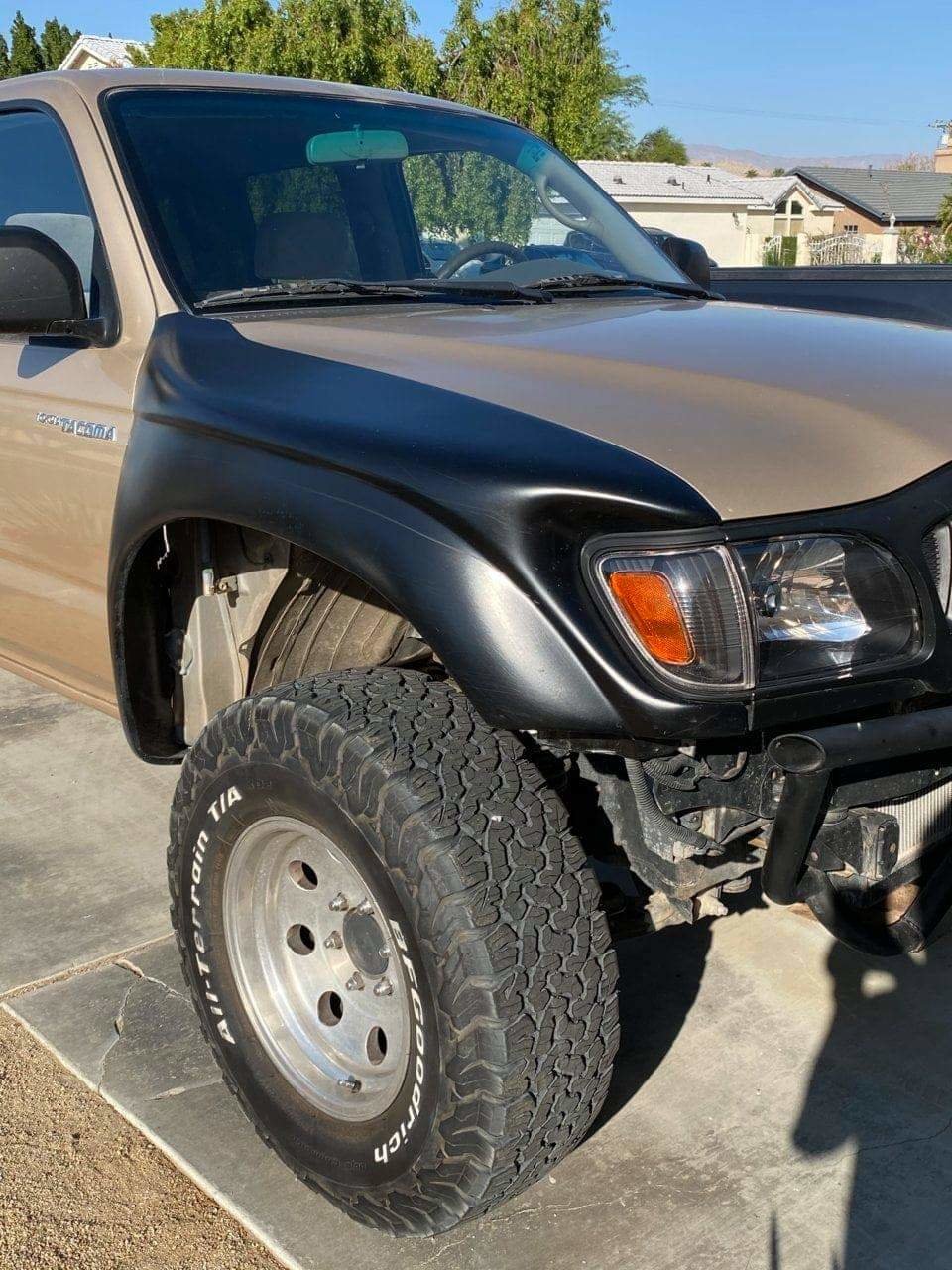

    @Blackdawg and @anyoneelsewhomighthaveadamnclue
    Is there any reason a fiberglass fender set that says 03-04 Tacoma wouldn't fit early 1st Gen like mine?

    I think you'd have to drill holes to mount it. Other than that, I can't see a reason why not.
    Edit: NVM. I was thinking flare not fender.
    Speedytech7[QUOTED] likes this.

    What strikes me as odd is it says specifically for 03-04, as if that any different from the 01-02. Every other fiberglass maker just lumps 95-04 into one fender set. I thought the only difference that might occur for me would be the side marker attachment.

    What brand is that?
    They are the same. The only difference really is the way the mirrors mount. Which shouldn't be an issue for you.

    Hanneman
    They're the size and look I'm after, not easy to come by.
