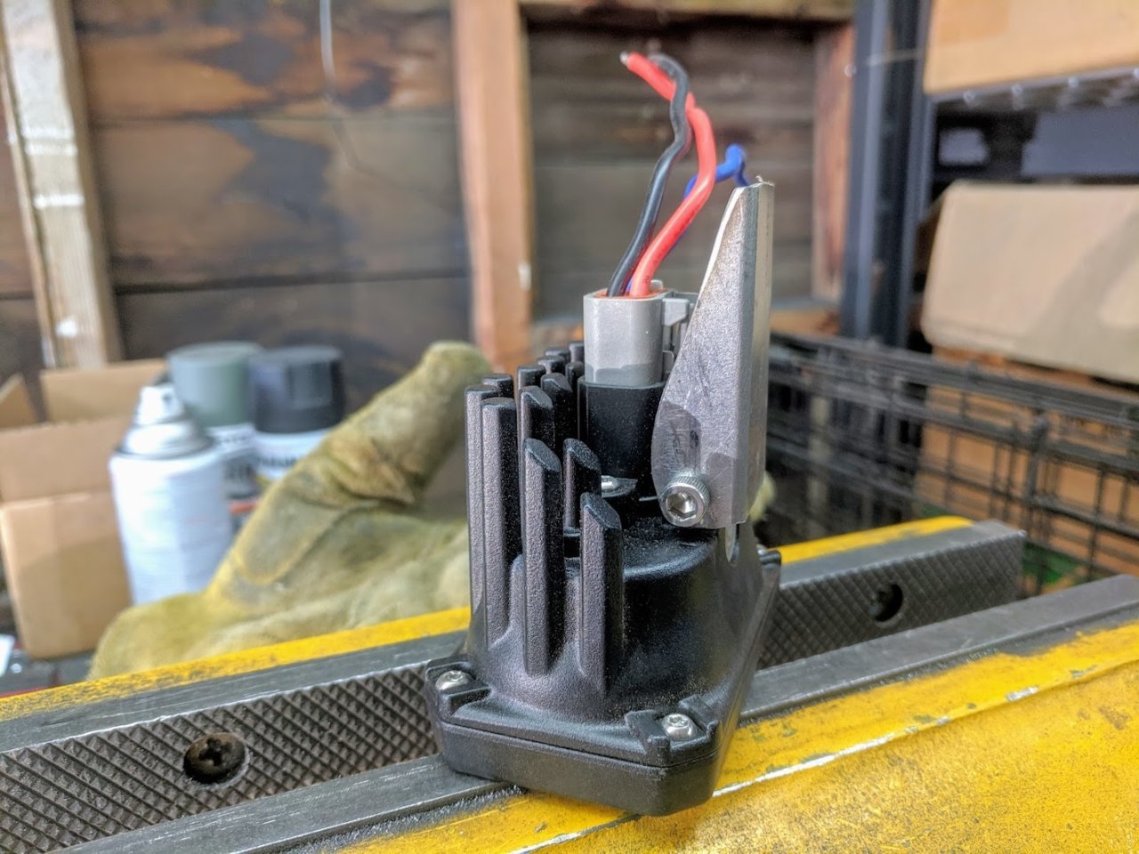

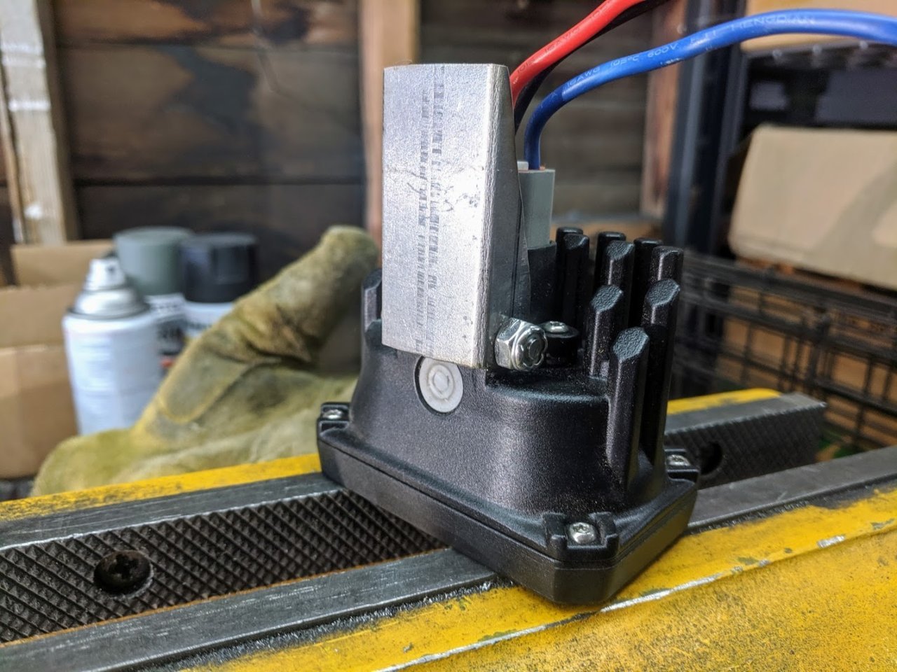

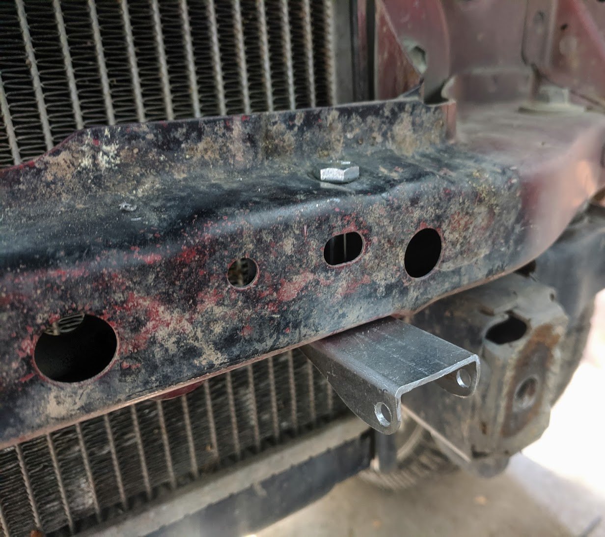

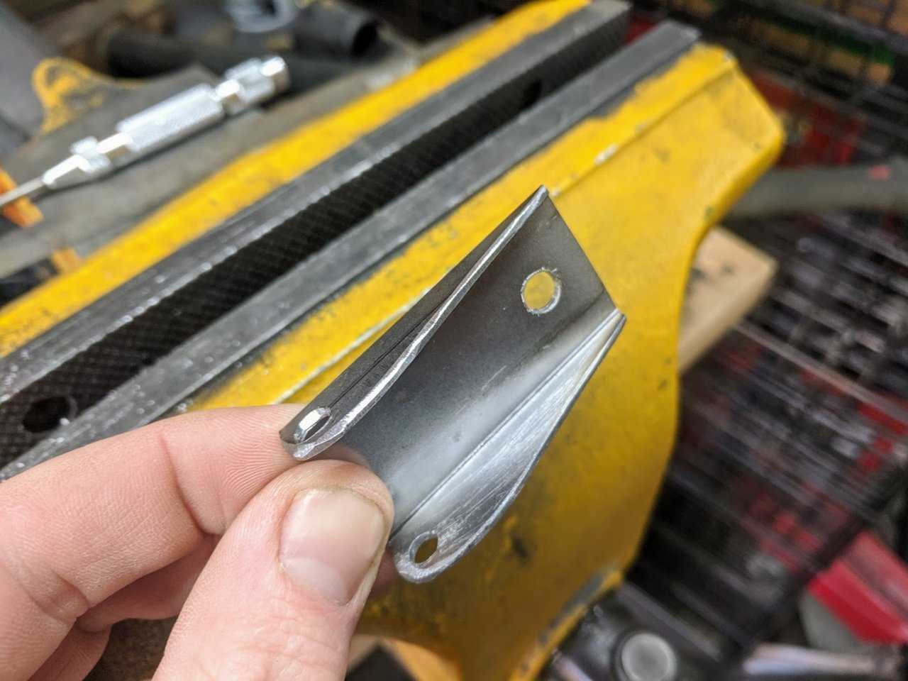

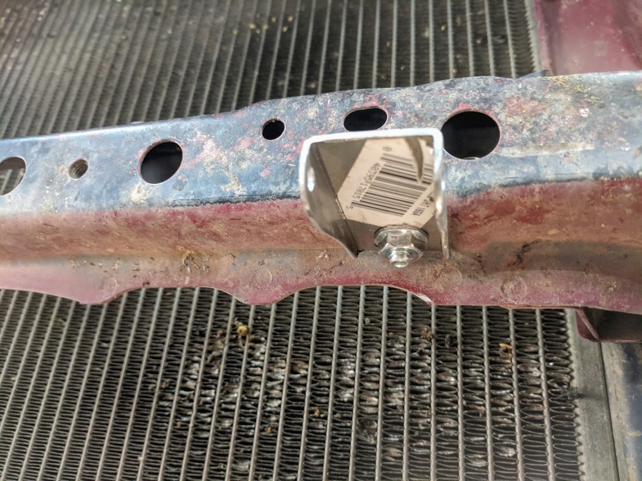

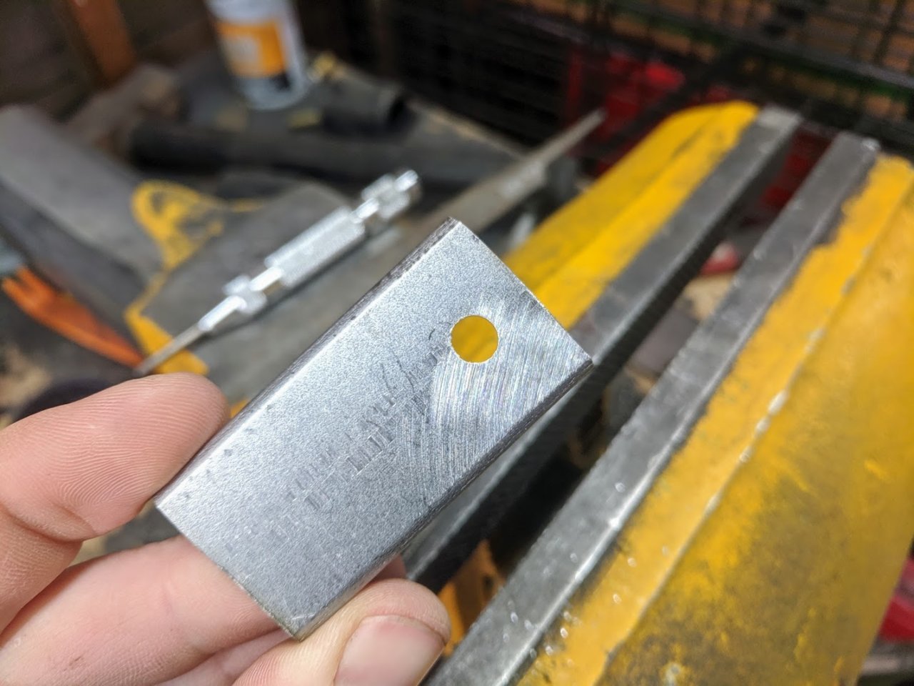

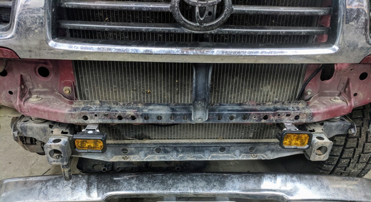

    Made the mounts for my fog lights.

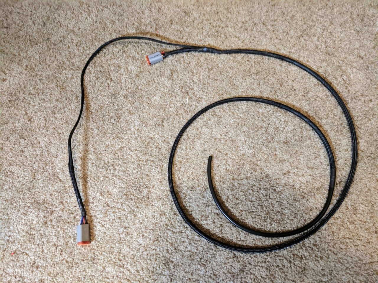

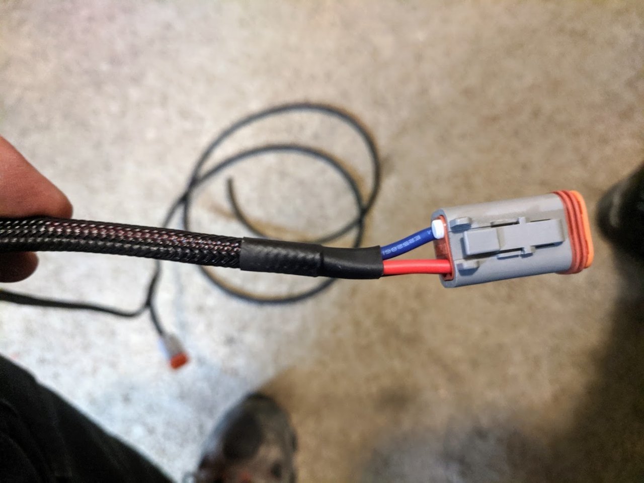

    And built the harness. uses 4 strand wire so I can have the back lights on for marker lights plus use them for blinkers.

    No 100% sure how I'm going to get them mounted. Clearance is perfect with the bumper...to perfect. Not totally sure how Im going to get the bolts through the lights with the bumper on as the lights don't fit through the bumper when they are left mounted up..
    Should be interesting.
