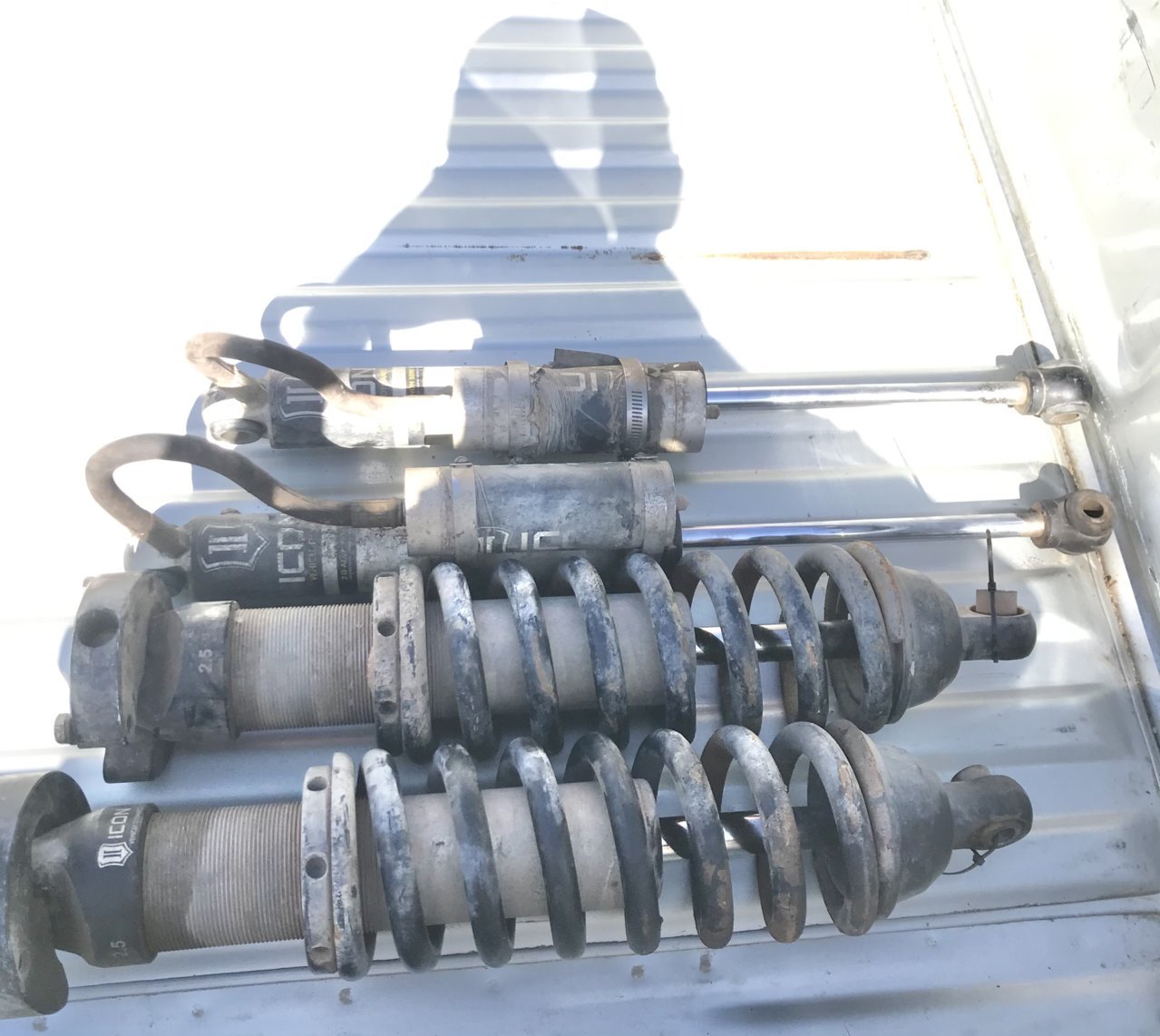

    Thats such a weird statement to make. Who cares if the oil and gas have mixed. All that means is the seal on the piston has failed. Which is literally the same work for rebuilding anyways so how would it add more labor?

    Something about not being able to just let the nitrogen out of the port. Having to use some fancy tool, adding some time.

    Hmmm i mean your rears are just a schrader valve. Front are the funky needle fill. Rears just release through the schrader. Fronts could use the needle fill tool but since that gets removed anyways just use a socket and slowly let the pressure out.
    But Im sure he knows more than me since Ive only done a few lol.
    It is surprisingly simple to just do a basic rebuild. Or more just a seal/o-ring/wear band swap. Hardest part is really just having a way to get springs off and a way to fill with nitrogen. Once you start tuning them it gets to a whole different level

    Randomly popped in here and had to mention that if you have a gas reservoir shock and the gas gets into the shock side you have to pull more stuff apart to get the job done because the shock gets pressurized and there's no air to let out of the shraeder. I've had to deal with it on mine before, not the most fun and messy
