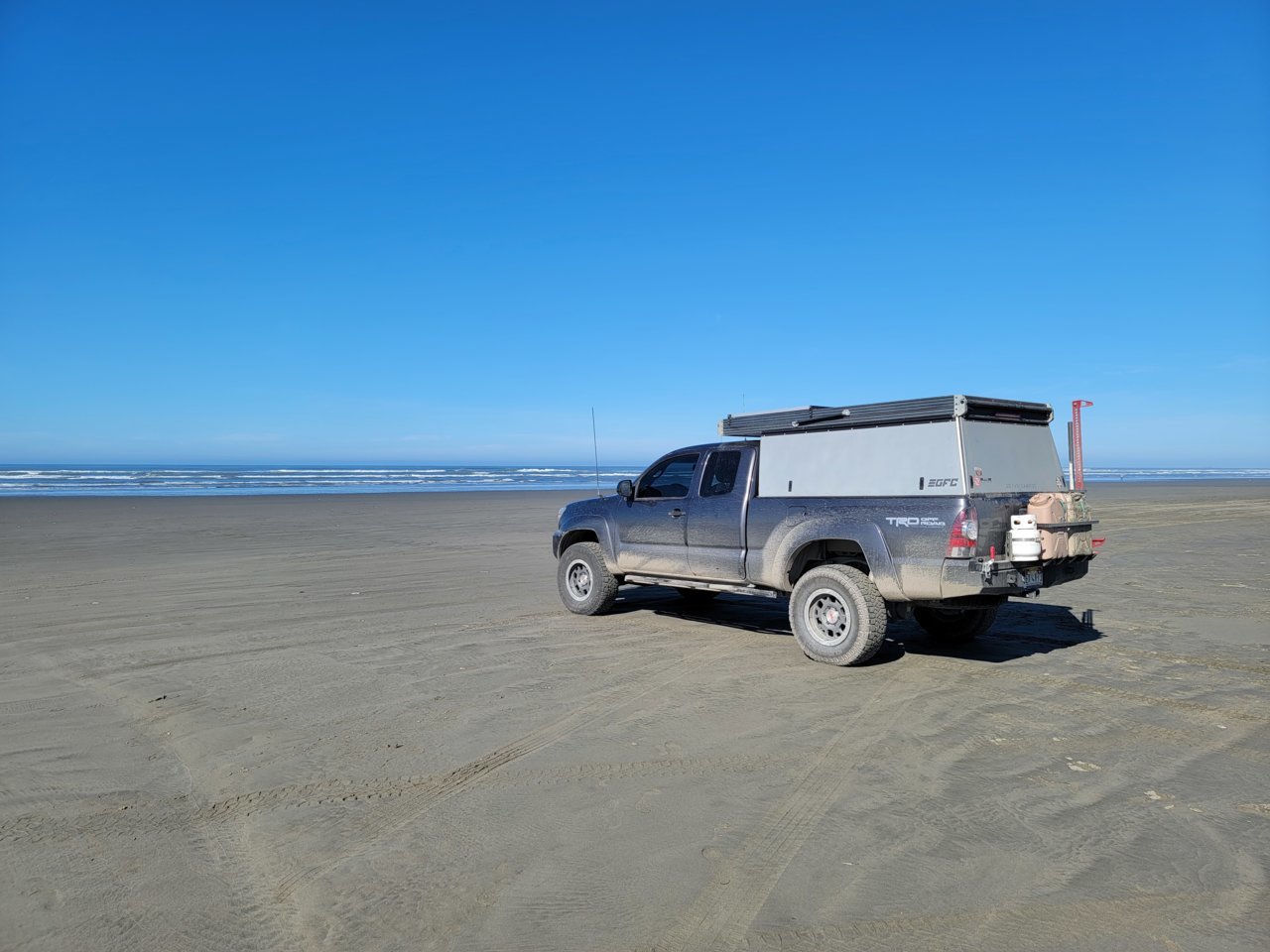

    No go for Canada at the moment. Need to be back home in a week unfortunately. Hence the quick tour trying to see a little bit of everything up here.
    Made some touristy stops yesterday, drove on the beach this morning. Heading back to the mountains now.

    Wow, you lucked out on the weather. It is not like that very much.
