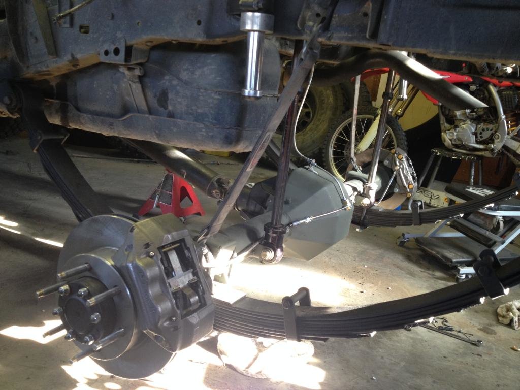

    This is a 2nd gen, but still:
    LC Diff with a Detroit Locker, Diamond housing, 35 spline axles, disc brakes. Cost 4700 buck a roos

    Those 4 pot rear brakes are like the size of the taco stock fronts haha

    Lol i know. Freakin huge
